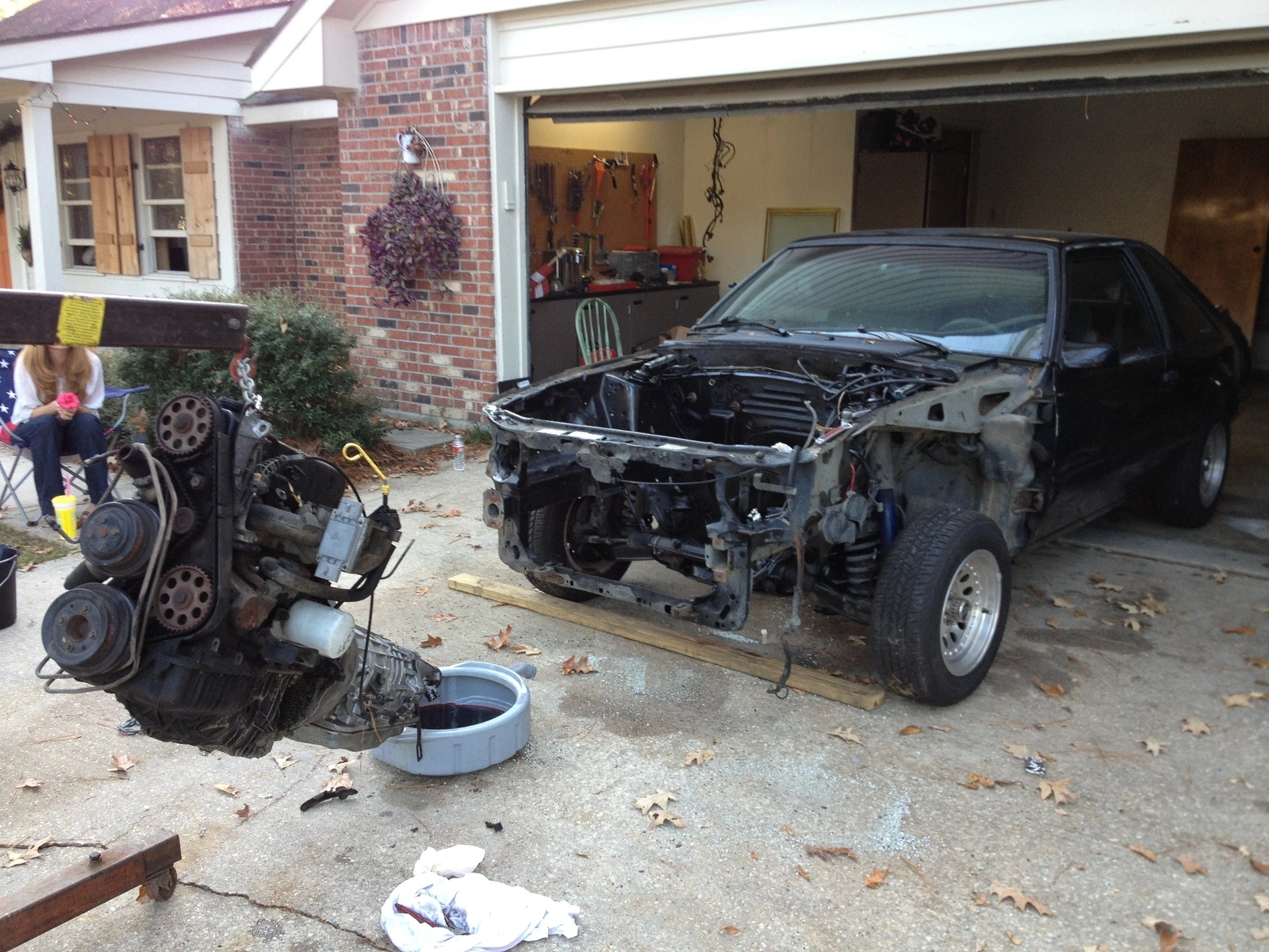

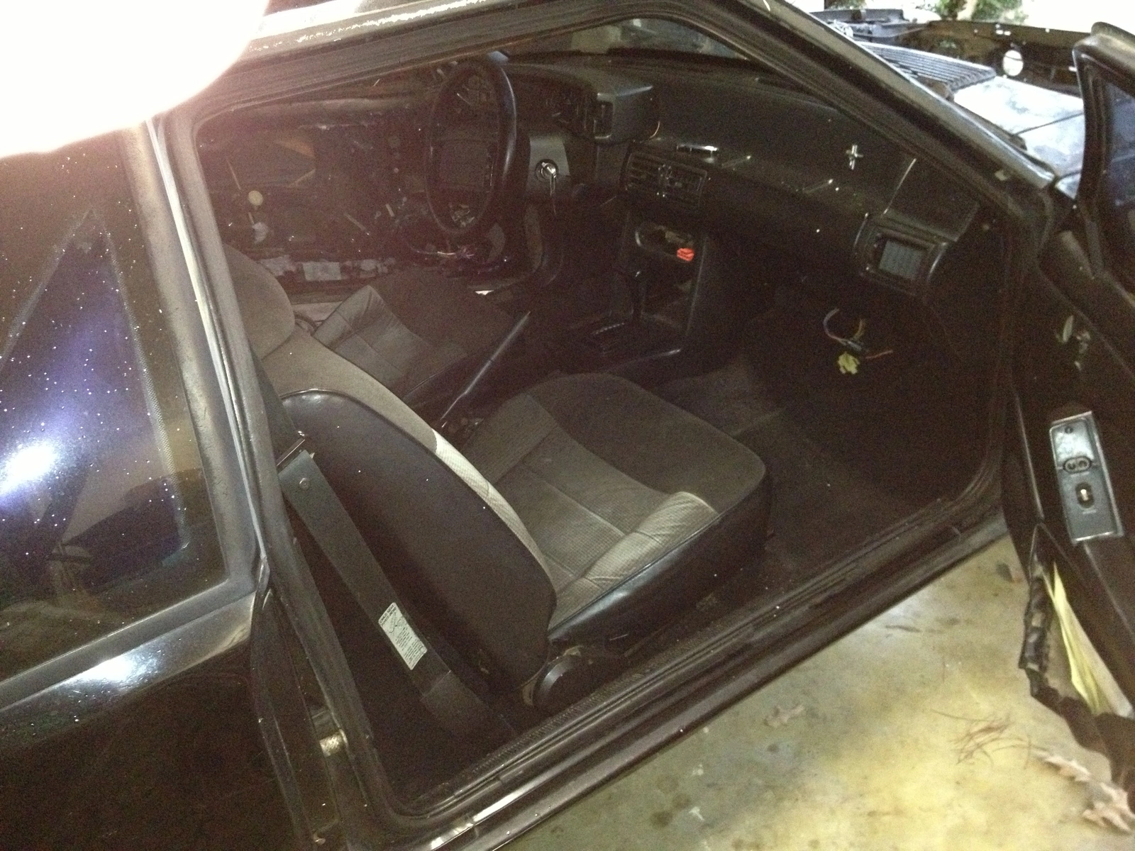

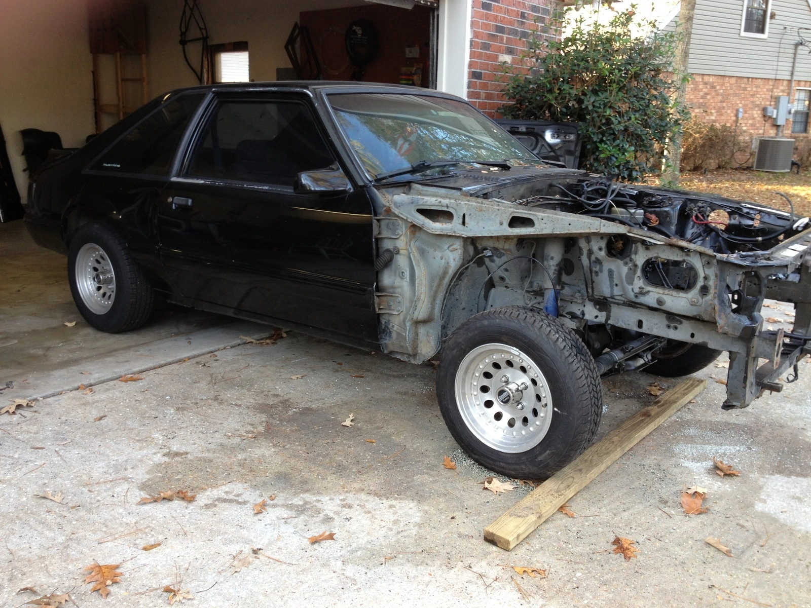

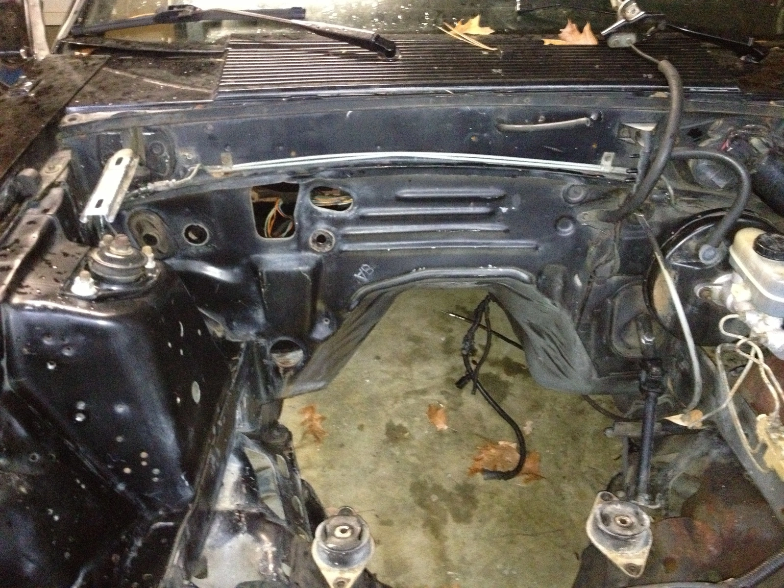

    Ok......Well this is our first conversion from 4 Banger to V8. I picked this 92 LX up that had two dented front fenders and a cut front bumper cover for 600 smackaroos. It had a running 4 and a rebuilt auto tranny. It also has full interior in Black and power windows and locks that I will be replacing with a good ole manual set up. We recentley pulled the engine and tranny out, removed all the non essentialssuch as the wiring harness, AC, and heater box. No need for the computer because it will be a carb set up. If anyone has any helpful ideas please send them my way. Its not our first Mustang but it is our first conversion. IMG_0192.JPG

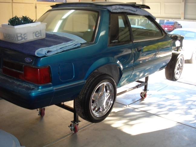

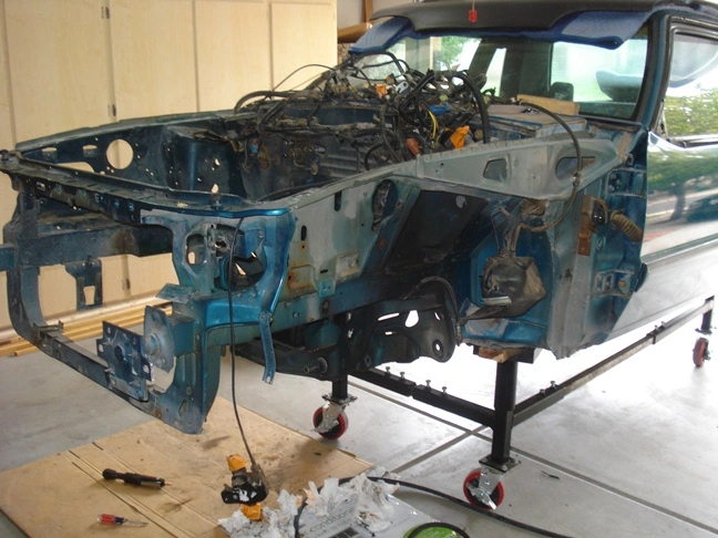

    some photos of progress

    Looking good. Keep focused and plan correctly.
    I have come across people with the same opinions that say buy an original 5.0. My view on that is that I dont want some ones old beat on 5.0. I owned a 5.0 before and lets be honest, I beat the crap out of that car.And my plan was to change out k member and all the running gear anyway. So why buy some ones bent up, torn torque box, run into the ground mustang. The 4 banger isnt beat on.
    The wiring isnt a problem at all for me, but body work is a challenge for me. Im an engineer by trade a have a long history of working with all sorts of engines, gear boxes and so on. I will be learning how to do body work on this project while taking some much needed pointers from my neighbor who did his own body work on his 1970 Cuda.
    Engine plans are to convert my 351w into a 408 with all forged internals. We should be around 545 H.P. on pump gas straight motor. And behind that will be a C4, stall and brake set up. Hoping for around 10.60 track times once dialed in.

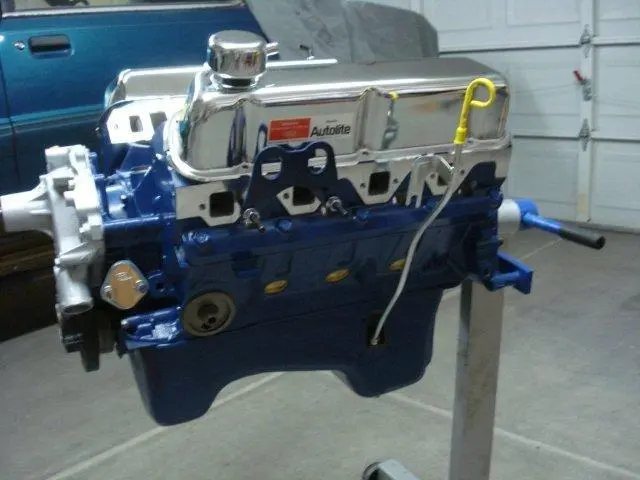

    That's awesome .....funny I worked at a body shop when I was a kid ....that's the one part I'm looking forward to / why I actually even started this project - .....bought a 80 gal compressor ( had an electrican rewire the garage for it) - ......I owned maybe 7 5.0's when I was a kid in the late ninties....my first was 93 gt w/12k on it .....body work is easy - it's all in the prep ....patience...patience...once you do a panel ....and it looks like 'glass' then it's done......you should develop a 'touch' for it.....practice on some fenders ....if you can 'shoot' a nice fender - your on your way......I plan on edging out all the panels w/color / clear/ assembling the car as a roller - then 'rent' a booth ...and if my touch with the gun is back up to 'speed' then I'll shoot it myself .....if not then I'll have an experienced painter shoot it for final .....I'm planning a white base color coat - then a minty metallic light green top - etc .......I agree with going 4 cyl's - the 5.0's around here were all beat to chit......my 4cyl had all the vin tags in place - and only had 79k on it when I bought it .....stay in touch .....I'm going to be asking you alot of Q's if you don't mind when it comes to figuring out how to wire this thing / linkages etc ....going 1970's with the motor - here's how it sits now

    That really looks good. My block is on the stand and completely bare. I just pulled it apart and went through it. I still need to send it off to the machine shop for its initial cleaning and machining. But that part is going to be last on my list. I am going to concentrate most of my attention on the car itself. Soon as I get back home from New York I will be cutting out the old aprons and welding in some new smooth aprons that I purchased from fox body restoration. Then I will be welding up holes and smoothing out the rest of the engine compartment. If you have any questions feel free to ask and I will help you out as much as I can.

    Thanks for helping me.....your right where I'm at - but I decided to take the front suspension off as well - what I'm doing......once I get the wiring figured out / taking out ...is making small templates for the larger holes with cardboard so they 'fit' almost exactly in the holes to be welded up(1/16th) .....then a steel contractor is cutting them out on CNC machine - and he's sending one of 'his' guys to weld them in....I don't have a welder ....and I'm hoping he can 'plug' the smaller one's ....and then that's when the real fun starts .....smoothing the enigne compartment out .....are you taking out the brake booster as well?

    I am going to remove the master cylinder and proportioning valve and replace with sn/95 set up. Welding up the holes will take a bit of time. I was told the way to do it was to use a copper spoon on the back side as you weld up the holes. The welding does not stick to the copper and allows you to make a nice clean fill. The only problem is that it takes two people.
    I will be going with a upr k member but I can't remove the old one yet because the attic door is right above the car and my wife is in and out of the attic getting winter clothes and Christmas ornaments. So with that being said the car needs to be mobile. I plan to wheel the old one out and wheel the new one in all in one day to keep it mobile bit not until the engine bay is complete.
