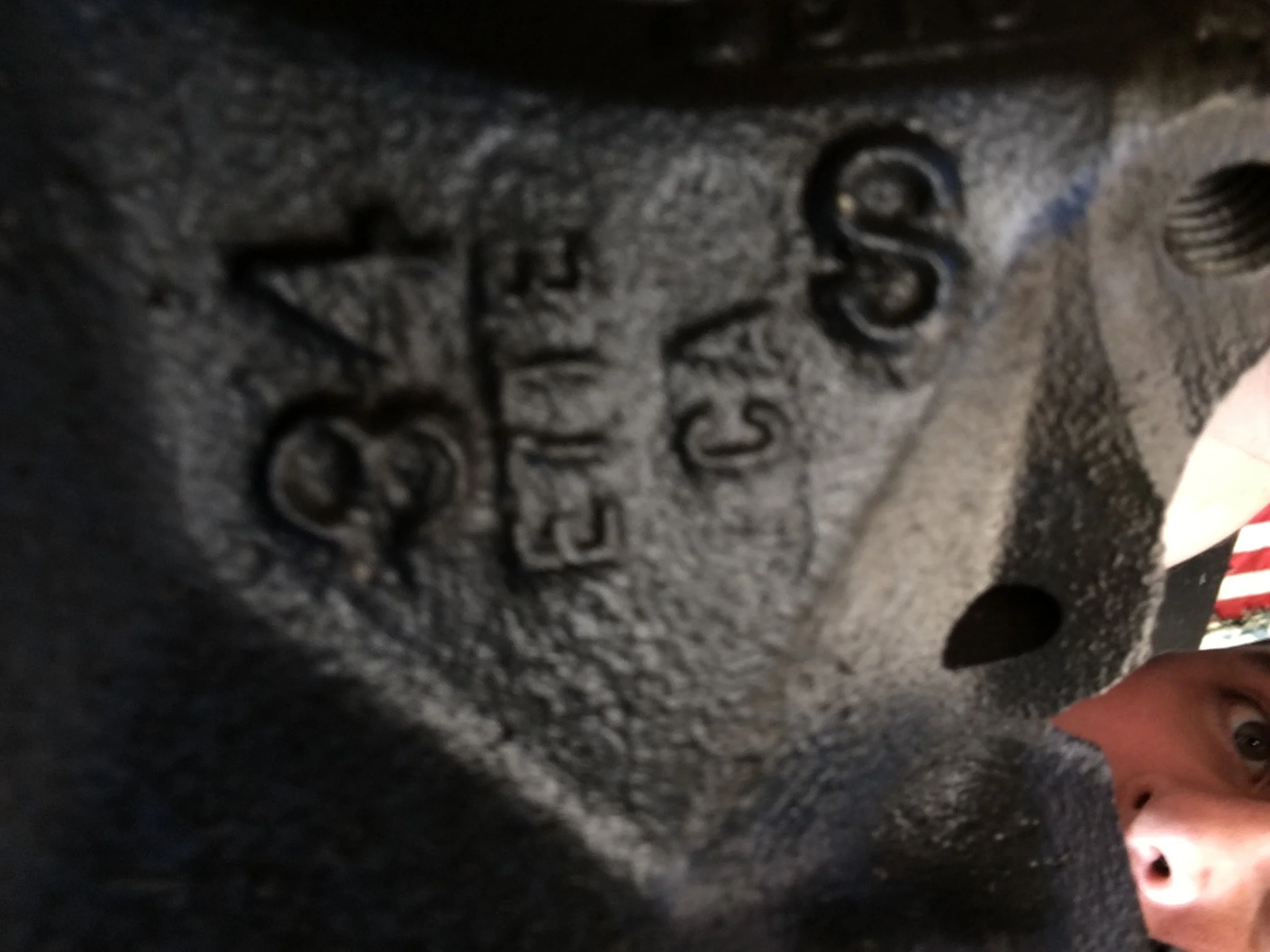

Yeah, sorry to tell ya, but you've got nothing special there. Those are 351W truck heads. The only difference between the 302/351W heads is the 351W heads are drilled for 1/2" head bolts. They provide zero performance improvement over your stock heads.
Like a91what said,if you're looking for a performance boost on a budget, look for Asher of 5.0 Explorer heads and intake.
