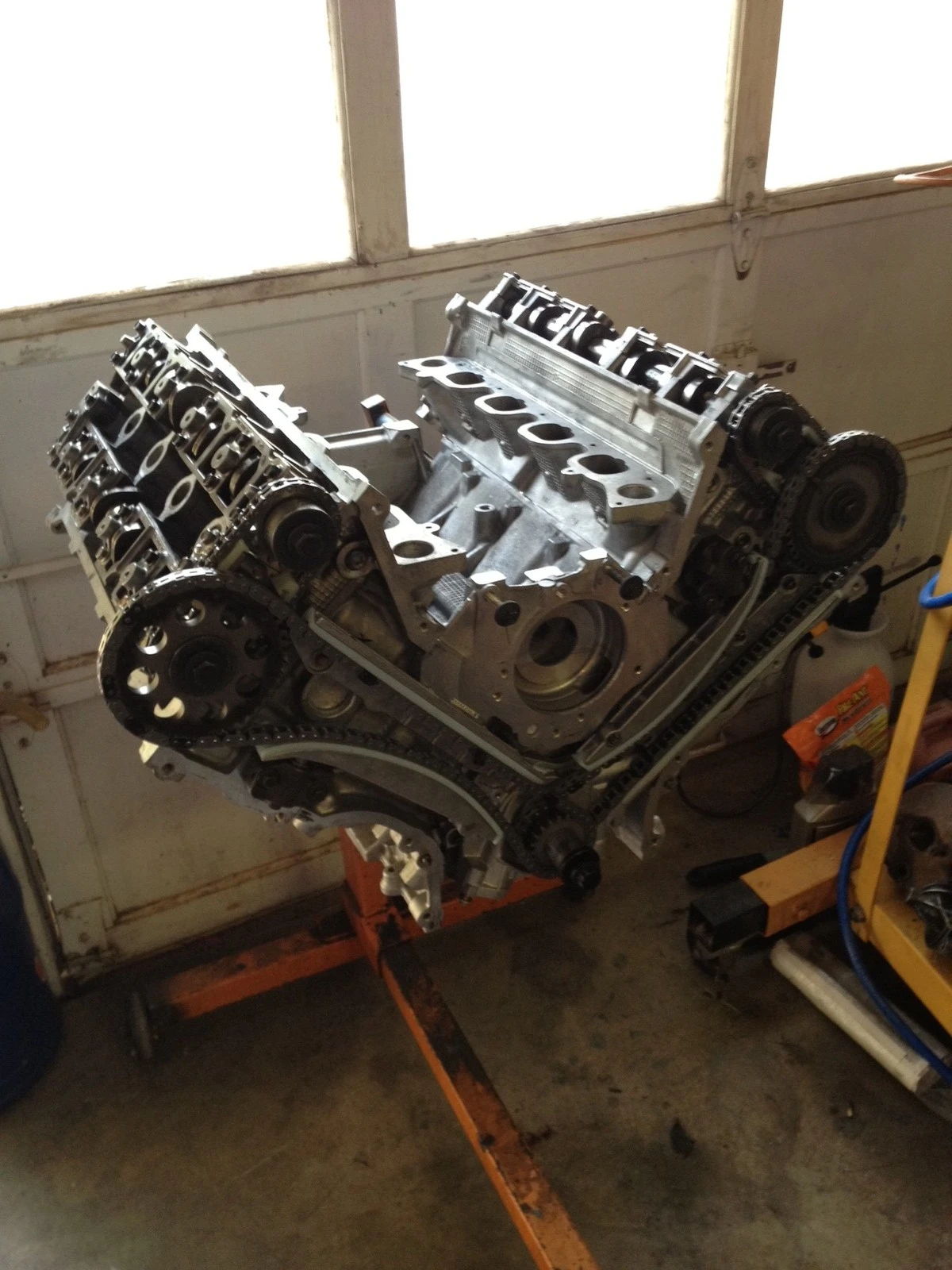

  1. Well, yes and no...I have the long block ready for degreeing, but I have an ever-growing honey do list. I also discovered the B cams I bought...well, one of them wasn't a B cam, so I'm trying to get that issue rectified before I continue. I can degree one side, but not the other :( Bought a stock shifter just to get things going, and I've read quite a few bad things about the B&M Hammer shifter...guess it has issues over shifting or not working correctly at all...not the kinda problems I wanna mess with.
    Didn't realize it had been so long since I'd posted. Sorry folks...no car **** as of right now.
  2. Jeff was that the "tightness" issue?
  3. No, the tightness issue has been resolved...just needed more lube :D
    However, I ran into another snag. I bought that set of B cams from a fella on here, and he swears up and down the cams were pulled straight from a never-opened '97 Cobra engine. I have no legitimate reason to disbelieve the guy, but I still have a F6ZE driver side intake cam, and an F6LE passenger side intake cam. I managed to get the left side mostly degreed tonite...boy isn't that a fun experience? I still need to shim it up and make sure I measured everything correctly. While we're on that subject, any suggestions as to shim material? I've heard of using feeler gages...I'm sure I can find a set of sacrificial shims either in my garage or a set from Harbor Freight if that's the case. I've been told the cam locking tools aren't necessary, but I bet they'd make torquing the bumpsticks down hella easier.
    After I get my wits about me, I plan to degree out the intake cams and see if they're the same numbers...if they're not, I'm strongly thinking about either sending in one of the three sets of cams in my garage :fuss:in to be reground into something more worthwhile, or just biting the bullet and dropping $1200 on a set of Comps, and I guess some springs/retainers. I really didn't *want* to spend $2000 on valvegear, but if I keep running into s*** like this, I'll be forced to do so. I'm sure I'll start sending money your way...just gotta get other things put into place first so I can actually have room in my garage to store all the parts ;)
  4. Are you shimming tappets? I have the MAC tool that holds them otherwise with stock cams its a ****. Most aftermarket cams have hex holders.
    Yeah those numbers seem off I have a stock set at the shop ill check the numbers.
  5. Well, I degreed everything, the numbers on that right side intake (F6LE) were the same as the left side intake (F6ZE). Same duration @ 0.006", same at 0.050", and same max lift, same lobe center. So, I have NO idea what the hell happened during that run of engines, but the seller told me his other engine (also '97 YM Cobra) has the same cam. Do you think it's possible they took already stamped tubes, and had the Cobra lobes swaged on??
    Either way-that part is done. I have some followers, but it's not a full set (...yet another thing noticed long after purchase...guess that's what I get). After inspecting them, they don't look so great anyway. There are a couple 4V engines out in a local junk yard (MK VIII and Continental) and I need to yank some hardware off them anyway, so I'll probably pirate the followers along with whatever bolts and hardware I can get my hands on.

  6. No, I didn't need to shim any tappets-preload was good...got everything torqued down gtg now...
