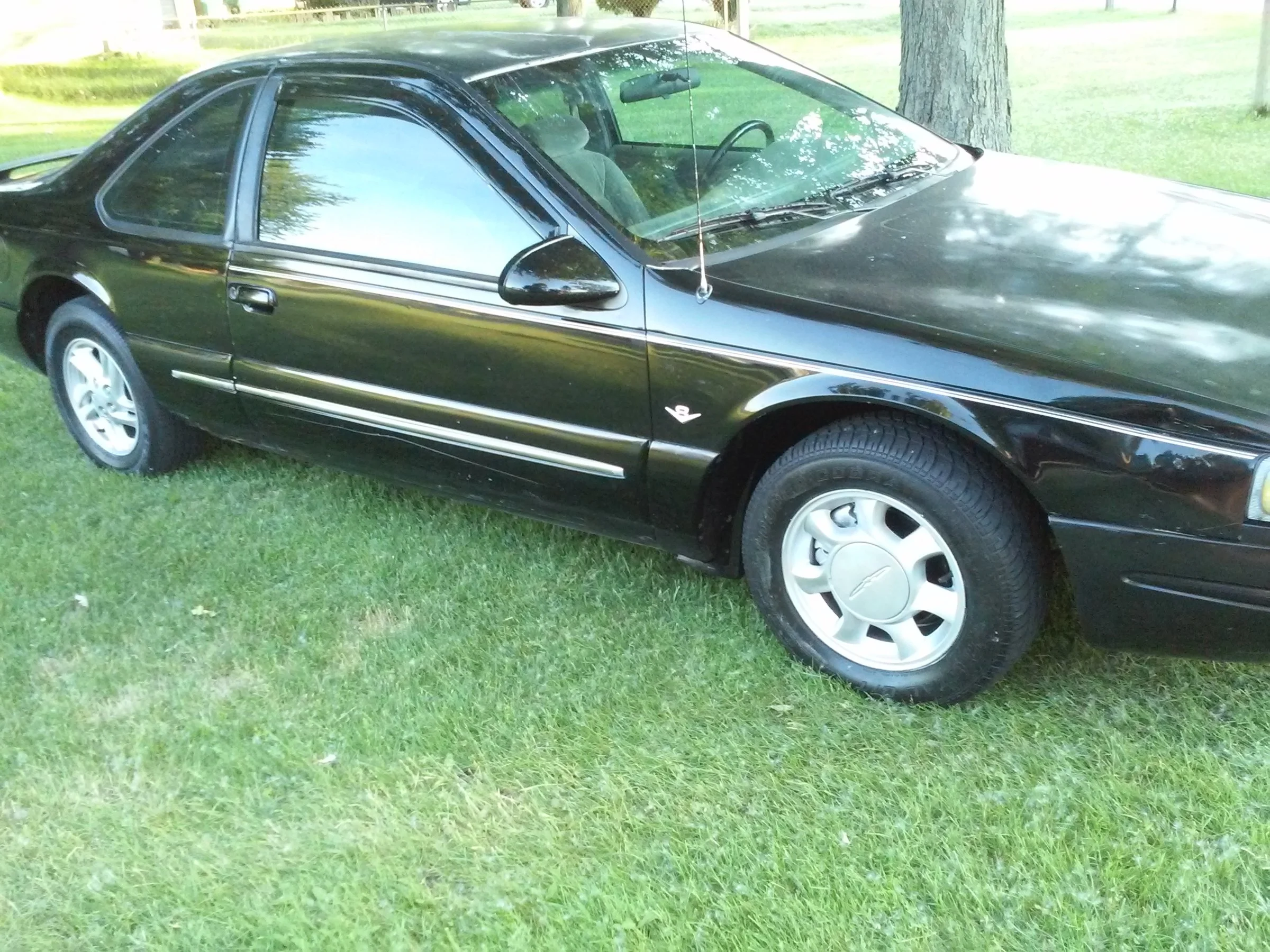

I HAVE A 96 THUNDERBIRD WITH 96 STANG GT ENGINE IN IT. UNFORTUNATELY ITS GETTIN TIRED. IS IT POSSIBLE TO PUT A 1997 5.4 2V IN IT. JUST THOUGHT IT WOULD BE MORE ECONOMICAL IN LONG RUN.
There are more bolt-ons and performance parts for the 4.6, it bolts-in, they're more plentiful, they weren't truck-only like the 5.4 2v, I could go on and on, but the short version is, the 5.4 isn't really a better choice.
