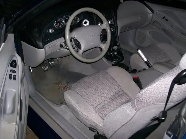

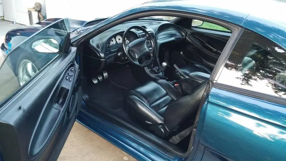

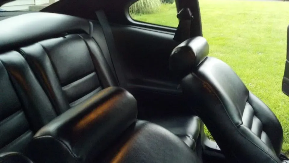

  15. Anyone wants to see firsthand what these look like I've personally done the TMI foams/upholstery. Did it all in a weekend. You will swear a lot, your fingers will be sore as hell, plastic grocery bags are a must and you'll also need to buy the CJP hog ring/plier kit, some upholstery foam glue and a few other misc things. I did mine in vinyl btw, yes vinyl. The TMI vinyl is actually nicer than the 94-04 OEM leather and this is coming from a guy who had a 95 Cobra with mint seats. This is not Grandpa's vinyl.
    Before:
    After:
    #winning
    edit: yes that is the same car. Interior was swapped right before I redid the seats.
    #36 silversmith82, Aug 13, 2014
