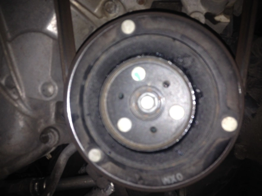

    Anyway, below is a picture of the AC compressor clutch pulley. As you can see, the clutch got very hot and melted into a jelly-like substance. Must have been part of Mulally's continuous improvement efforts: sell the cars at higher prices, change to cheaper vendors for components, and keep Ford out of bankruptcy court all while pinning the bill to their customers.
  4. Had the AC looked at. They believe the coil and clutch are demolished, the whole compressor will need replaced and the system will need flushed and recharged. Quoted me $1100 if the expansion valve doesn't need replaced, $1500 if it does (he said it usually doesn't). He told me I will probably just not want to use it, but I told him I might get it fixed next Spring. He said if that is the case, I should unplug the power to the compressor that way it doesn't kick on when I use the defrost in the Winter.
  5. I have an 05 ford 500. Same thing happened to me. I got the same quotes your getting. Then I went to an honest repair shop, talked to the owner. He suggested we both do a bit of research on the net. Well we both came up with a flow valve located at the back of the compressor. He quoted me 220.00 for the whole job. I gave him the Ok even though there was no guarantee that it was a sure fix. BUT IT WAS. that was 4 years ago and the a/c in that car is still ice cold. Might be worth a try. Find a mechanic that will listen to you. Also, make sure that if you do it, and it doesn't work, he gives you credit towards the whole compressor replacement. My guy agreed to that. Good luck.
  6. You can get a ramanufactured unit from Rock Auto for $223. If you can put it on yourself, you can then take it and have it flushed and filled for much cheaper than you are being quoted.
