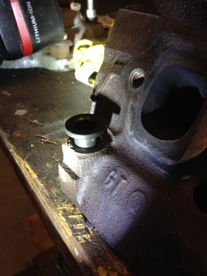

These washers came with my ARP stud kit. I assume they are for use with aluminum heads because they don't fit in my cast iron GT 40's. Do I just omit using them with the iron heads?
Some gt40 heads have 1/2" bolt holes too, but not all of them. Like said, omit them, but I wouldn't throw them away. You may need them later if you upgrade.
