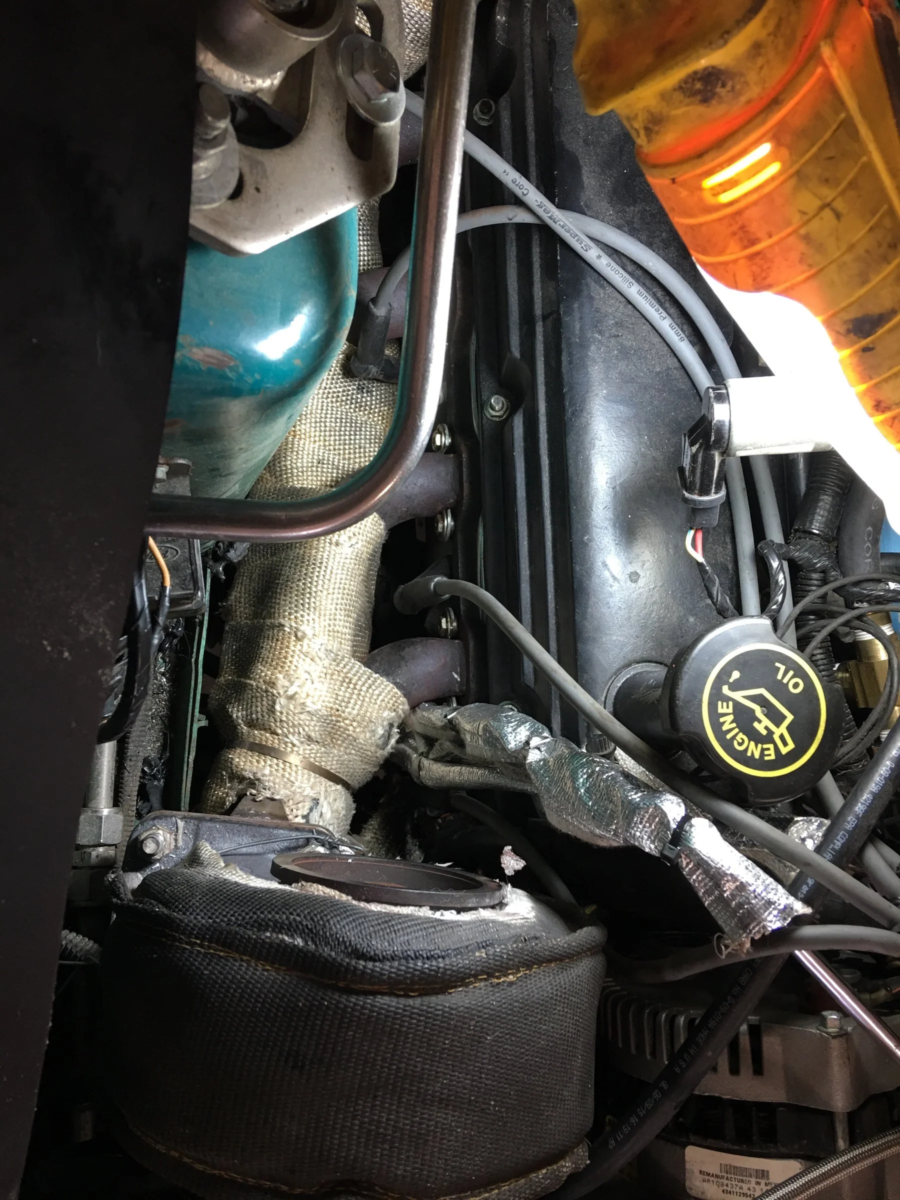

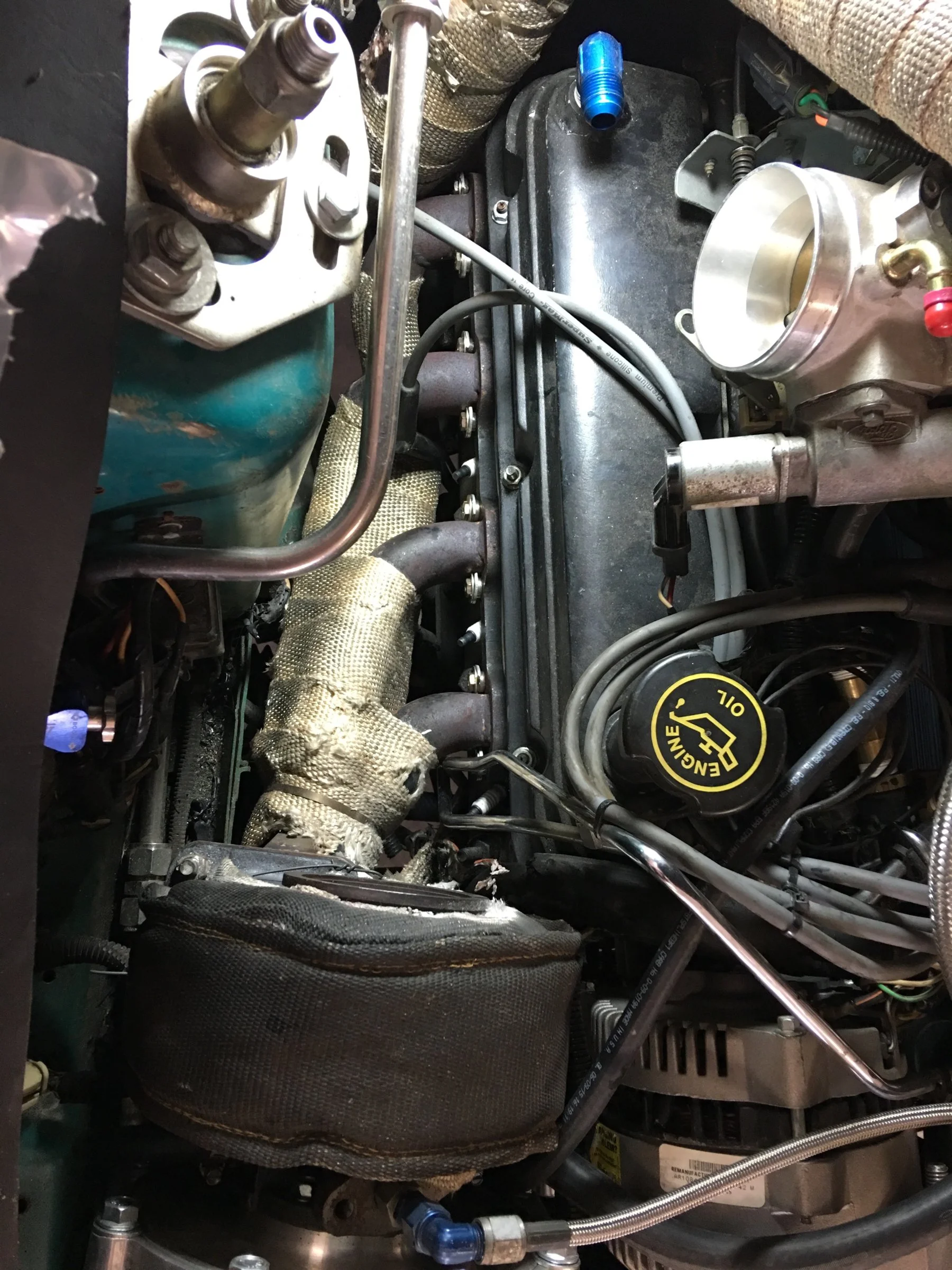

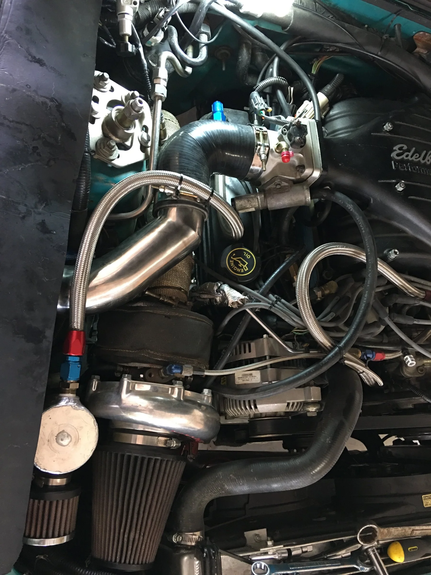

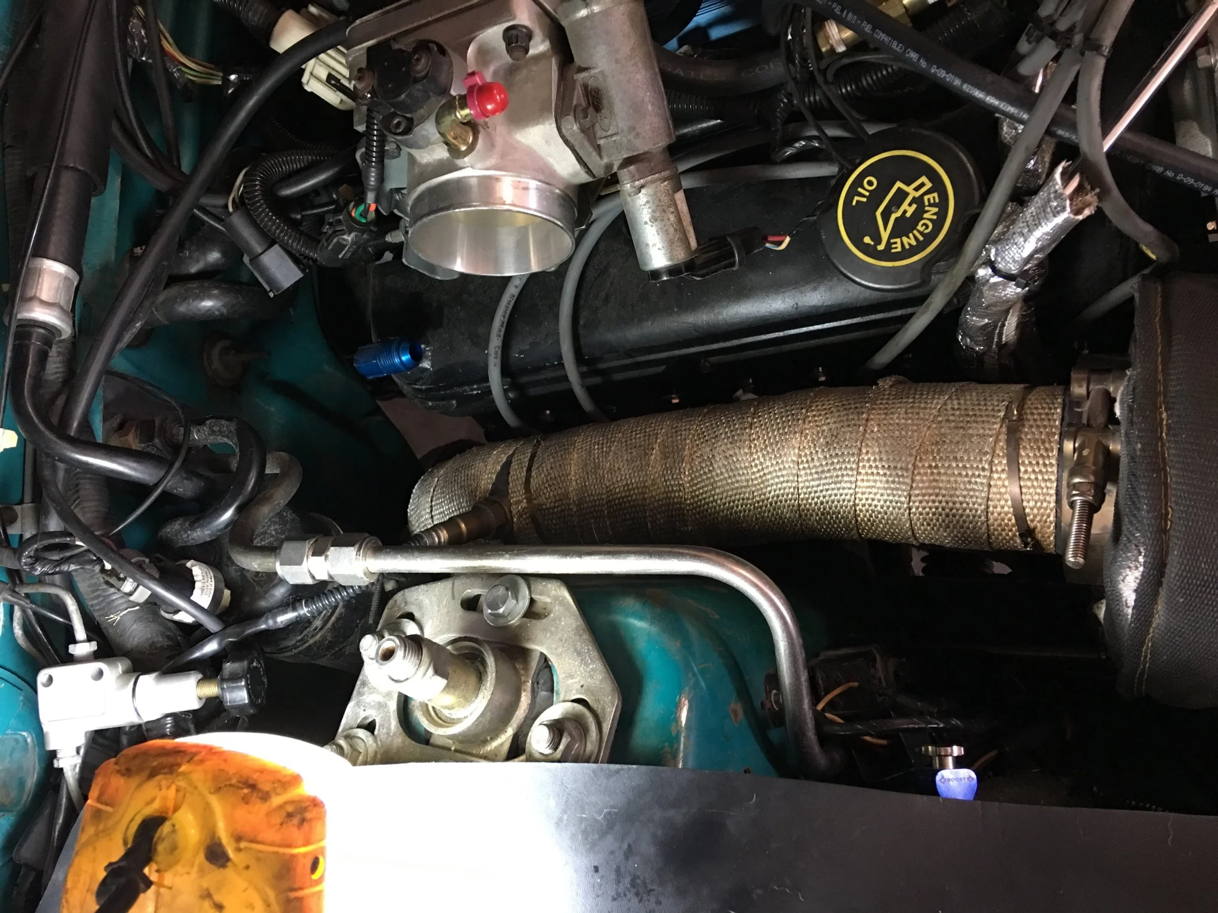

If there's one thing that's important on a turbo car, it's insulating things to keep the heat where it belongs. I've wrapped my hot piping, but it's all been in and out so many times the wrap is getting frazzled and is about ready to be redone. Not today, though. What I am going to do is insulate those two shiny fuel lines while I have things apart because if you can't tell, they've been awful friendly with that header.

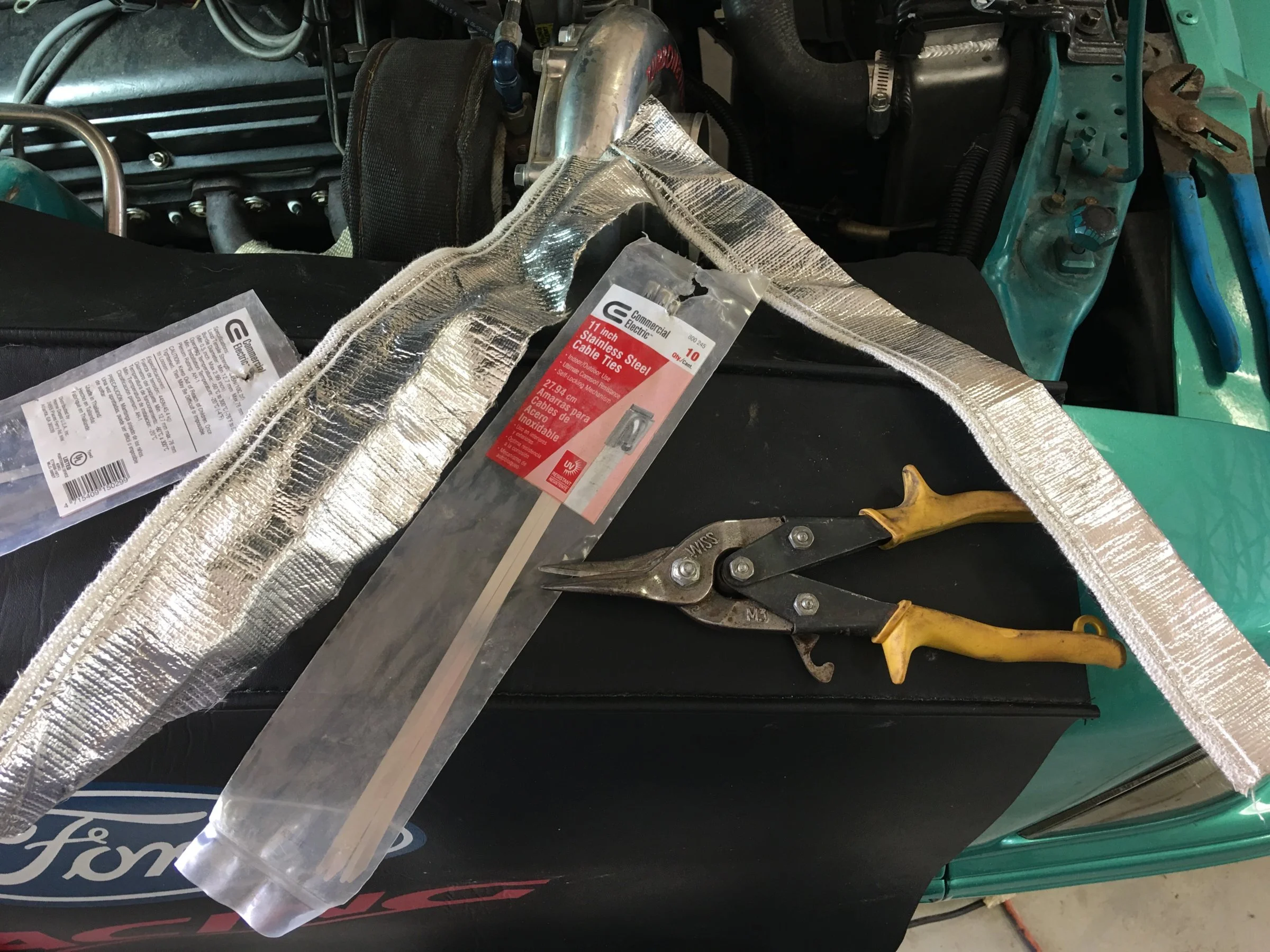

This is what I'm using.
This is some dei sleeve insulation I picked up at oreilly. I'm going to split it and fasten it with these stainless "header wrap ties".. I've used a lot of these.. FYI @90sickfox - don't buy these from summit or oreilly. You can pick them up at home depot for literally half the cost in the electric section.
Here, wrap installed. I'll get more pics up in a few..
