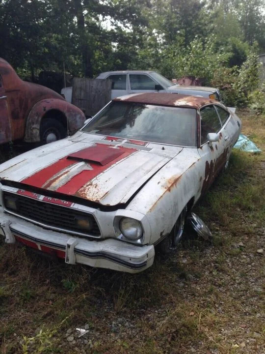

    lets see some pics of your new car

    All I have on this phone are pics of the donor car I got the motor from (new phone). I'll get some pics when I'm not busy with school, work, and football. Probably this weekend.

    I will say this, I'm glad I didn't spend any money on the motor from the second cobra II. I'd be devastated. But I got my ford explorer 5.0 today, $225 with a 45 dollar core I probably won't do. As I was hunting through the yard I saw Superchargers there were only 95$. Would I still be able to us a regular HO cam and upgraded springs with a SC? I know I'll need to convert to a blow through carb but mustangs unlimited has different cams for turbo/supercharged cars.
