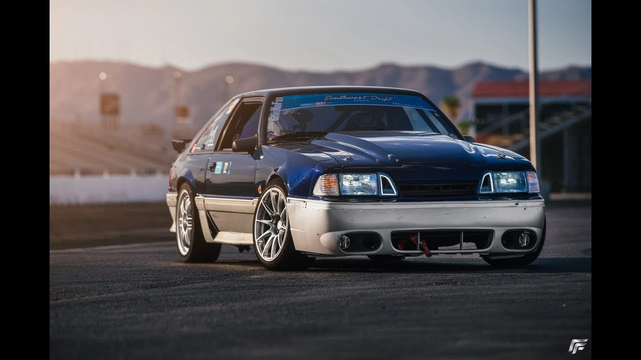

Was doing some research and was shocked to find there was no foglight halos for the later production foxbody's has anyone done something like this? What size halo should I use, the foglight lens is 4.5" I believe but Ill probably buy clear lenses.

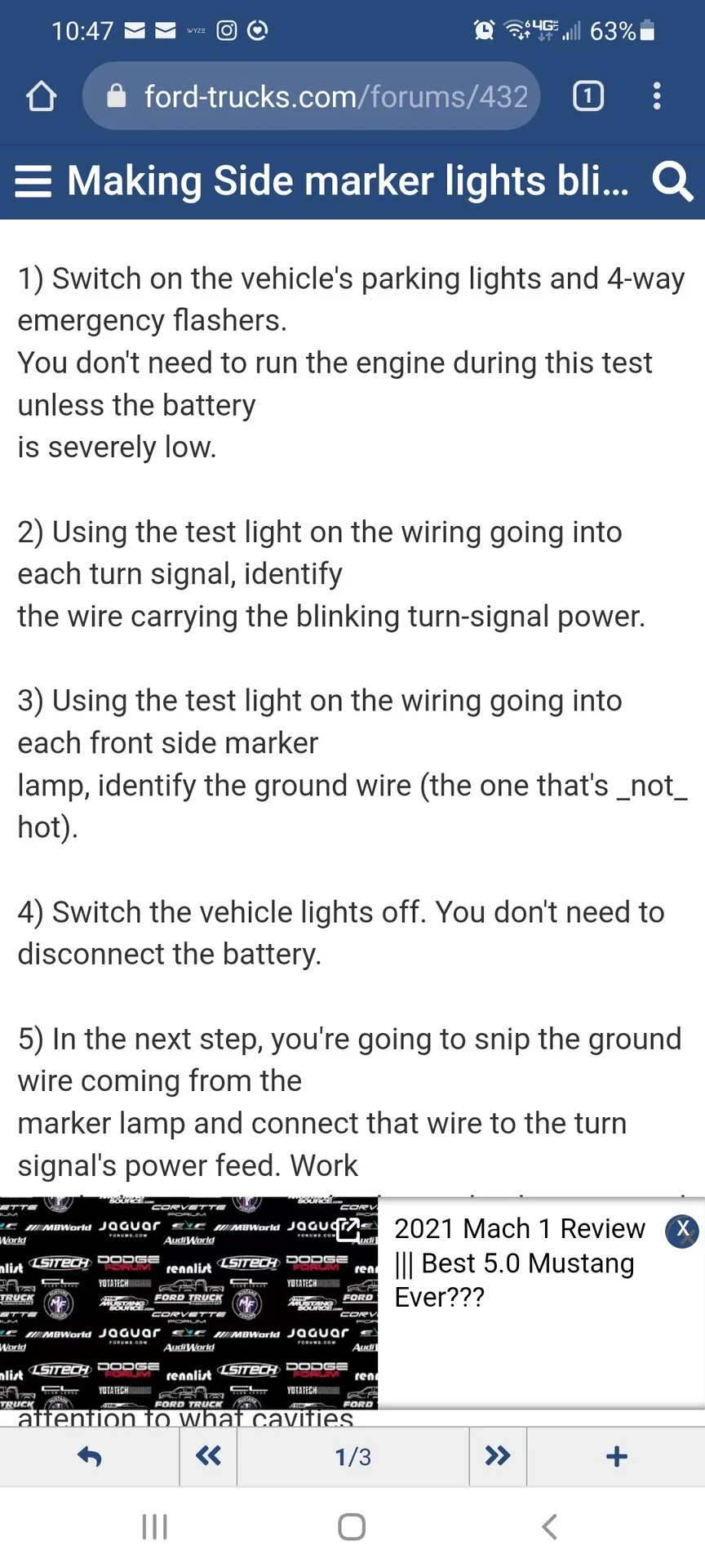

Doing quick research this is said to work on ford trucks that have 2 wire marker lights up front.
Here's the actual link... https://www.ford-trucks.com/forums/432817-making-side-marker-lights-blink-with-turn-signals.html
I haven't done this mod yet but seems like the easiest way. Ford wiring is pretty standard across models. The turn signal and marker light circuits of the 80s trucks and our foxes should be about the same. The turn signal flasher is grounded when not energized so it acts as a ground for the solid marker light when the lights are on. This is in theory. As I stated I haven't done it yet. Testing it out first would be highly advised.
There a a bunch of folks in that thread that say it works successfully.
