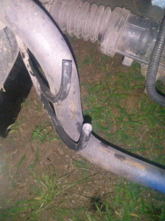

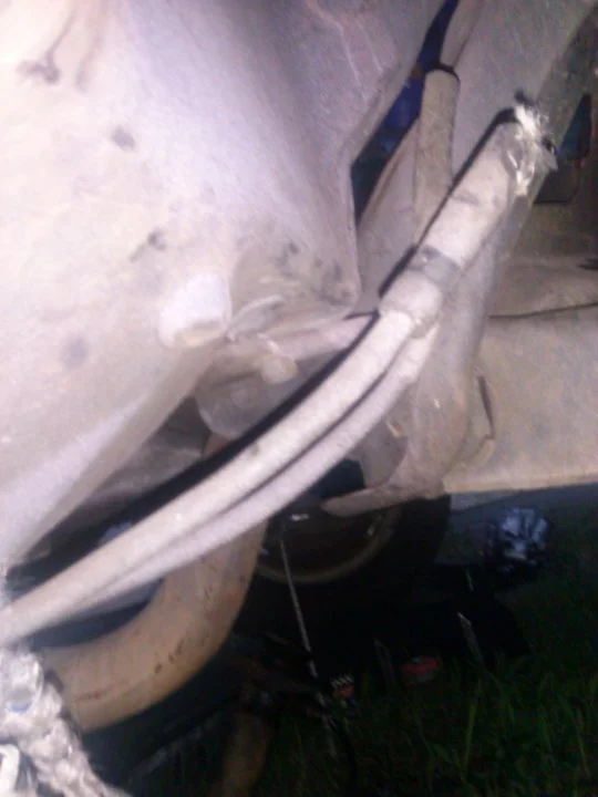

The ones near the smog are the original from the efi? And does a carb system have a return line? If so where does it hook
There is no return line on a properly built carb system.
The return line is used with the high pressure EFI fuel pressure regulator to return excess fuel back to the fuel tank.
Properly built carburetor equipped cars us a low pressure fuel pump and no return line.
Some misinformed souls try to use a regulator with the EFI high pressure fuel pump in an attempt to cheap out on the fuel system. Don't be one of them.
