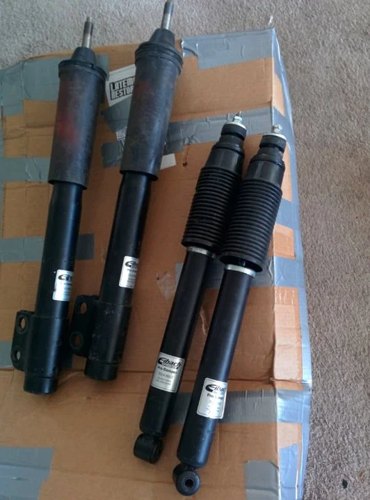

suspension parts are all in, so that's not holding me back. Last Saturday was nice and warm, but the daughter was heading back to college, which took up a good bit of time. Since then, snow and cold.

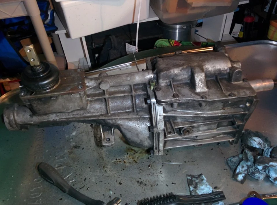

And I did get more done on that transmission:

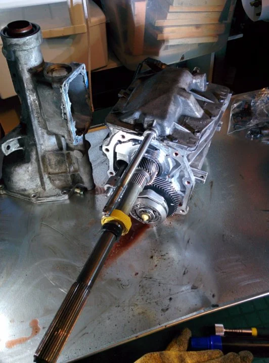

Got it apart to the point where I need something like a press to get parts off the main shaft.

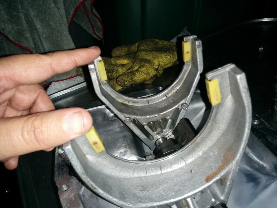

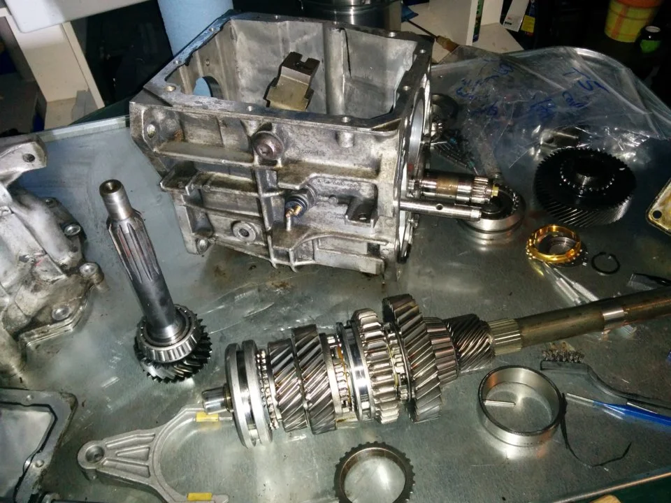

This tranny popped out of first gear, but otherwise shifted and ran well. So far, I haven't seen anything that could cause that problem. Here are the shift forks:

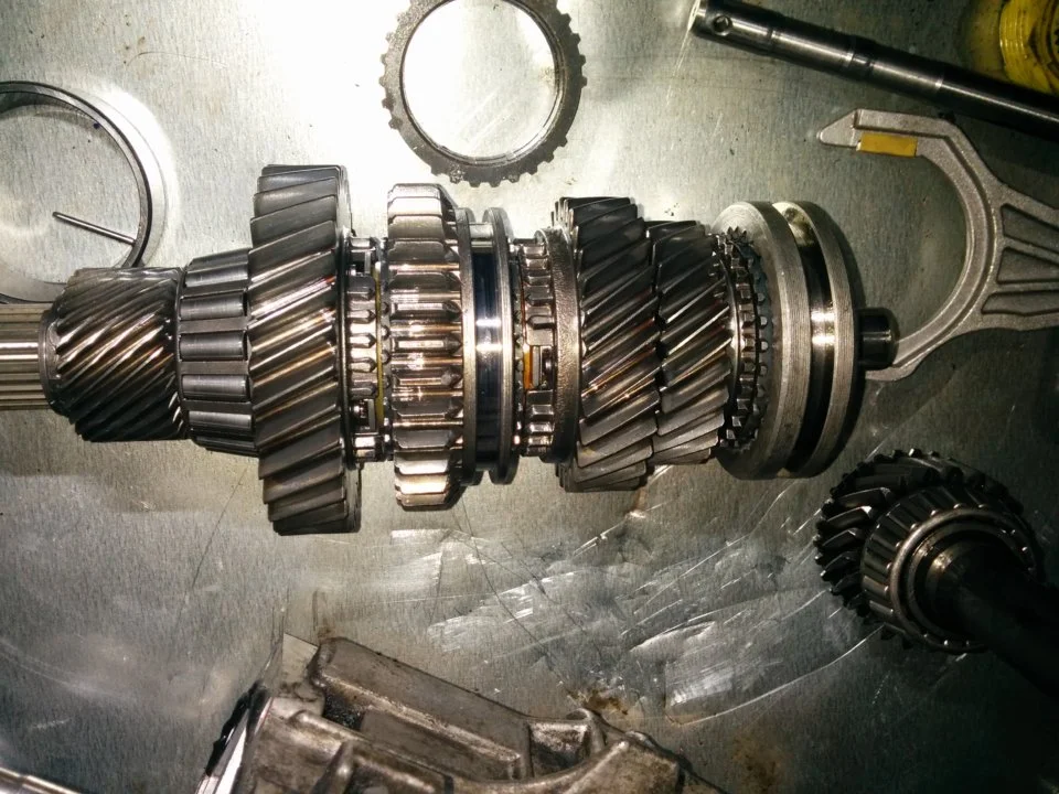

And here's a fairly good closeup of the main shaft, with gears still on:

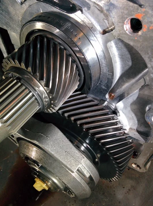

All the gears have shown what looks like outstanding wear patterns; no blade finish, chips, or other issues. The magnet at the bottom doesn't have any chunks. Of course, I know I need to get the main shaft apart before I can say for sure.
Idle uninformed speculation: could a badly adjusted clutch cable or bad clutch cause the problem with popping out of gear? It only did it in first, and the clutch was really tough to push in originally. The adjustable cable and quadrant were brand new, according to the previous owner, although they were adjusted poorly, as I mentioned.
