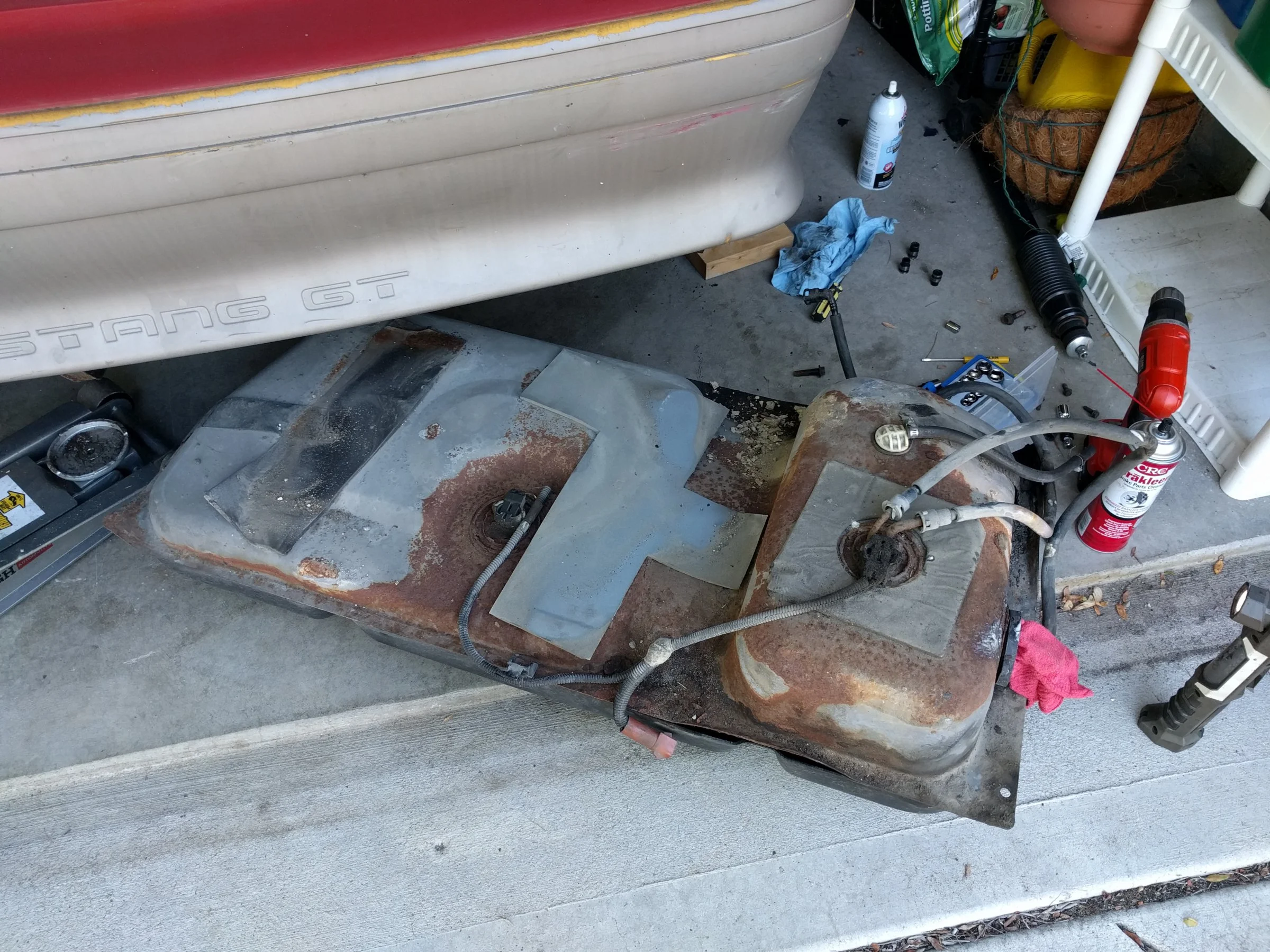

If I'm ambitious, this weekend might be time to drop the tank again. I'm still leaking from what looks to be the vapor line when the tank is full. I went ahead and bought a new vapor valve and grommet; I believe the rubber from the grommet is likely the culprit, and figure the other new part can't hurt. The vapor line itself is probably the only other possible cause, but that's easier to replace without waiting on shipping.
Also, I need to figure out what's up with the sending unit. The gas gauge readings seem to have some correlation with the actual gas level. I'm hoping that this isn't related to an actual problem with the tank; I've read sad stories of detached tank baffles causing trouble. So far, the fuel pump has held up, and there's no weird knocking when making turns or anything like that.
