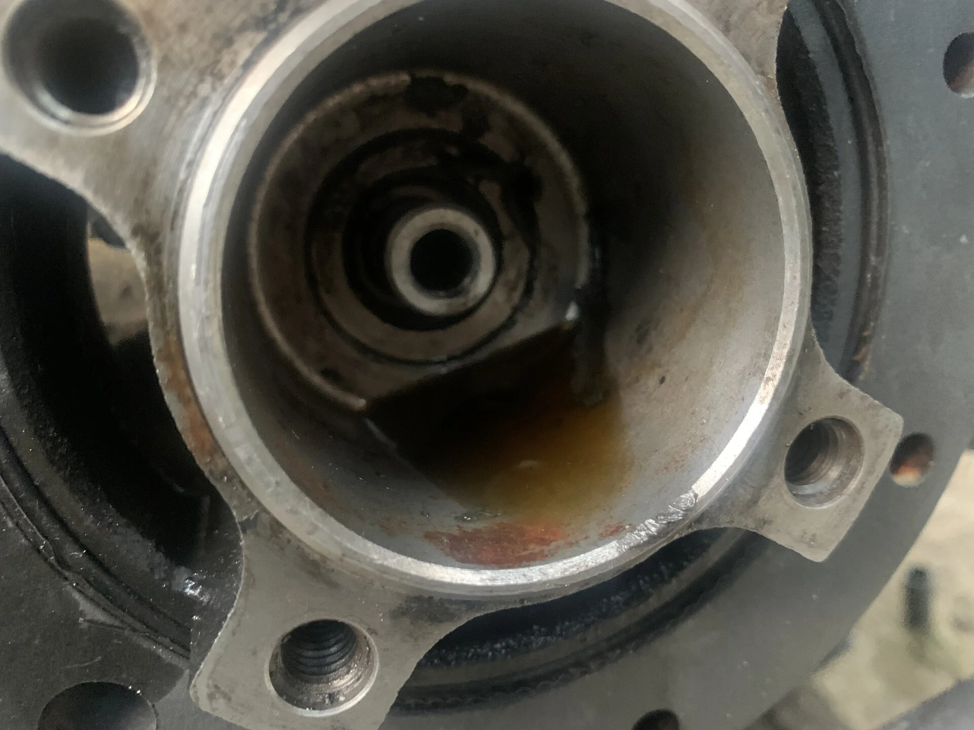

Hey last night while I was installing my harmonic balancer with the installation tool and made a huge mistake of turning the big nut without holding the main assembly with another wrench. Now the adapter that screw into the crank is stuck tight asf in the crank. I tried using vice grips to turn it free but that was a massive fail. How the hell do i get this adapter out the crank??
Pics?
The brown liquid is penetrating oil but that’s the adapter in the center

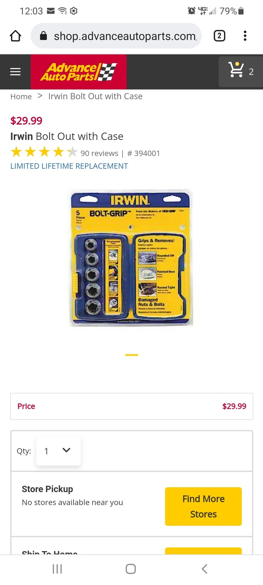

You'll need some heat and a Irwin tool set. The heat may damage the crank seal. To fix that the timing cover will have to come off. Try it first with moderate heat from a propane torch.

@SmokeytheFox to confirm, the piece that’s in there is a tube that’s threaded in the inside and outside? Here is what I would do.
Soak up the rest of the penetrating oil and use carb cleaner to degrease the inside threads. Use the air compressor to blow out the carb cleaner and clean again. Get a grade 5 or better bolt the right size for the threads and use new Red thread locker to keep it in the threads of the insert. The insert should have less grab to the crank than the bolt to the insert at that point. If all is clean and the Loctite is fresh, you will end up with the parts out of the car and stuck together enough to need heat to get them apart. If not, you’ll have dirty threads and will still need to use the tools in the picture, a left hand drill bit and easy out, or welding a nut on.

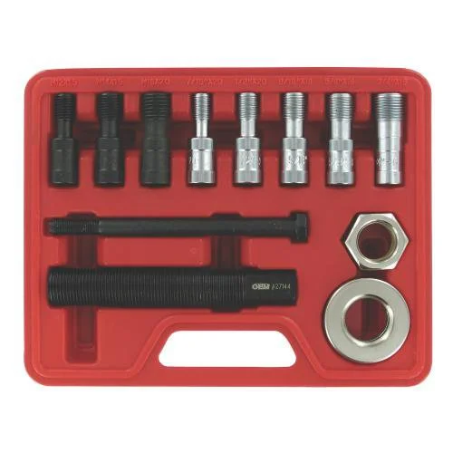

No thats a completely tool. This is the installer which is an adapter that threads into the crank with a giant nut and press. You're suppose to hold the assembly with a wrench while your turning the nut or that adapter is just gonna tighten up in the crank. Makes putting on the balancer extremely easy when i use it correctly. This time I was rushing and fcked myself by not paying attention lol

No thats a completely different tool. This is the installer which is an adapter that threads into the crank with a giant nut and press. You're suppose to hold the assembly with a wrench while your turning the nut or that adapter is just gonna tighten up in the crank. Makes putting on the balancer extremely easy when i use it correctly. This time I was rushing and fcked myself by not paying attention lol
the proper size bolt extractor can't get a grip since theres no ridges on the sides of the adapter. I'll try the bolt and loctite method in the morning. Im nervous tho, it'd be just my luck to have the bolt snap.
That’s why I suggest a grade 5 bolt. It’s hardened, but not so much that it will be difficult to drill out if you break it. A grade 8 will be fine if you have LH carbide bits from McMaster Carr.

You may end up having to drill the threaded adapter / insert out
I would spare no expense buying a series of left hand drill bits
I buy left hand bits regularly
It is not easy to find the big ones
The crank thread is 5/8-18
Do not drill more than 9/16 maybe 14mm and then pic the remains out
If you are lucky the insert will come screwing out with the 1/2 left hand bit
