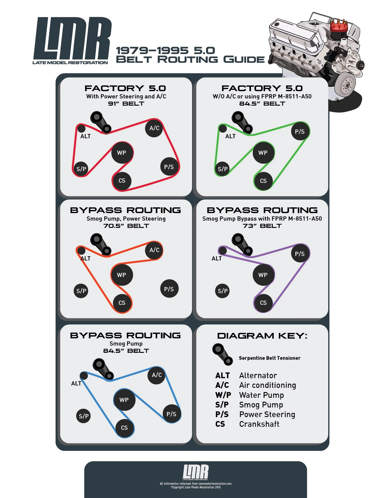

Hello fellow Mustang fans, I'm wondering if anybody knows what size belt I can use to bypass the smog pump. Mine has seized and need to get it to the mechanic to fix. Cheaper to replace the belt than get a tow
