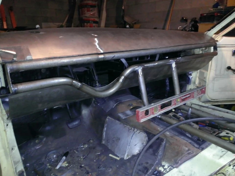

Try as I may, I just can't get all warm and fuzzy about my steel bar/sheet metal dash and console concept.
I spent all day yesterday building the support structure for the lower half of the thing, and got the mount brackets fabbed to hold the thing in place (all other pics were just of the thing sitting in there)
We are now about 30 hours wasted between the steel bars, and the sheet metal covers. There is still at least that much in the gauge pod that will sit on the top,....and who know how many hours that I'll have to spend trying to get it all finished to a level that will even be close to calling it done.
This is why I've been dragging my ass,...It just wont talk to me.

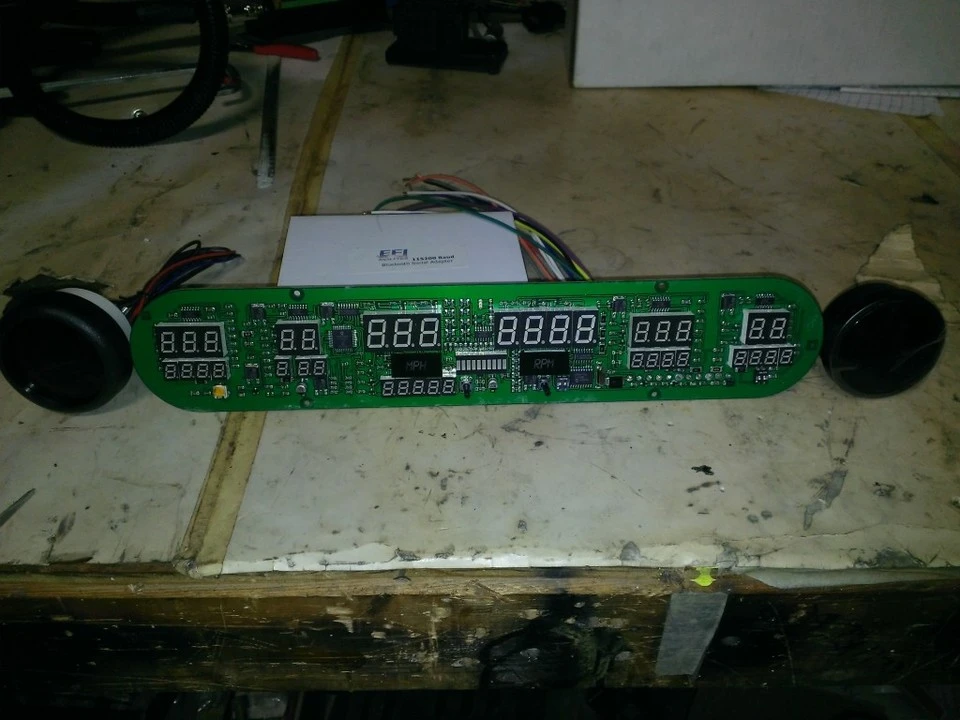

Probably the highest obstacle to jump when trying to make this decision is my choice of gauges. ( And believe me when I tell you that changing these are not part of my plan)
This was planned as one long tubular pod. With the two outboard gauges, I'll have Boost, oil press, water temp, MPH, l T/S, r T/S, High beam, Tach Volts, fuel, and AFR all in one tidy display.

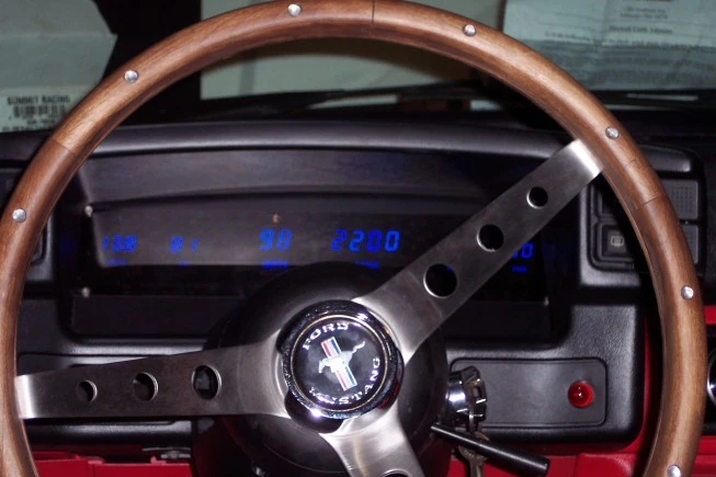

It's a damn Mustang dash, and I got those gauges to have to work in. I made them work in the red car, and these are exactly the same.
That middle housing fit perfectly between the confines of a post 87 gauge pod, and because of the rectangular shape, it worked. Whether you like them or not, They fit.

So,......you have pics. Should I dump the tubular dash or opt for something that fits, or can be made to fit.
Mike, I feel ya. I'm so Not doing the Florida 5.0 thing. I've looked at a ton of dashes and cant seem to find "it".
I do like the Fox setup you have there, was that your red car?

I like the look of the dash so far, although I feel you will need to mold the poles of the center section into the lower sheet metal of the dash. Those gauges are straight out of the 80's, or maybe even knight rider (fitting for a guy named Michael), and I hate them as much as I did in the red car. Now that that's out of the way, continue on with the project and see if it takes form in a way that starts talking to you. You wont be happy with a Mustang dash, everyone in the forum/world knows that. If anything, I would have the stock dash wrapped in leather/vinyl and put it back in for a unique, but subtle look.

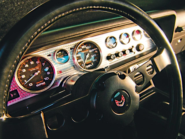

And after looking at the above link, you absolutely HAVE to scrap those digitals and make a custom pod for gauges like those in the link. This car is going to be so bad ass with all your custom hand built touches, dont skimp in the area you will be looking at the most. That is unless you are the real Michael Knight that influenced that amazing series.
Can the dash be mounted in a way that would allow you to remove the center vertical bars, and have that console end how you currently have it under the dash? You could mount your radio in between the bars in the center of the dash, and that would clean up the look quite a bit. Dash and console as two separate pieces. Sleek and clean.
I'll take note that you hate the digital gauges, and that you have always hated them.
But they're stayin. When you think about it, if they have an 80's kinda look, and I install them on a car made in the 70's..........................
FUTURE, BIT CH!
They were outta place in the red car, because I was after a 60's retro look. This car has no such restrictions. As for scrapping them, and installing something custom built from Classic instruments,.....Uhhh.....I would have to start making, and selling blue crystal meth to be able to afford that.
Bottom line......no. The Autometers that I put in the red car were like 1200.00. I can't even fathom how much one of those CI custom assortments would cost.

Remember this?
Although this is only a rough variation of the intended look, I still have to find a way to integrate a door bar that just so happens to be part of those dash bars. Just placing a scrap bend against the horizontal bars opens up a whole new can-o-worms, as that bend radius is way lazier than the ones pictured. The bend as it is now that will allow the transition to become a door bar will intersect with dash bars so far in, there is little remaining space for the dash vents for the A/C. The bigger complication is the top and bottom arch(s) of the dash will have to blend on top/bottom of that door bar.
If anything, I'm gonna have to redo the area where the top sheet metal meets w/ the top bar to reveal more of the bar (like the bottom bar is now). Then when I build the door bar I can get a good fish-mouth notch that will "sit" on the dash bar when the door is closed to look like the bar is a continuous bend around from the dash onto the door.
