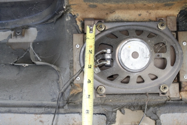

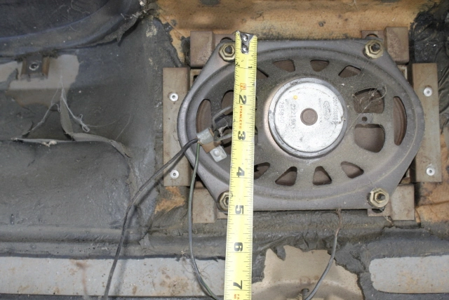

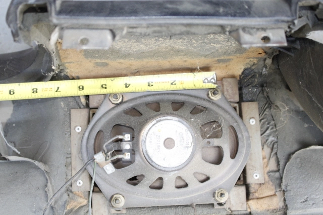

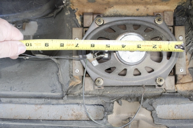

I have my dash pad out ,the bolt pattern is 4 3/8 x 4 3/8 inches
the speaker measures 5 x 7

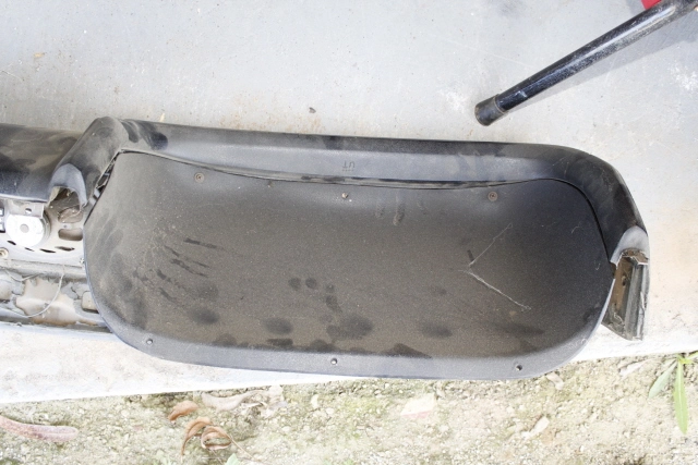

when you pull the pad leave the plastic piece above the glove box attached to the dash pad but the gauge cluster stays attached to the metal lower part of the dash
