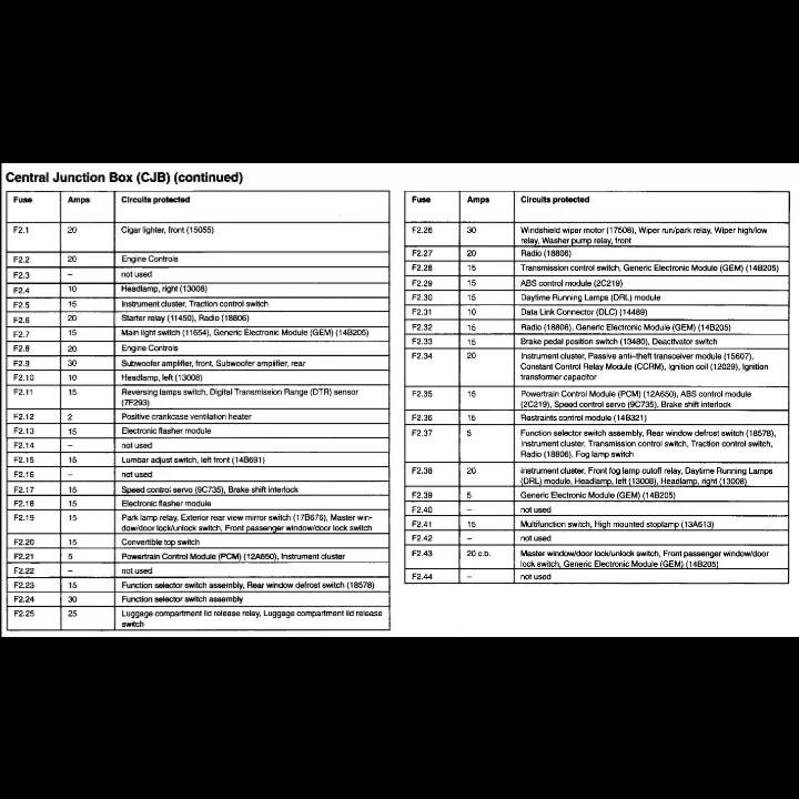

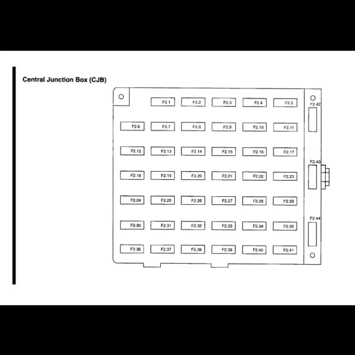

I don't know if this has anything to do with the issue but last night I installed new headlights, then tonight when I needed to head to the store I notice that when you pull the knob for the lights the instrument lights don't turn on (no back light) but headlights work fine. when before the install they turned on like they're supposed to just fine. After some experimenting I noticed that If you pull the knob in between the 2nd and 3rd position you can get the headlights on and the instrument lights on but only in a very specific spot. Its really annoying and I'm wonder what I can do to fix the issue.
