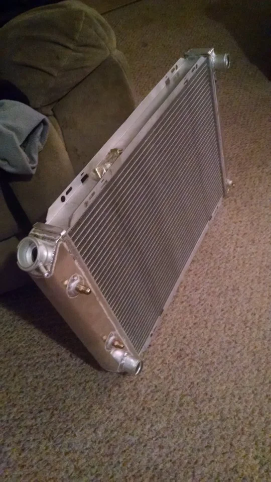

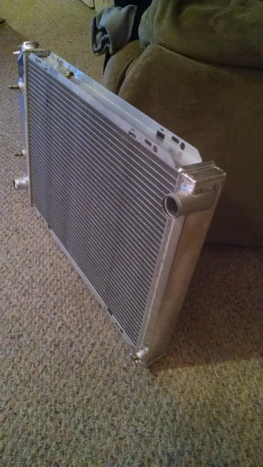

Not bad. I can see going with oneFor about 4 months....it was cheap. I saw the radiator under shepherd aluminum radiator on amazon for like 160 ish. Looked the company up online and ordered directly.

Actually looks just like my fluidyne as well and from your cost, it's $300 cheaperFor about 4 months....it was cheap. I saw the radiator under shepherd aluminum radiator on amazon for like 160 ish. Looked the company up online and ordered directly.
