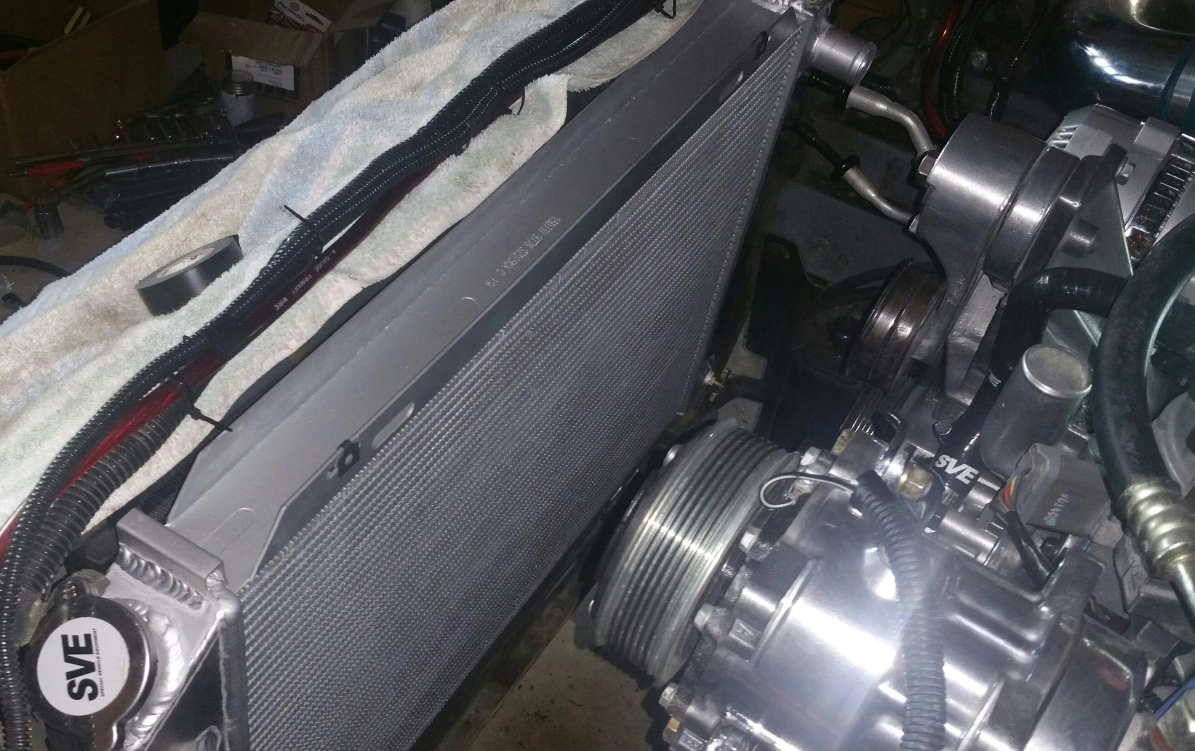

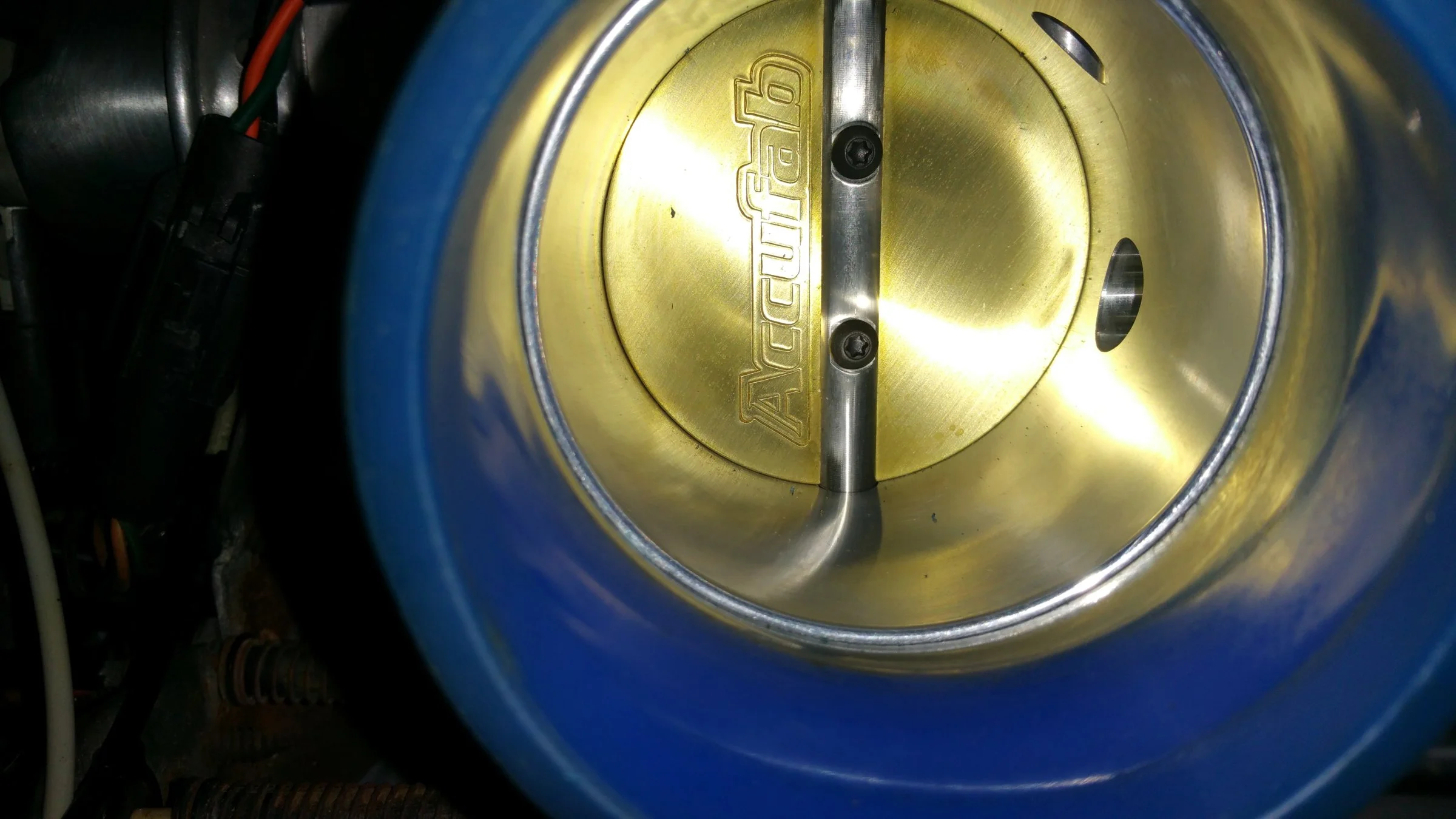

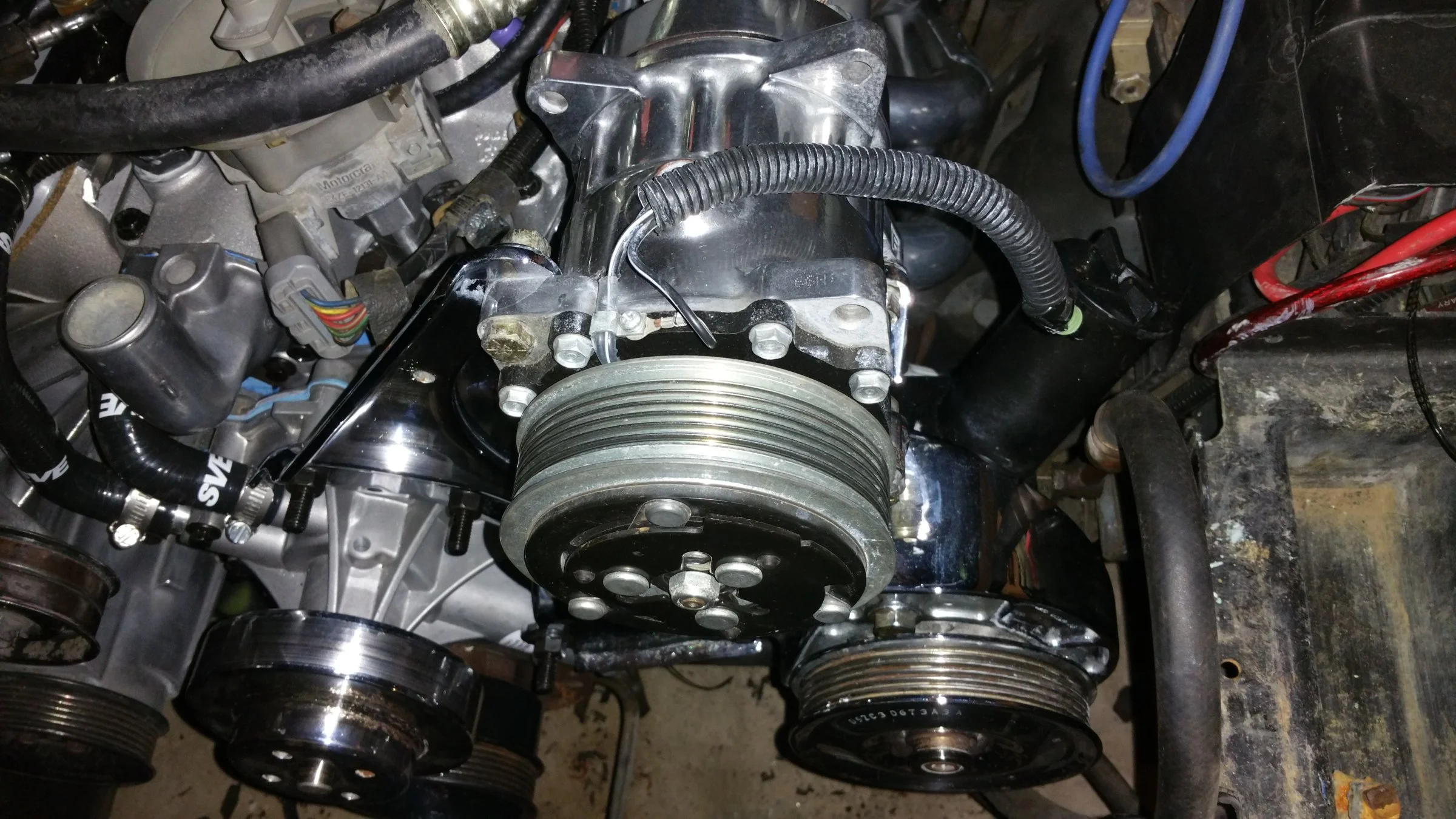

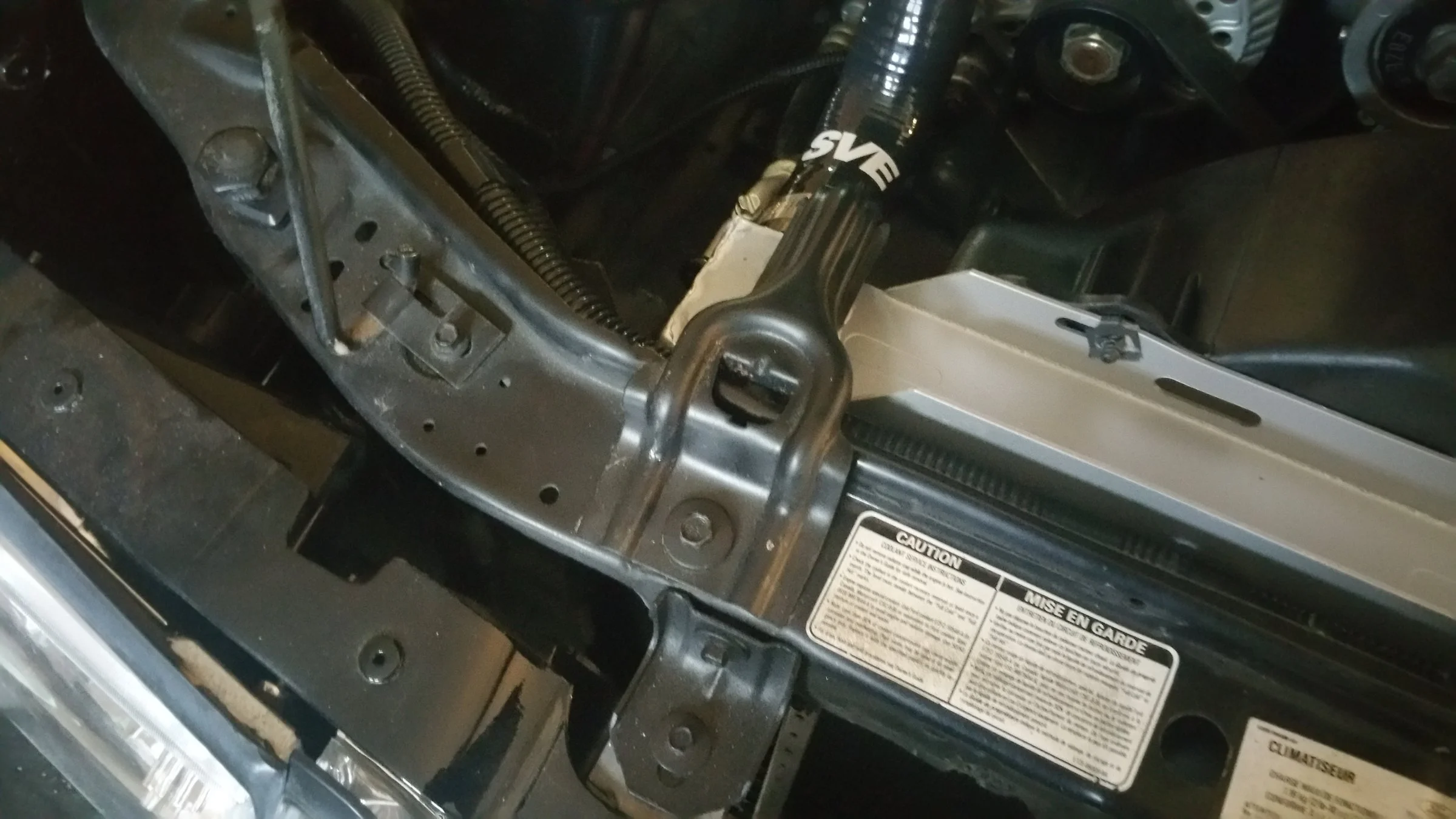

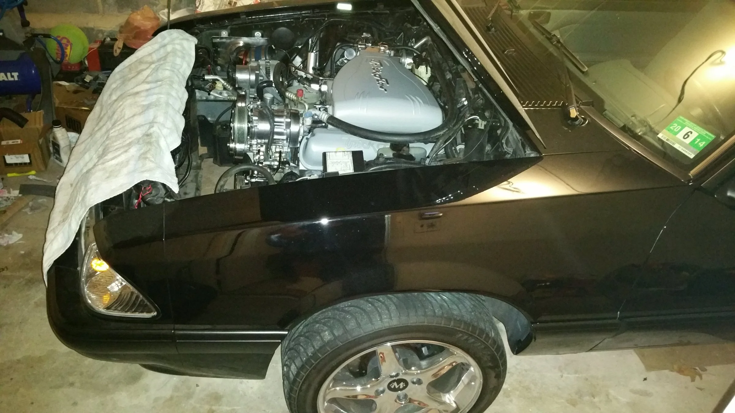

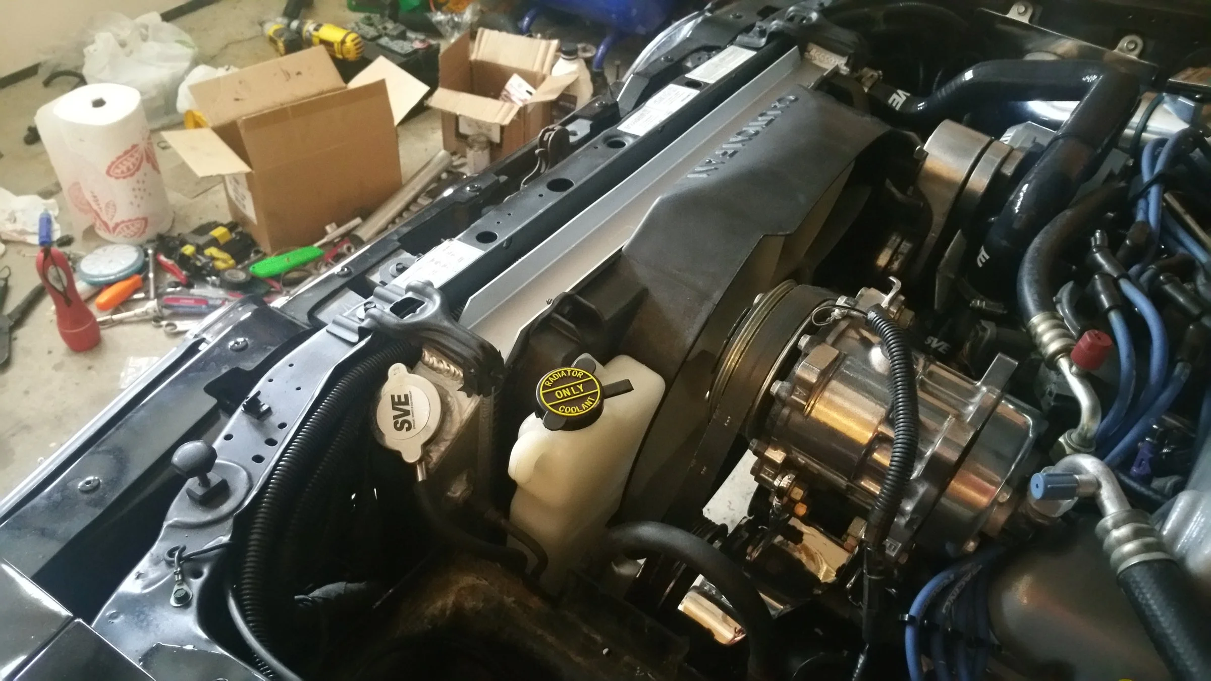

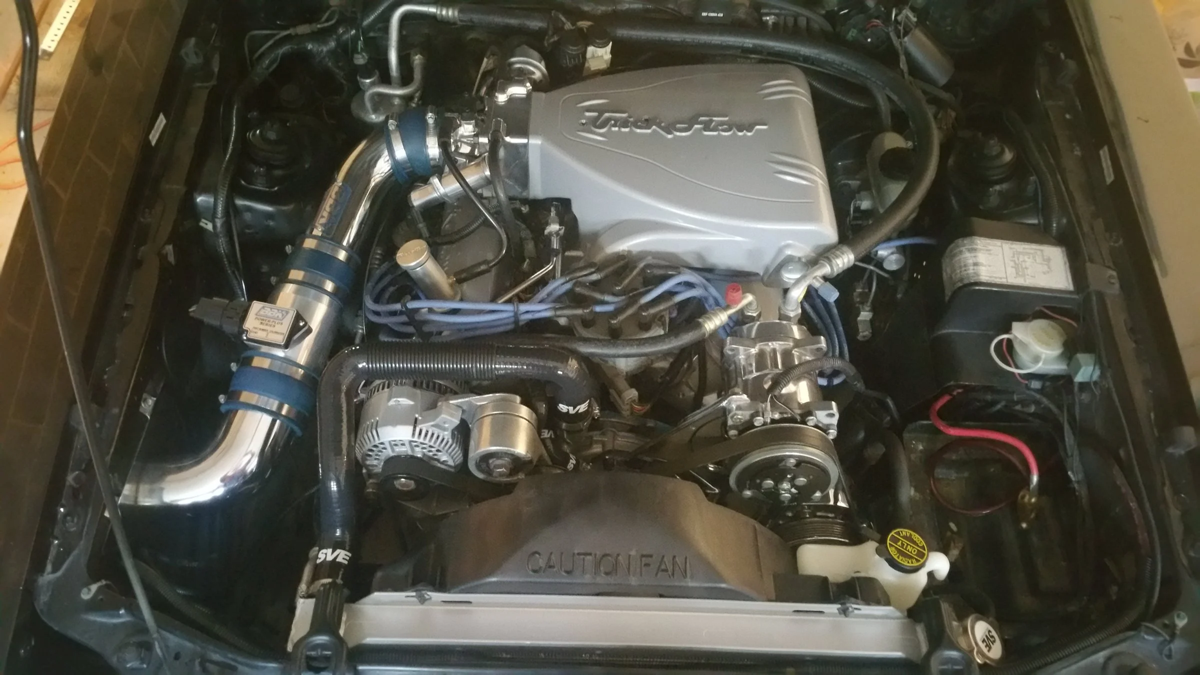

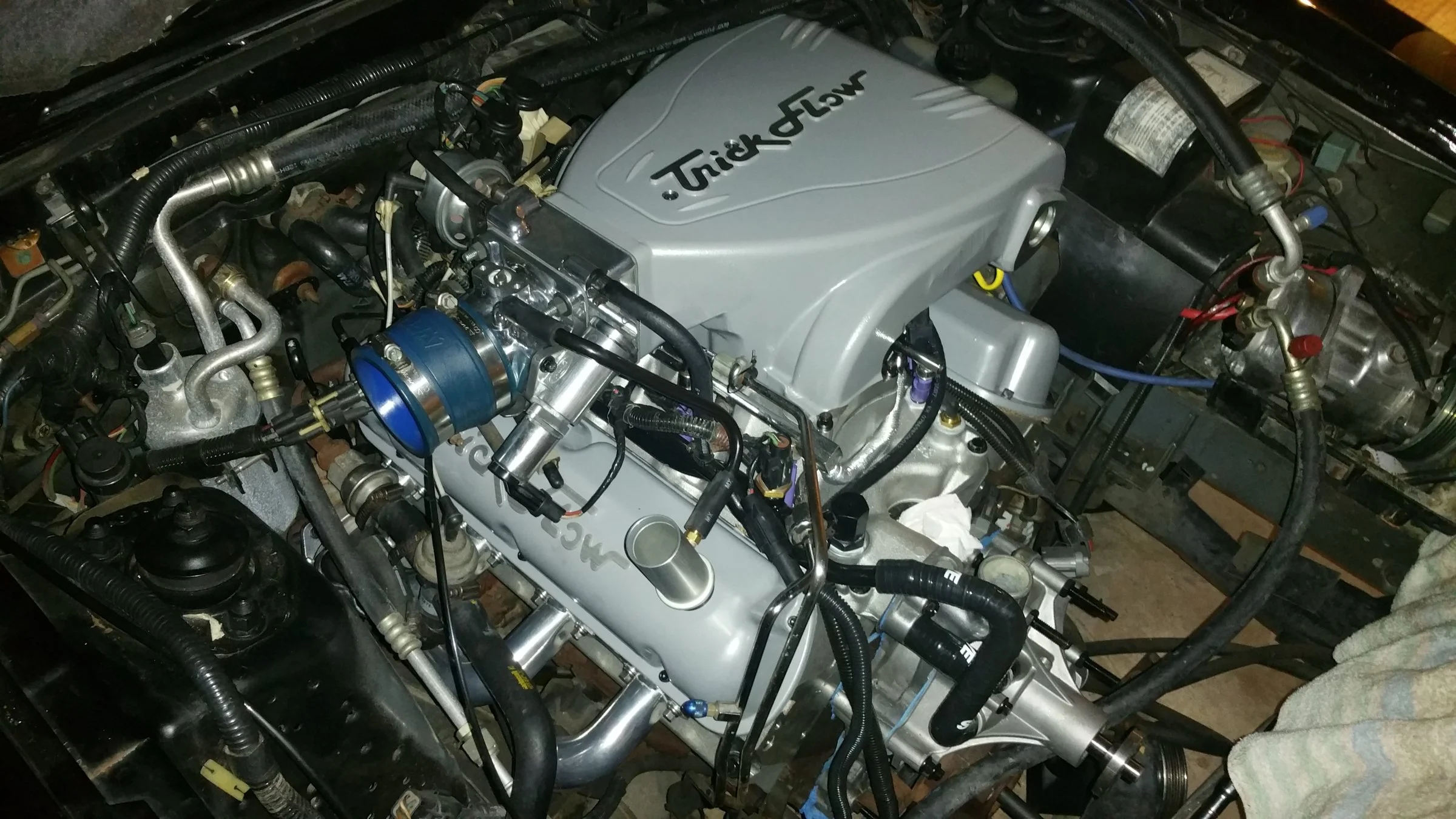

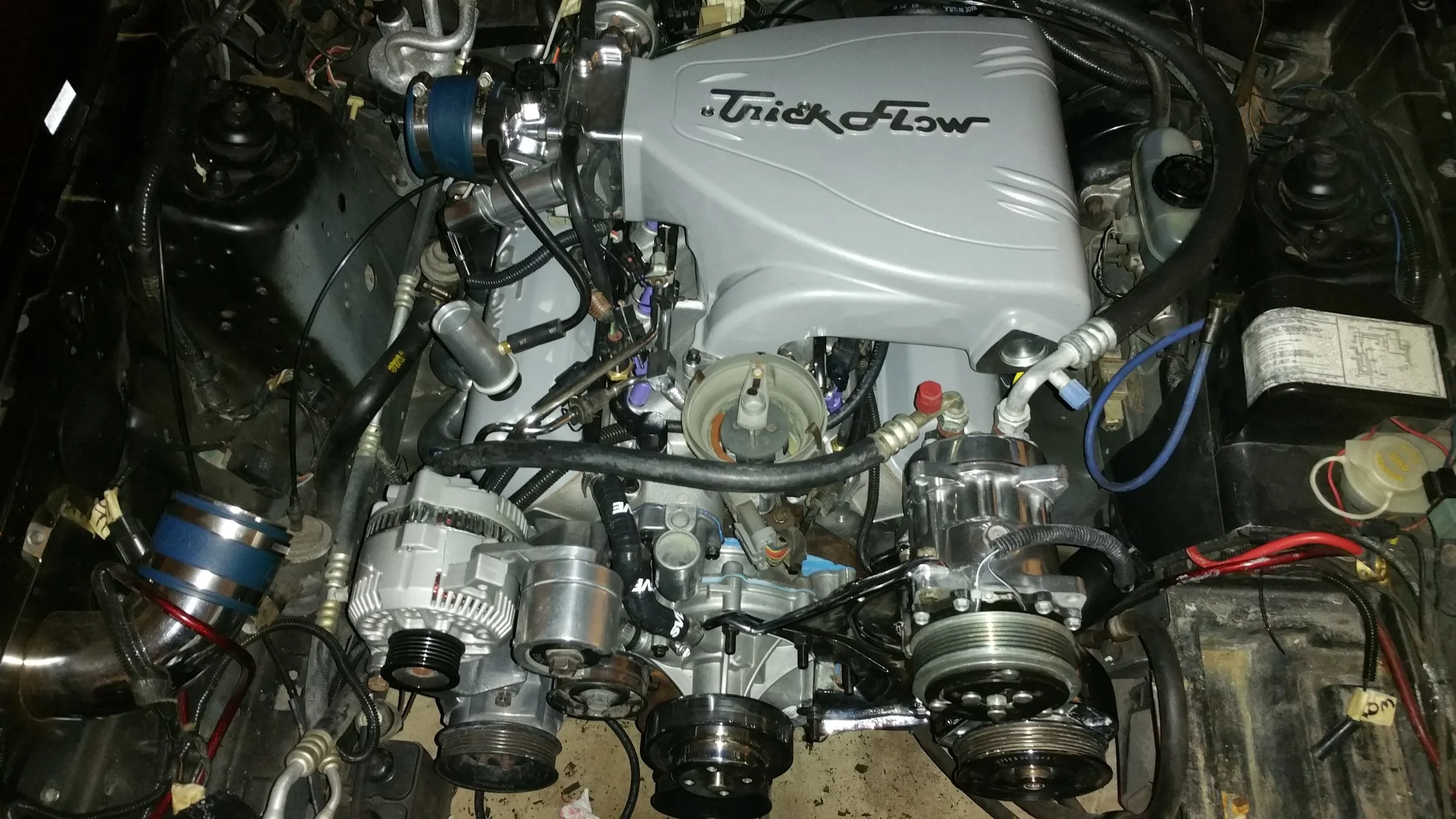

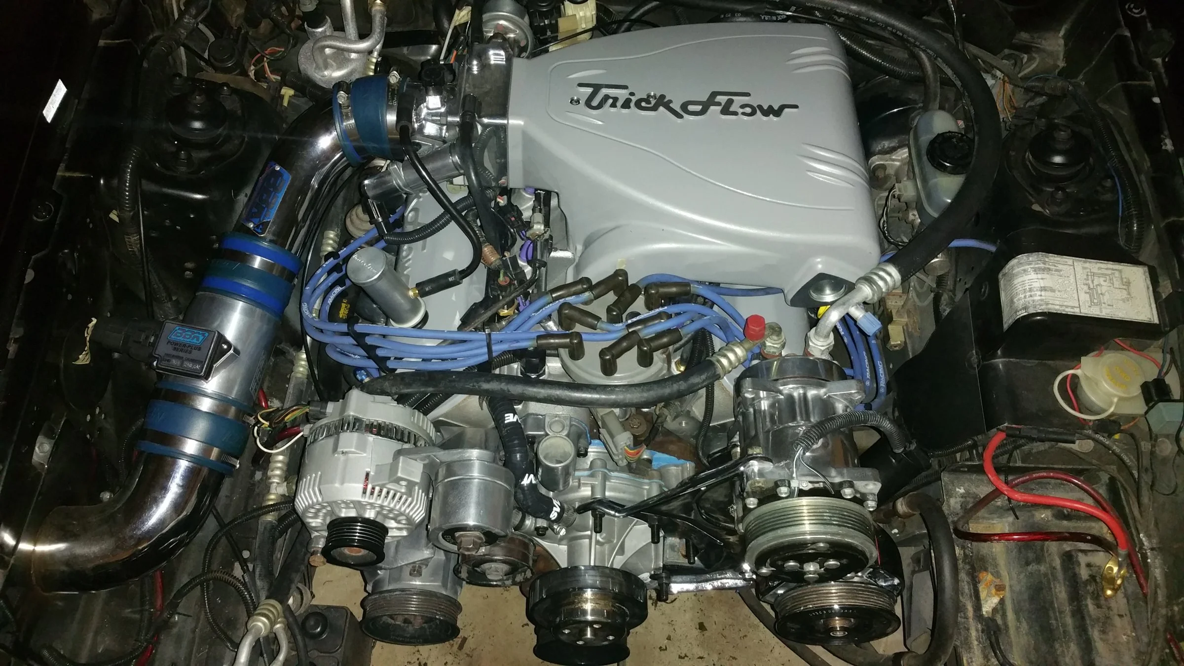

Some actual progress today, after two trips to the auto parts store for vacuum hose. Trick flow mentions in the direction your gonna need some 3/8 line about a foot long. Not the case, I ended up needing 4ft because the pcv won't reach from the position it's in on the new intake. Also the hose leading from under the intake from the vacuum tree won't reach the tee on the firewall. I also needed to bend one of the branches of the vacuum tree under the intake so it would reach the fuel regulator. All in all pleased with progress this morning and feeling like I have a shot at trying to fire this thing by next weekend.
