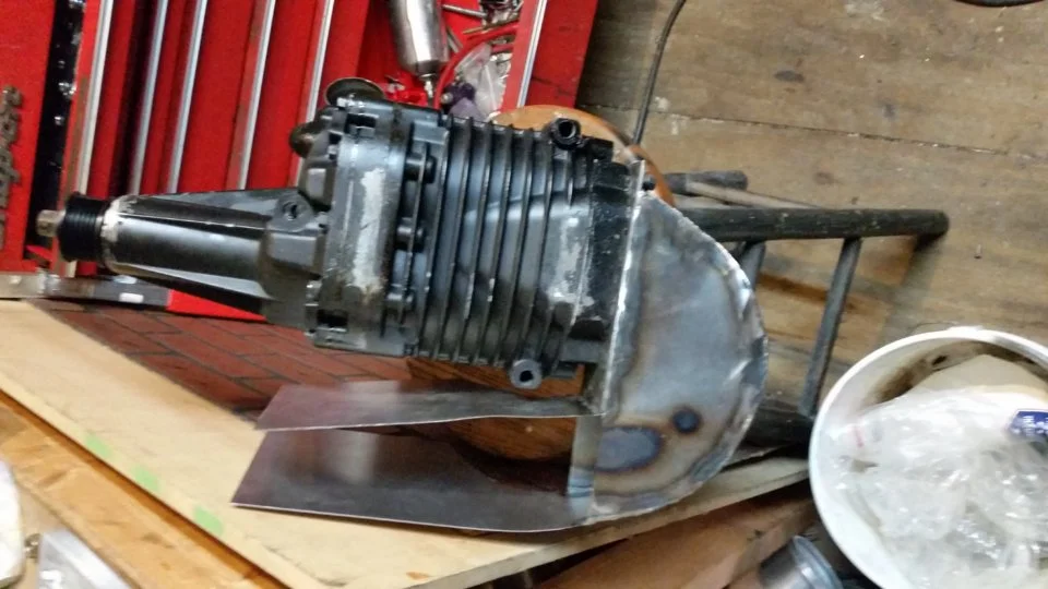

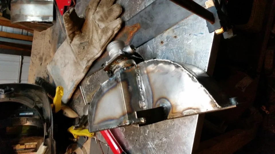

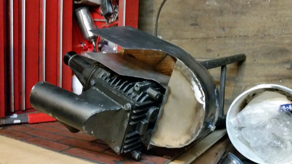

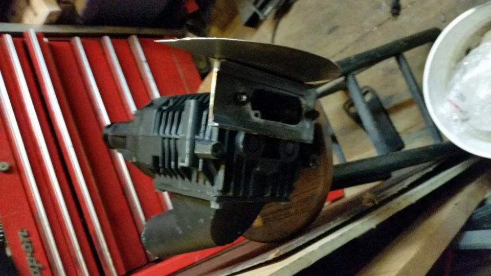

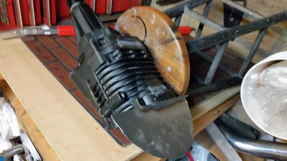

Just so you get the idea of what I'm trying to do. Here are some starter pics.
The flange has some angle tacked to it so it does not warp. The inlet opening is equivalent to a 2.5" pipe. I can safely use a 3"x3" square box to feed it, but it's going to be a larger area than that by the time I'm done.
Some 5/8 tubing will serve as a sleeve for the bolt that ends up inside the plenum.

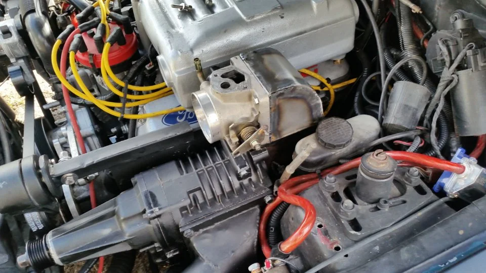

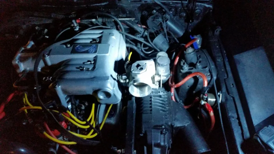

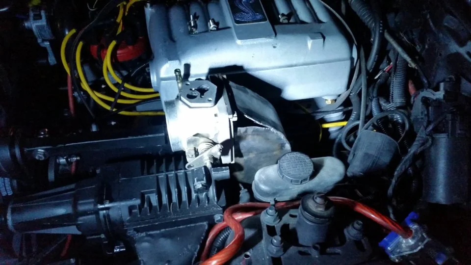

Well my original plan was a fail, do here is the start of 2.0
I'm going to set up a remote mount idle air control with the adjustment plate going to feed it with a small filter from my valve cover it's going to feed into the plenum directly. That way I don't have to worry about the distance between the cold side and my supercharger inlet. I have the Mini Cooper supercharger bypass going to try to start setting that up soon I'm going to box in the throttle body adapter plate to the inlet and use some Loctite on the threads for the bolts
I already have an idea for the throttle cable bracket its a tight fit but it's going to work. As it sits right now I turn 1 90 from the throttle body and I'm in the fender

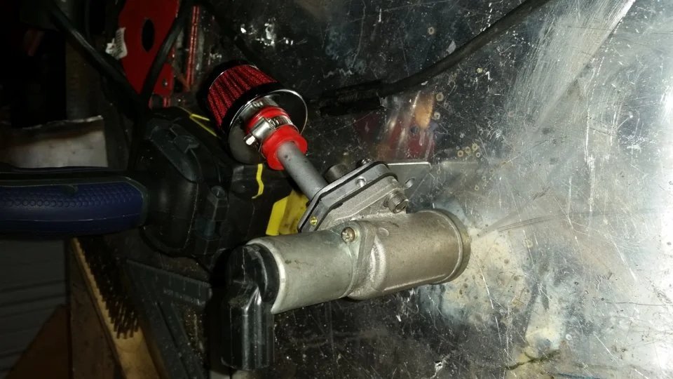

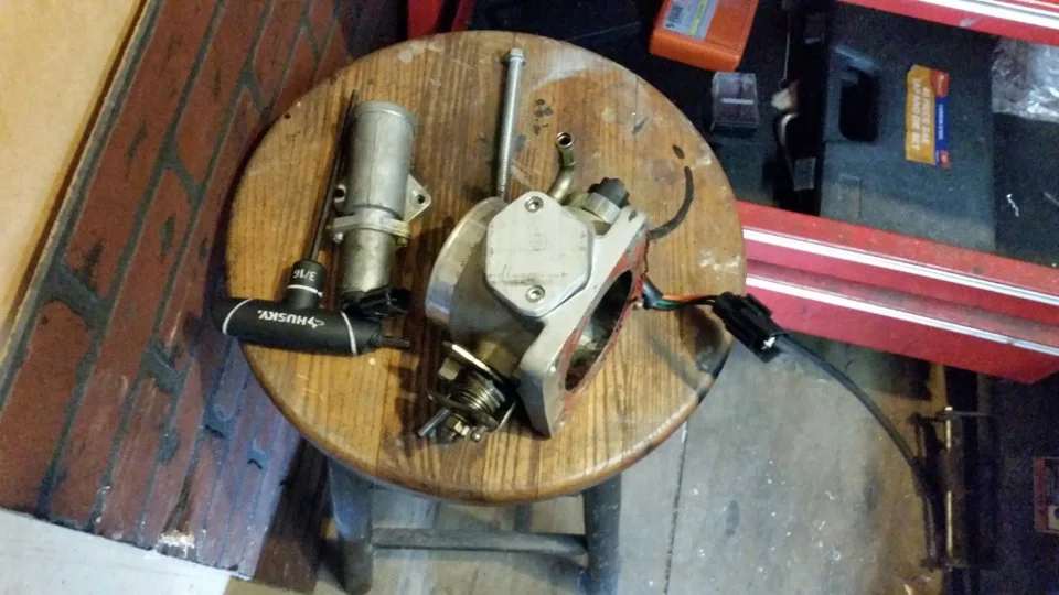

Some little stuff got done today.
First the iac, the intended location is no longer viable, will mount somewhere along the firewall.
it came out OK I guess.....
Next up the iac block off plate this one I made from some 1/2 aluminum stock I had sitting around.
the Allen head bolts are counter sunk in there, it needs a polish.
