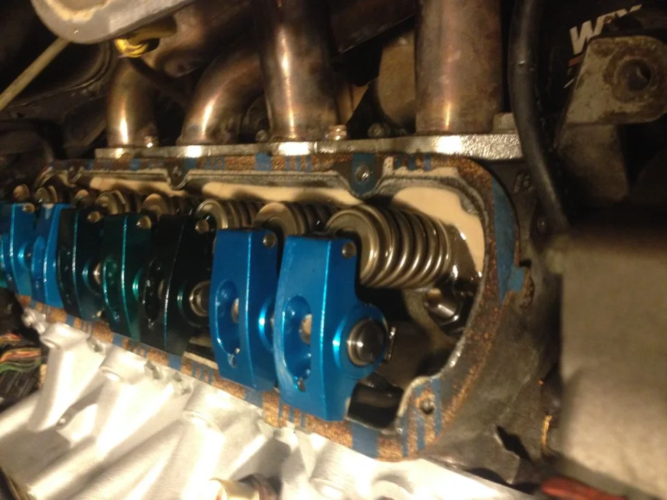

Some factors that may contribute. When I got the car it was leaking like a sieve from the intake manifold. Re-did the intake gaskets and she still leaks a bit of oil. I think the ungraded bolts the intake had arent holding because I could barely get them to stay at 20 ft-lb. Im planning on redoing this with new grade 8's. I figured maybe coolant is leaking down from the intake but a quick analysis of the dipstick shows no sign of coolant and the car is not smoking at all. One other thing is the fan I used is out of a 4 cylinder car. Couldnt find a taurus fan so I improvised. Still at high setting seems to be keeping it cool enough.
