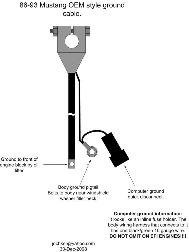

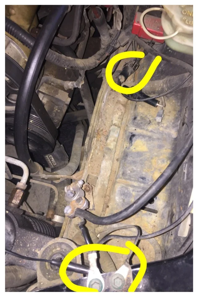

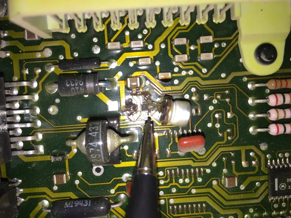

Hello, I'm recently bought a 1995 mustang gt automatic 5.0. It randomly threw a check engine light while on the highway but drove fine up until I parked it for two weeks. After sitting I tried to start it and it took a long time to start and it won't stay running. If you rapidly hit the gas it dies but if you do it slowly it will rev up but sounds as if it is missing. Checked spark and all cylinders were good, injectors all have 12v with key on, 40psi fuel at idle and key in Eng off. Cel is on the whole time, when I jump the computer test ground terminal on the eec and the sti terminal and turn the key on nothing happens. The cel still stays on and no flashing occurs. I've ohmed the computer test ground on eec all the way to the computer and all was good, 0.5 ohms. I checked the computer internal ground by ohming pin 40 to 46 and 40 to 60 both good. I've done a few more thing but don't recall. If someone could please steer me in a direction to at least pull the codes that would be great. Thank you
