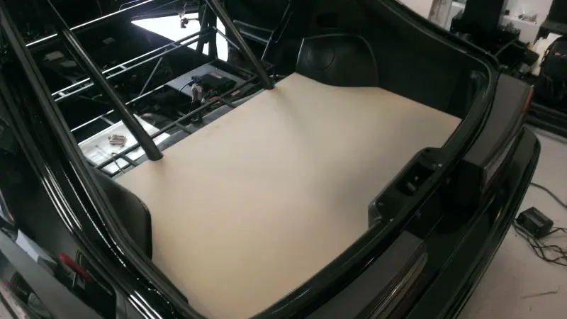

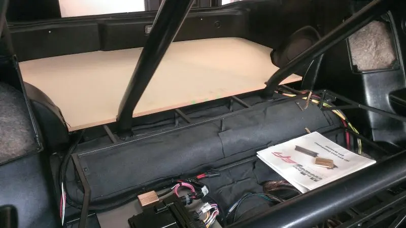

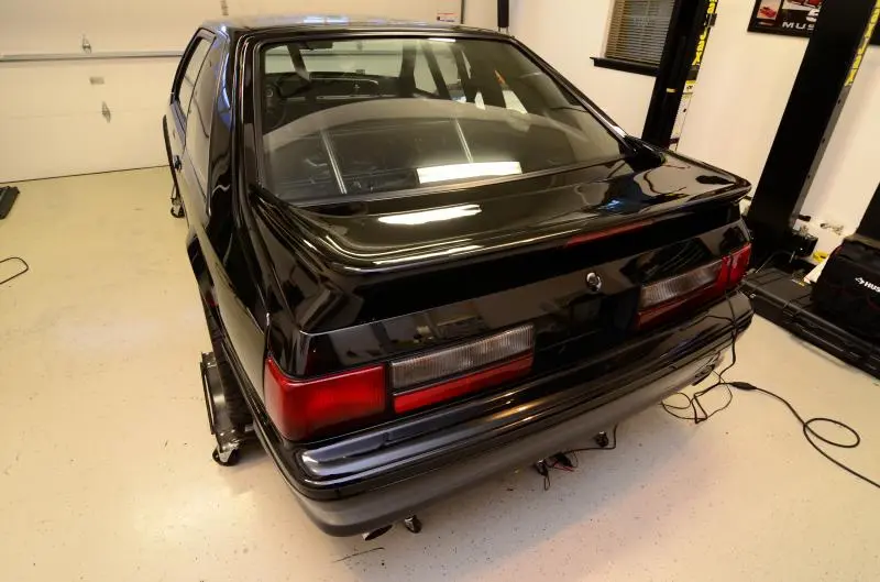

I decided to switch gears a bit and work on the MDF install for the floor in the hatch. Picked up a sheet of 1/2" stuff from Home Depot tonight. I made a cardboard template, trimmed it, trimmed it again, trimmed it some more, and then trimmed it one last time. I transferred the cardboard to the MDF and cut it out with my handy dandy cordless jigsaw. Cut it like a hot knife through butter. Here are a few cell pictures.
I also set the saw to 45 degrees and chamfered the bottom edges because of the angles of the plastics in the back. If I didn't chamfer it, the top of the MDF would not go to the edge of the panels.
@madmike1157, you do that A/V thing for a living, so maybe you can assist me. I'm putting that self-contained subwoofer in the spare tire area. I plan to have it facing up. Would it be beneficial for me to drill some holes in the MDF where the sub will be sitting? The carpet will still go over the top, but I thought some holes in the MDF would help some. I'm not too schooled on the acoustics of subwoofers, so I'm not sure what the best thing to do is.
