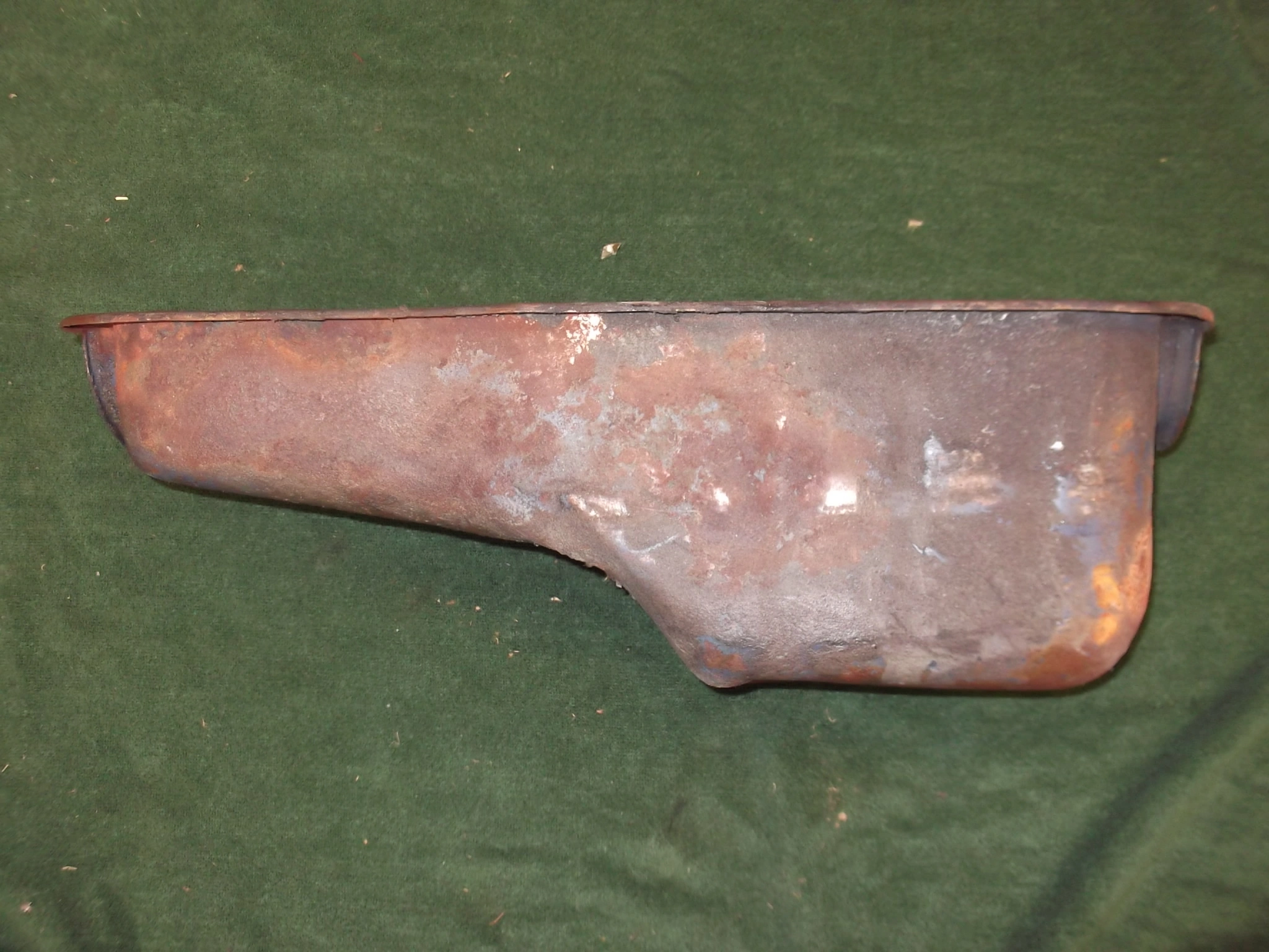

K KenC New Member Aug 31, 2016 2 0 1 Aug 31, 2016 #1 Aug 31, 2016 #1 Hi, can anyone tell me if you can use a Cobra cast aluminum oil pan like the GT350 pan with a 3.400" stroke in a 289 block? Thanks in anticipation

tos Founding Member Apr 27, 2001 896 68 59 Cincinnati Ohio Sep 1, 2016 #2 Sep 1, 2016 #2 Should be able to. I had a stock pan on my 289/347 stroker with no issues. The only issue I had was a slight clearance issue with a windage tray but a little bending fixed that. I switched to a canton 9 qt pan just to have that extra lube.

K KenC New Member Aug 31, 2016 2 0 1 Sep 3, 2016 #3 Sep 3, 2016 #3 Hi tos, thank you for the info, just to confirm the stock pan that you had was a deep front 289 pan like the picture?
