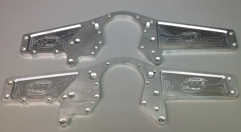

I need motor mounts. What are your thoughts on what to use for this application?
Motor Plate......
