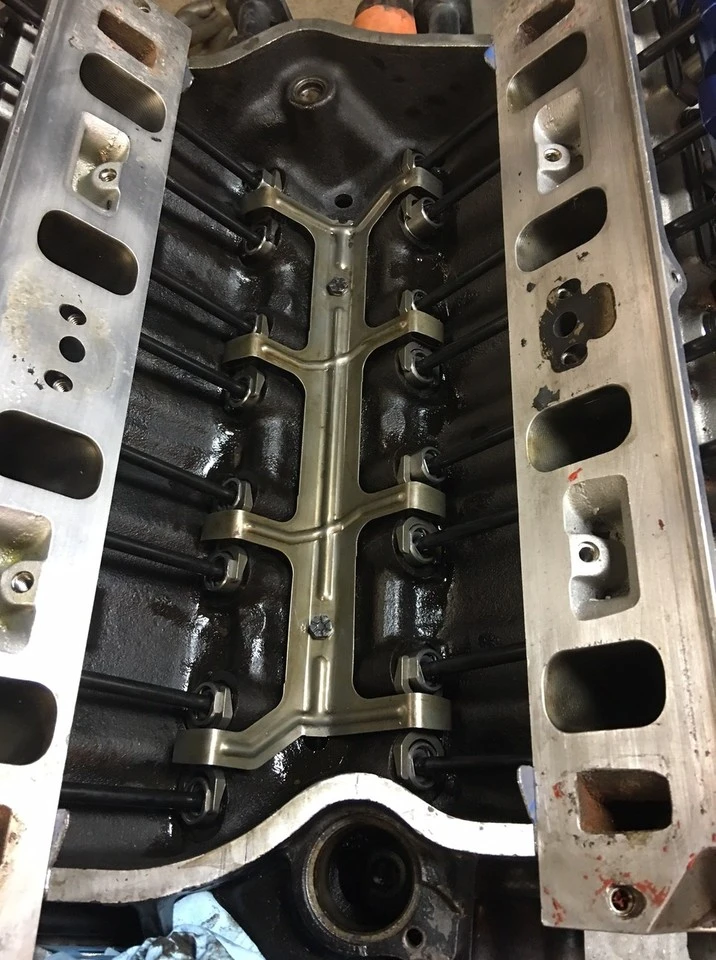

First, I got the valve train finished - FINALLY...

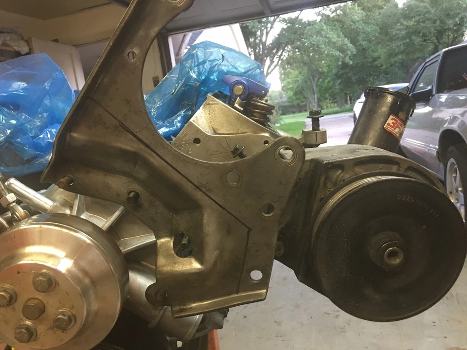

On the way home, a buddy gave me some bolts and the A/C bracket I needed for my science project that would become a 351 A/C bracket.

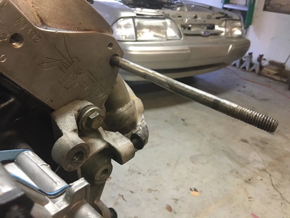

I still needed the stud that the PS pump hangs on, so I decided to get creative and just made one. Voila!

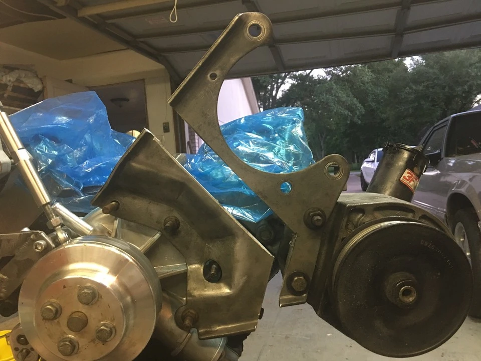

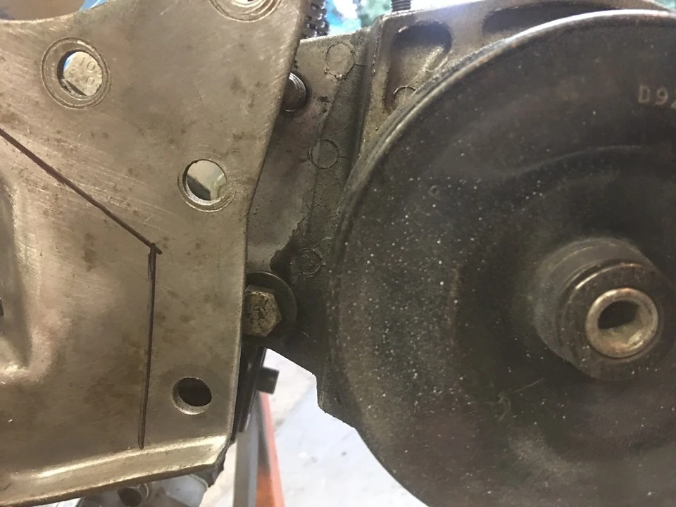

After putting the parts and pieces on, this is how far off we were.

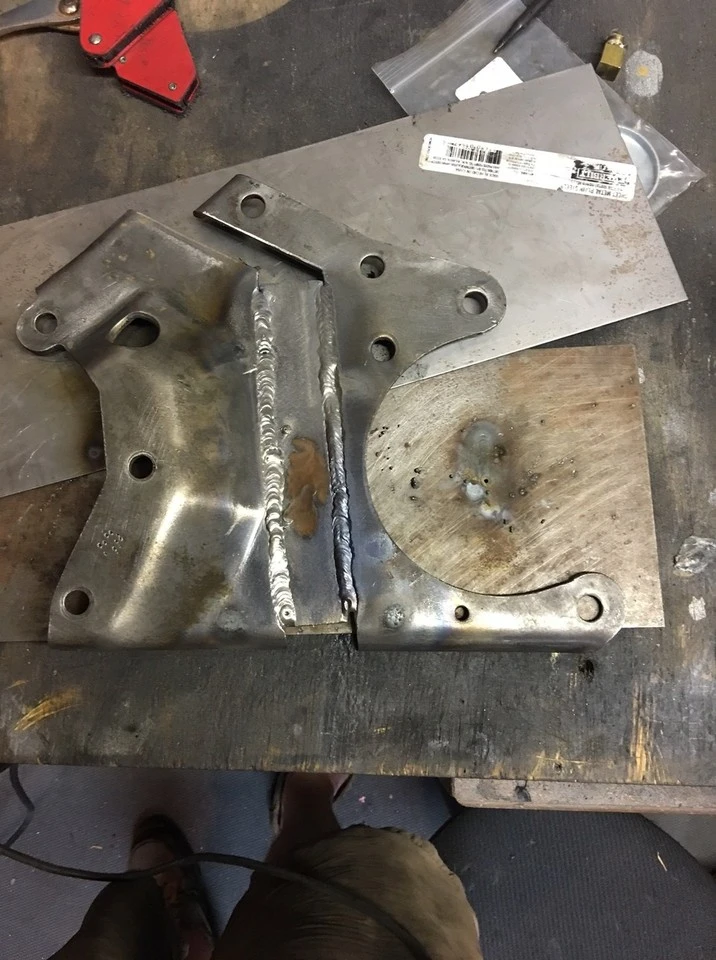

Time to cut!
And here's the two piecs bolted into the respective locations.

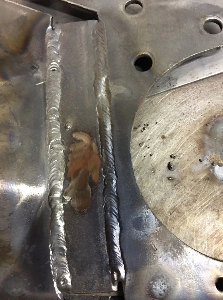

From there, I tacked some scrap metal between the two pieces to hold the dimensions. I cut some flat stock and started welding it in.
By the time the last pic was taken, the welder was at the top of the duty cycle and the leads were getting HOT so I shut it down for the night. I will finish it up. The little TIG did pretty well overall, it's me that needs the help, haha. My helmet lens is garbage too and difficult to see out of, so I need to replace that.

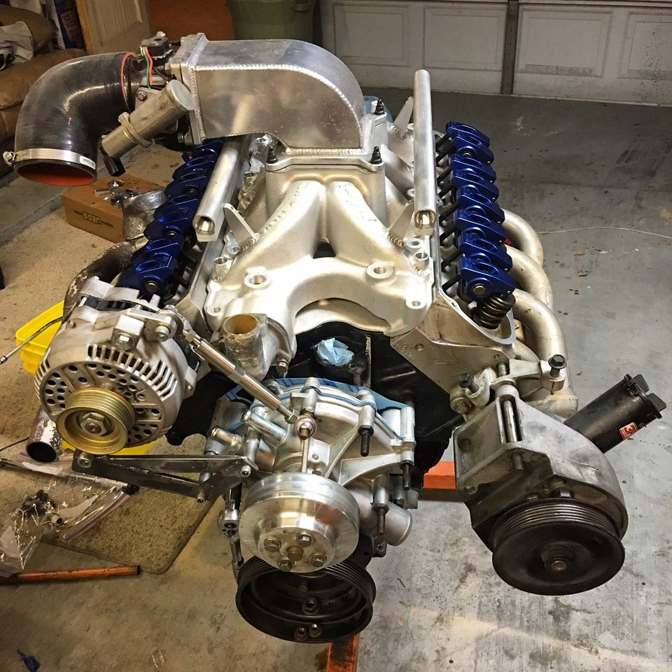

Overall, I am very pleased. Still to do is tighten down the rockers and install the intake for good. Once the motor mounts get here, I can drop it in and get to fabbing on the hot side.
Here's the motor as it sits too. So close!
