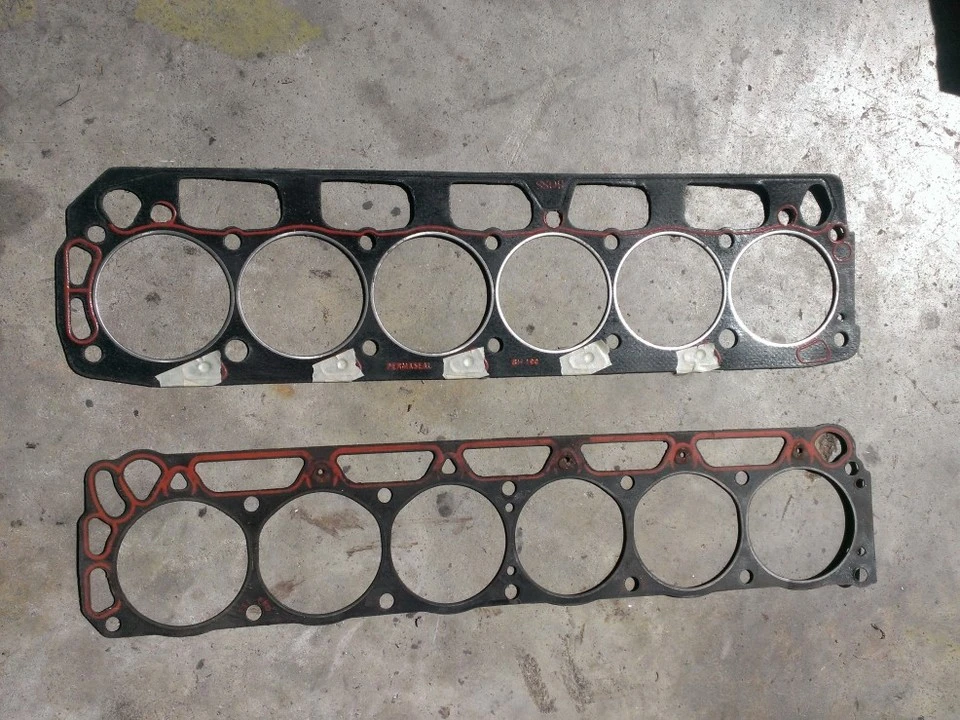

Here is a 300.00 dollar MLS HG for my engine. At the top of the pic is the area where my leaking is occurring. I can have this HG built for me and modified to suit my specific engine (all the little holes on the bottom aren't necessary, and there needs to be a hole added above cyl #1,3, and 6 for a water passage into the head.
This is the stock Felpro version of what my stupid 250 looked like (on the bottom) and the Aussie Felpro for the Crossflow 4.1L that I used as a template to build my JB Weld-a-block.
The problem is that the lifter galley has no bolts to tighten that outside sealing edge down to the deck surface. I smeared Hondabond all along that outside perimeter, and everywhere else you see a red ring on the upper gasket. But I still have a leak.

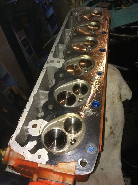

The bluish stuff is Hondabond. Looking at the pic shows that Mike screwed up. He didn't think to seal the inside of the lifter galley. (But then again I figured that oil would find its way back into the engine on the inside) The oil that is all over the opposite side is the oil that drained down the head stud boss on that side. Alot of it managed to find it's way between the gasket everywhere.
I'll take credit for that, what I want to know is how then did it get outside? That bead of Hondabond was on both the head surface, and the deck on the outside
Because there isn't any O-ring set into the block, or a receiver groove cut into the head, I bought a special gasket from SCE that has a wire ring sandwiched between the layers of copper, You might be able to see where that O-ring "printed" the head.
Know what I'm thinkin' though? I'm thinkin' that O ring held the head off the deck far enough to not allow the sealant to do it's intended job. Either that, or the thin, "skim coat" layer of Hondabond wasn't thick enough.
Oil is everywhere though, It was just as wet under this gasket as it was on top. I don't know what to think.
The problem w/ the Hondabond, is that it dries in a minute. By the time you get the deck coated, it's already dry where you started. Do the head, and by the time you're ready to set it, it's all dry. I'm thinkin' I want something that stays tacky for at least long enough to get it assembled. In retrospect, I'm thinkin' I don't want to have to put any sealer on the damn head gasket at all. I looked at the MLS gasket that I can have built. I'm concerned that where they'll have to add holes for water passages into the head, there won't be any provisions for sealing, like the embossed ridge you see on the outside edges.
Potential leaks if you ask me.

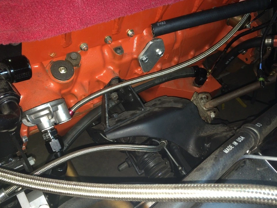

I did take a pic of the -12 that feeds my oil pump. I'm thinkin' I'm screwed w/ that set up. My only hope is that right now w/ 6 qts of oil in there, and the oil still isn't touching the top of that kick out, Maybe if I add another qt, it'll force oil up and out based on gravity...
A trick I was shown with 1300L weatherstrip adhesive is brush it on and let it dry, which happens pretty fast. Just before you want to stick the part, take a rag dampened with tolulene or naptha and wipe it across the adhesive just enough make it damp/tacky again. Then stick the part. If it works like 1300L, it may never come apart. I know nothing about hondabond so have no idea if this will work, but something to think about.
An old trick with dry oil pumps was to pack them full with Vaseline to get them to prime. It fills the gaps just enough so that the pump will pull a vacuum. Ideally, the external oil pump is mounted below the oil level in the pan.

#1. I learned about hydraulic fluid dynamics. ( Actually, I learned that the pump will be a totally different beast, once it has oil, as opposed to air inside the gear drive). I called the owner of Aviaid and he had no problem w/ the fact that oil has to rise a full 7", then travel 22" over to the pump...........Once it has oil in the pump.
For the first time in order to make that happen, I'm gonna have to be a little unorthodox in my approach, and "back fill" the pump from the outlet side to fully purge the air out of the pump, and the feed line. Once that is done, I should be good.

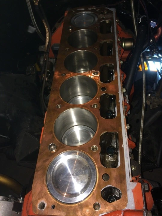

On #2, The story is a little different there. Through a combination of installer error, and maybe a little more liberal approach to properly coating the head gasket,....I'm gonna give that P.O.S. another chance.
The oil all over the deck, and head probably came as a result of two things:
#1. That fire ring that seals the chamber is stainless steel. It takes 75-80 ft lbs to fully seat the thing, PLUS a heat cycle of the engine, PLUS a re-torque of the head studs after that.
When I filled the engine w/ oil, the head gasket was only in "stage 1" of the torque sequence, and was only at 30 pounds. The guy at SCE guesstimated that the fire ring hadn't seated at that setting, and the rest of the gasket was still standing proud of the deck surface. Oil would be free to run everywhere if that was the case.
Plausible.
#2. When I backed out the head studs, and oil in the stud boss would've ran everywher after the fact given that the head was completely loose at that stage.
Likely.
#3. I didn't coat the surfaces adequately w/ that stupid assed Hondabond.
Absolutely.
So here's the plan: The engine is tore down to the stage that if I HAD to, I can remove the head fairly easy if that piece of crap doesn't do right this time around. I'm gonna coat the entire HG w/ Copper coat (twice) and use the Hondabond around every suspected drain hole and water passage. and I'm gonna put that sorry bastard back together. Then I'm gonna torque that head correctly, and completely before I add qt's #7 and 8 to the pan.

Mike, I work on a lot of general purpose steam turbines in the refinery that employs me. Some of them use an external oil pump on the outboard end of the turbine shaft with an oil sump 24-30 inches below it. A trick we use to maintain prime is to install a very lightly sprung check valve in the suction line to hold oil in the line. We can always tell when the check is bad, as the pump won't keep prime. Don't know if this can be applied to your setup, but may be worth looking into?
According to dude, Once the gears are wet, the pump will make enough suction to re-prime itself.

I'm thinkin' the Hondabond is out. When I stopped at Advance to buy the coppercoat for the HG, I also bought a tube of the high temp copper RTV for the turbo manifold to head gasket.
I have been reading that the Hondabond doesn't work for alot of guys that are using it (as it's supposed to be used), and the have switched to either Ultra-grey, or some other color RTV to get the job done.
Honda bond dries to a hard rubber consistency, as opposed to RTV which is obviously more "spongy". I guess the thinking is that the harder rubber consistency will be less likely to "push" when compressed, or when the head moves around as a result of heat/cold.
The problem w/ the Hbond, is that it dries so quickly, you cant get it applied to all of the surfaces you need to and it still be "wet" enough to do the job IMO.
I have coated the HG w/ 3 coats of coppercoat, and I'm letting that dry overnight. I don't know whether it's gonna be black, grey, copper, or blue-grey, but I gotta decide what I want to put on the deck and head to seal this thing by tomorrow, cause I'm puttin that b itch back together.
