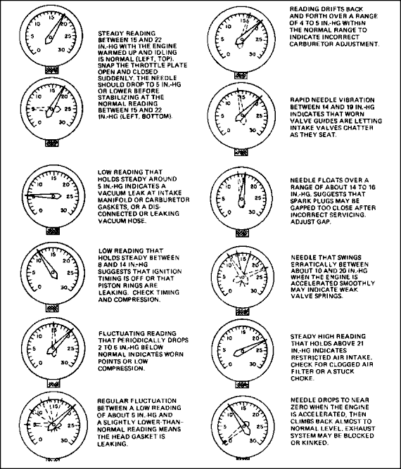

You're welcomed! That's largely true, though if you're hunting / surging obviously it's going to move around a bit. It may not be a bad idea to run the cylinder balance test if you haven't already. Bad plug / wire, weak injector, manifold leak, stuff like that would probably show up with that test.
