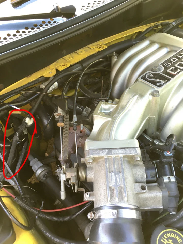

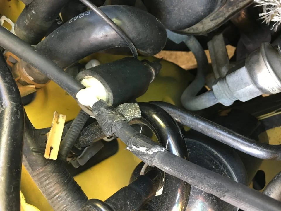

B Blaine Polhamus New Member Sep 7, 2015 4 1 1 Apr 24, 2016 #1 Apr 24, 2016 #1 I need help finding out where this vacuum line leads to and which line it is. The previous owner put duct tape around it and it's very dry rotted. Thanks!
SableSal Member Sep 17, 2009 295 3 19 Fresno, Californ-I-A Apr 27, 2016 #2 Apr 27, 2016 #2 That hose leads to your charcoal canister which is located inside of the passenger fender well.
2L8ULUZ2 Will kiss Moderator ass for title Founding Member Sep 24, 2000 3,033 14 99 WNC Apr 29, 2016 #3 Apr 29, 2016 #3 SableSal said: That hose leads to your charcoal canister which is located inside of the passenger fender well. Click to expand... ^ This. Mine was the source of a bad vacuum leak that I chased for a long time.
