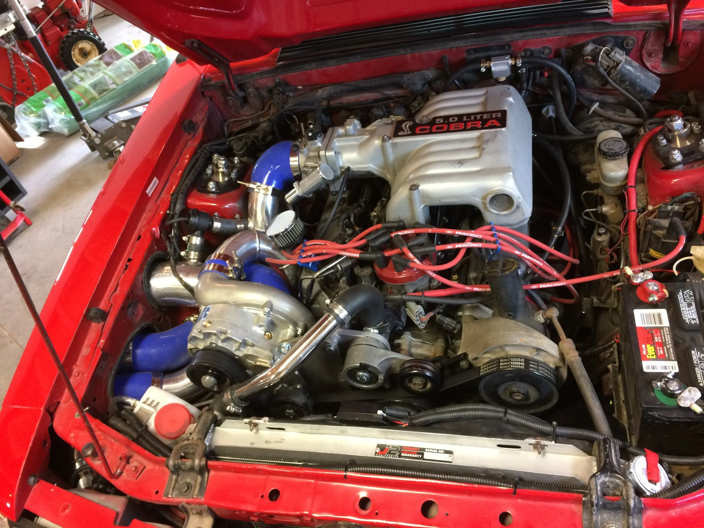

Hi so I'm interested in possibly getting a vortech, the new V-3 si black, since my dreams of a KB are more than likely never gonna happen. So this version is the more user friendly and more commonly used correct? Does one version over the next say v1 or v2 in this case make more boost or do these three all make about the same just at different rpm ranges? If I remember correctly you can change out the pulley to gain more boost is this right? Also what are the thoughts on the intercooled versions is this overkill or worth the extra bucks. So I'm no track car, just a weekend streeter and car shows etc. car has been garaged for last 13 years and it's time to bring her back to life. Has common bolt ons on stock 91 block. F-303 with 1.7s. Recently picked up a tubular GT40 upper and lower with c&l 76 cal. For 24lb inj. along with 24lb inj. I remember c&l being a big name back in the day but hear they aren't great but grabbed all that with rear upper and lower control arms for 500 so couldn't pass. In the process of choosing some aluminum heads stuck between a couple. Sorry for long write up.
