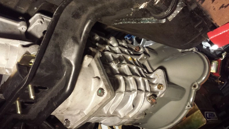

yea mine was also for a TKO-600 originally and i used a adapter to set the driveline angle and use the stifflers crossmember. Interesting the the 600 goes the other way.
Mine was for my t5 I just used the tko kit that came with it when I bought it
Sent from my iPhone using my fingers while my auto correct makes me seem illiterate
So I guess I'm the only one using a stock crossmember with a tko these days?
Other than the looks, is there any real good reason to use the stiflers over a stock one? I can't see it really being any lighter.
It's a nice solid piece and doesn't have anywhere near the flex my stock did
I used the stock one for as long as i could, i switched to the stifflers cause the stock one wouldnt work with the new transmission. With the fragile TKO case in my setup i actually preferred more flex at the transmission mount, that my have been why i broke 2 transmissions pretty bad and never cracked a case.

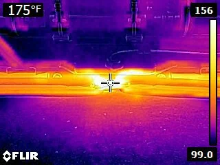

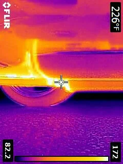

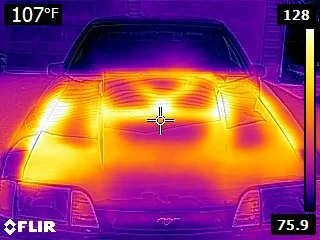

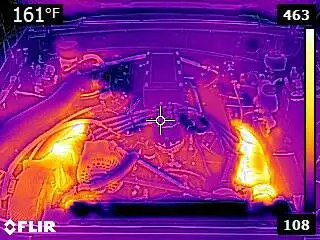

Hot stuff!
This was after a 15 minute drive without much hard acceleration, so things aren't as hot as they can be. The back side of the mufflers were into the 200 degree range. The tails were pretty hot as well. I definitely need to get the lines away from the mufflers and I may look into some stick on reflective sheets to help insulate the tank near the tail pipes. The IRS pipes aren't super close to the tank but they do surround it.
The fuel lines in the bay will be getting some heat sleeve treatment. I still need to get the lines in the frame rail though.
