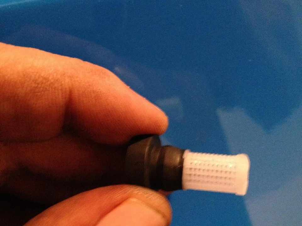

So I took the 8 or so 5.5mm bolts out that were holding the bottom black plastic splash guard out and go perfect access to the reservoir and sprayer pump. I disconnected the line and saw that the pump was spitting a little bit out but nothing anywhere near where it is supposed to. I then disconnected the pump's electrical and pulled it out of the reservoir "Fully expecting to get a face full of washer fluid as the container was full and nothing happened." So I removed the 3 bolts and saw the rubber grommet/filter for the pump.

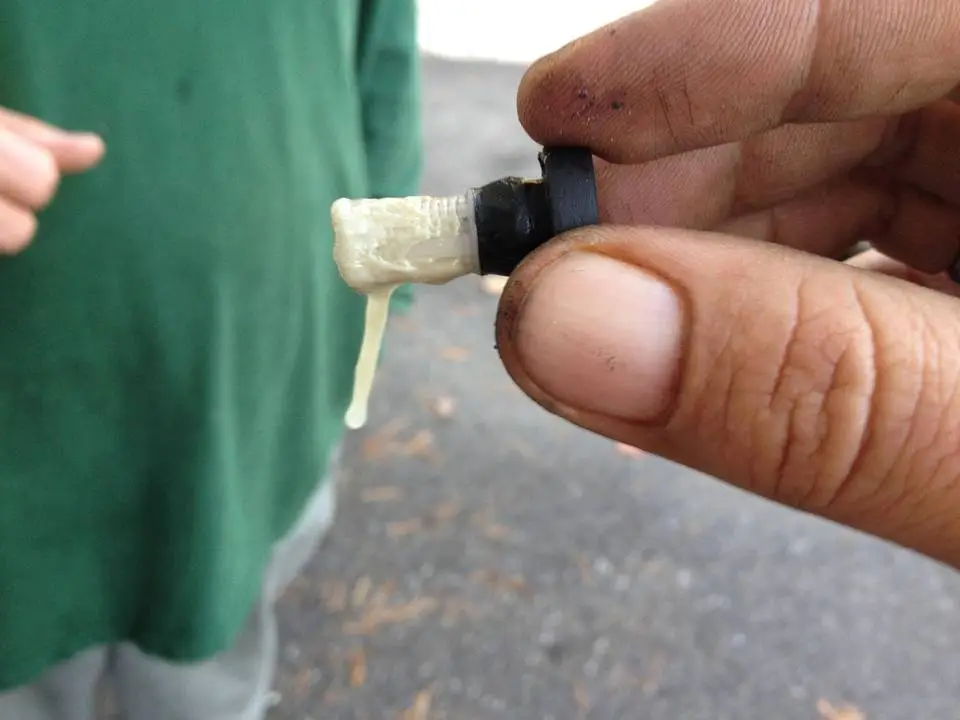

Let me just say this I WILL NEVER USE GREEN BUG WASH AGAIN!
Pics below of the plastic filter.

That stuff hanging was like the worst bit of sludge I have ever seen. I dont even think I want to know what is in that bug wash. The history of the car's washer resevoir is pretty tame. I bought the car in Florida moved to key west for a year and moved back up to NH a few months ago so I have had maybe a total of 3 gallons of washer fluid go through this car. 2 blue and 2 green bug wash.
After a good amount of cleaning with hot water, toothpick, toothbrush, and compressed air this is the final result.
The end result is that my washer sprayer is now working again yay!
