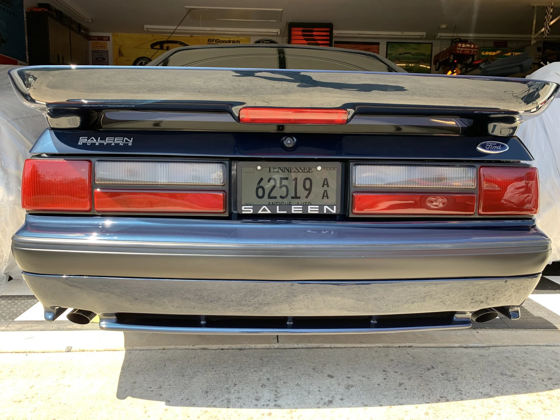

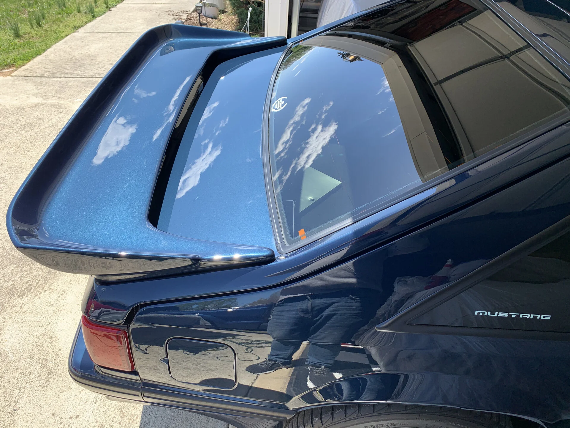

Yep. Thin rubber gasket cut to fit base of spoiler. With a little yellow glue to hold itJust curious, do you use anything between the spoiler base and the boot lid?

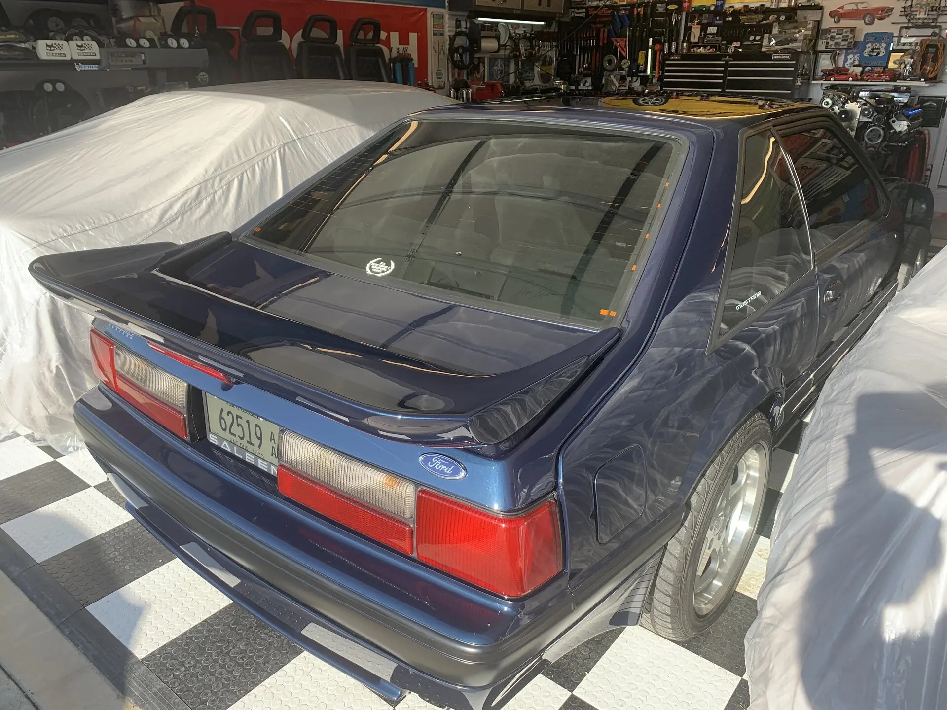

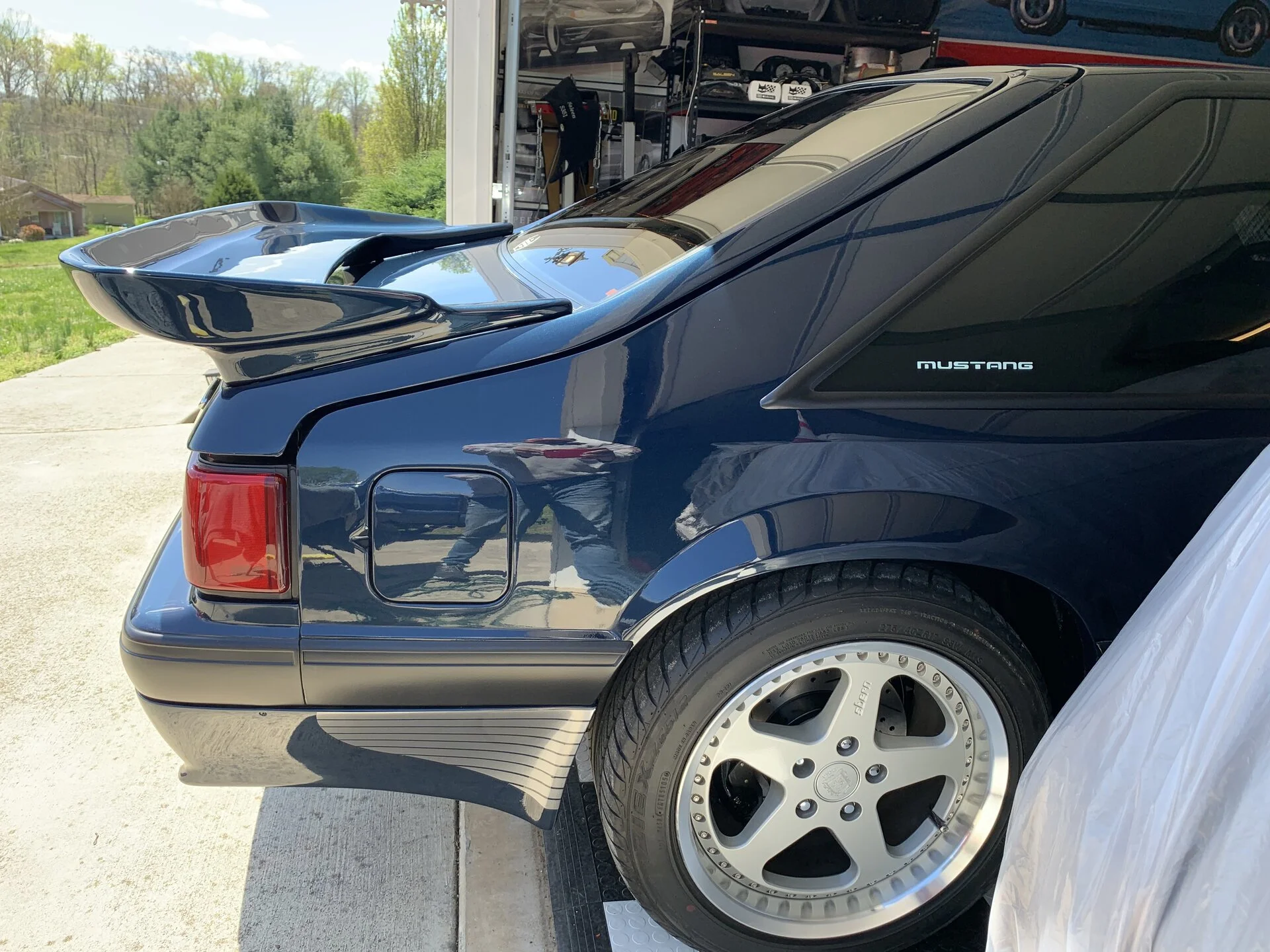

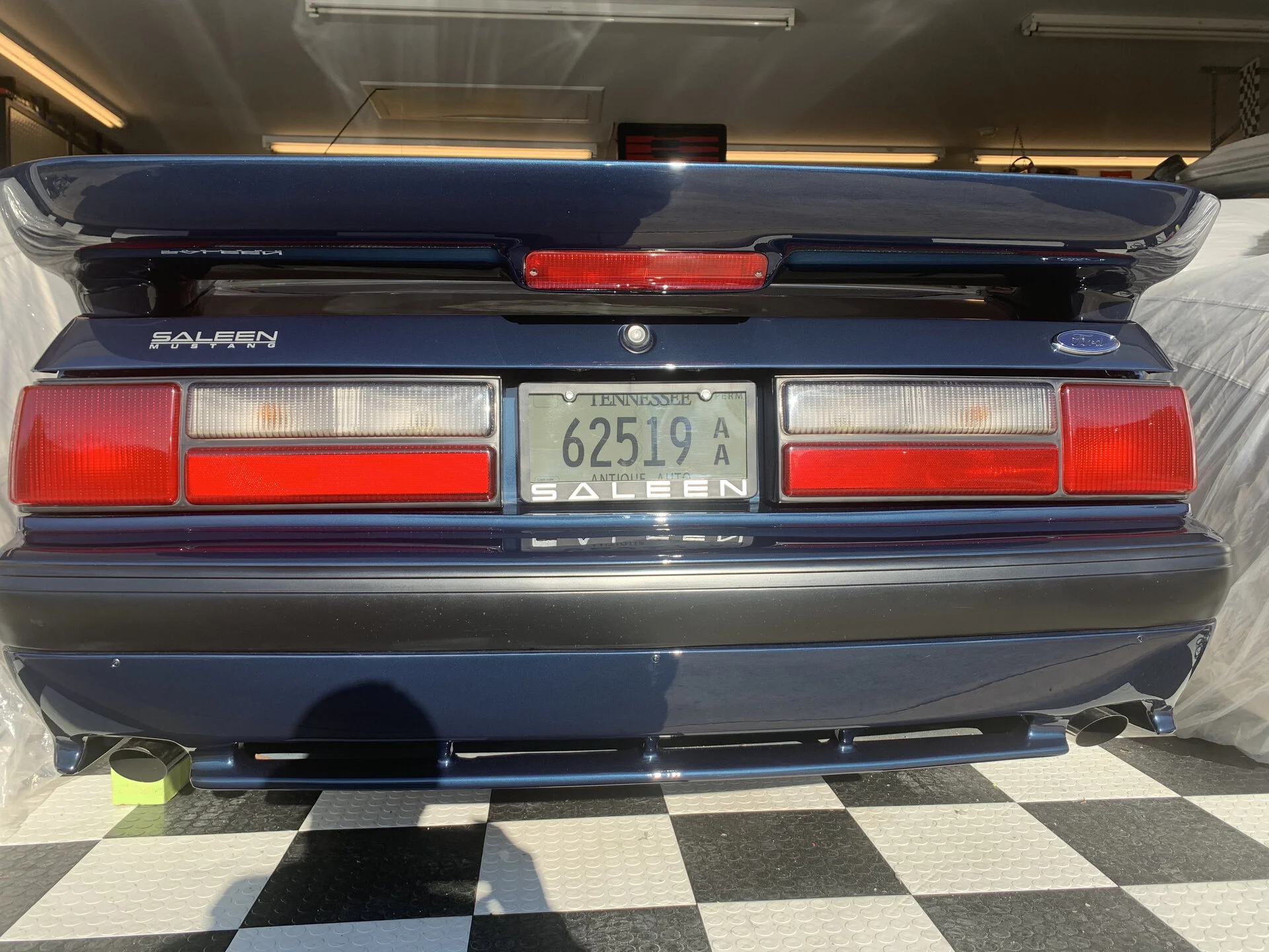

Never satisfied. Always shooting for perfection. Yea paints better than any out there or when it was new but I’m still not satisfiedBased on the little I know about you from these threads I would totally believe that you're going to repaint it, but why?
Thanks! It is nice. Show quality and all that but I can also take it up a level by blocking and respraying the whole carAnd I was just about to comment on the nice paint.
You know how I am. Perfect can still be betterI’m actually shocked it took this long to be announced. It is a beautiful car though.
So your just blocking down this paint...... no stripping down to metal?Thanks! It is nice. Show quality and all that but I can also take it up a level by blocking and respraying the whole car
Yep. Blocking it down with 600 grit and leveling it flatter and doing fresh base and another 6 coats of clear. Probably take me a week or two. Doing another car would be months of body work to get to this point. Once a body is done its straight and your just perfecting the paint finish.So your just blocking down this paint...... no stripping down to metal?
Sucker's bet. Of course, you are. Can even see the reason in this image.who would believe me if I said I’m going to repaint the entire car ?????
