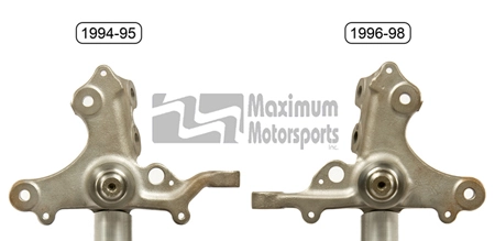

If you already have a bump steer kit, tie rod ends and bushings to relocate the steering rack, installed can they be utilized to eliminate the bumpsteer if using 96-04 spindles?
No. Yo have to drop the rack down further than what the offset bushings typically drop. They help, but you need about a 3/4 drop.
Basically the location the tie rod end needs to be is physically inside the tie rod mount of the 96/04 spindle . Since that’s impossible, you just shouldn’t use them
Perfect shot of the dropped tie rod mounts for the lowred steering rack on 96+

LMR wouldn't sell me the 5 lug/4 wheel disc brake kit WITHOUT the newer spindles which was another reason why I decided to piecemeal the kit together. Other than the item #18A964A (front 13" rotors) part number fiasco, the piece together process was fairly straightforward.
I think it’s just a numbers thing or only the newer spindles can be sourced.
2 years vs 9 years of the newer spindles. Unsure if the 04 spindles are still able to be ordered from ford. Prob not.

LMR would not sell me the kit without the new spindles. Meaning everything but the spindles.
LMR is a good resource, and they have some good sales at time (10% off, etc.), but nearly all of their stuff is Chinese made and they can be finicky about parting up items.
