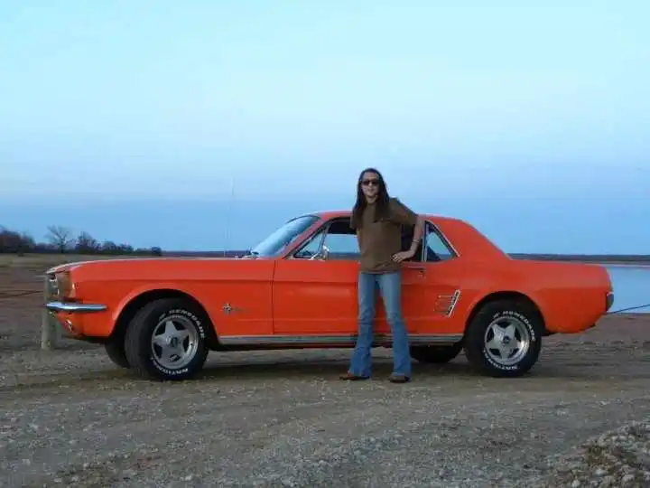

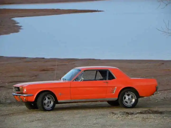

I am new to the forum, as well as to the Ford community. To be honest, I have always been a Chevy person, but my daughter wanted a Mustang so after much hunting and searching that is what we finally purchased.... a 1966 Mustang. Forgive my ignorance as it regards to Ford products.....
So I have many questions regarding this car. So I might as well get started....
The car has the straight 6 engine with an auto trans. The engine and tranny are newly rebuilt. However, the car does not have power steering, air conditioning, etc. However, someone DID start the A/C process so the car DOES have the compressor installed (which I figure I will probably have to replace). None the less, at least the bracketing and belts are there which is a start. If this were a chevy, I would know what car(s) I could look to to strip parts from... but not being a ford guy, I have no clue where to start. Likewise, there is no power steering. Again, if it were a chevy, I would know where to start. Being a Ford.... yeah, not a clue.
So, I have a compressor, and a friend of mine gave me the under dash unit. So now I need the evaporator and everything inbetween. Can someone tell me what kind of car(s) I can look to, to find all the brackets and parts I need?
Also, as I said, the car does not have power steering. What car(s) can I look to to strip all the components I need to make the conversion?
At the moment, it still has the drum brakes on the front which I DO plan to replace with disks and have already checked out... just putting it off for the moment.... till the other stuff is done.
Sorry for being such a total Ford newbie.... I was raised in a Chevy family. I have always wanted a Mustang tho.... kinda cool that my daughter picked it! I am just so lost to Ford products tho. I could really use some help!
Thanks in advance for your help!

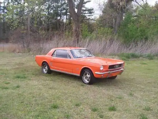

Another pic......

I've always loved that color...very nice mustang. mustangsteve.com sells bracket kits to adopt late model mustang disk brakes onto your 66. the six that came in your car was common to fords of that era....spend some time in the yards....u can score much of the under hood stuff from a falcon maybe a maverick etc

You'll forgive me... I don't even know what other cars Ford made in that era lol. But the suggestion of a falcon and/or maverick helps! I will start my hunting with those.... Thanks!

By the way... thanks for the kind compliments. Do you by chance have any clue what color code that Orange is???? A friend of mine who paints cars (as a hobby... and yes he is good) has offered to repaint the car... It looks good in pics, but really needs a new paint job. I would like to use the original Orange.......
Sorry, he is a chevy guy too... lol. So he doesn't have the info on Ford paint codes....
in 65 the color would have been poppy red, code 3 ,i dont believe the color was carried over to 66, if it is the origional orange check the door tag ,if it has 5 didgits
it is a special order color usualy from the san jose plant in california ,known as the
rainbow of color cars,flower power orange, they had some prety wild colors
whammo77
