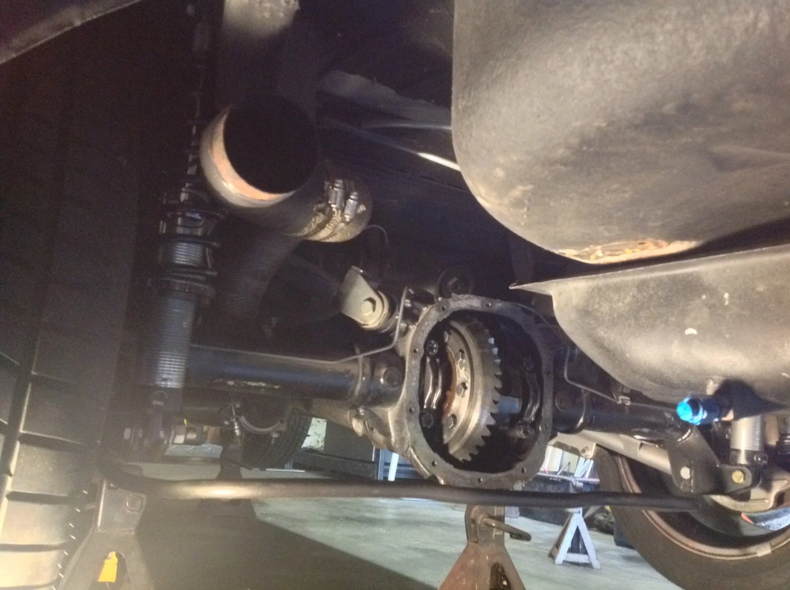

The ring gear bolts loosened on me last year and some had even fallen out and were laying in the bottom of the center section of the housing. Back then, the car always made a clank noise when I put it in reverse, or I dropped the car in 1st gear at a light.
I think it's doing that again.
When I fixed it last year, and added the girdle, I just torqued the bolts w/o any thread sealant. All other times, this procedure had always been adequate. On the monster for some reason, it ain't.
So, caution to the wind, I'm driving it. The car doesn't have 50 miles on it since the rear end fiasco of last year. Those damn bolts will have to hold me for one 50 mile rt drive.
I'll deal with it on Monday when the car goes back up on jack stands for the muffler addition.

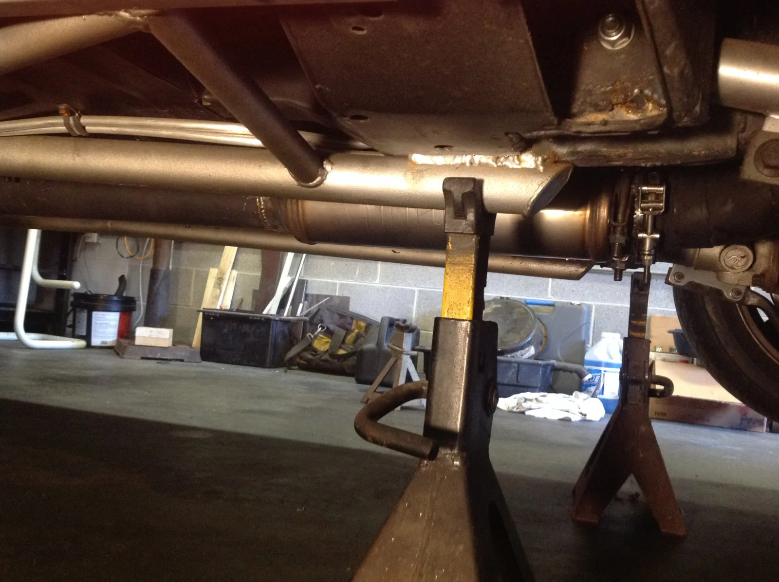

I called Magnaflow and asked for a recommendation. Dude says I should leave the loud assed muffie in place, and put one of their oval pieces in between.
The one he recommended looks like this:
Cost on it is 91.62
409 stainless steel straight through perforated tube w/fiberglass packing.
Then there's this:
409 stainless steel, Straight through perforated tube surrounded by fiberglass packing...
35 bucks.
Now I know,...I'm on record for stating that the high road is a road of no regrets.....and more often than not, the low road is full of ruts and potholes,......but it's a freakin muffler.
How much different could it possibly be?
I have option B on my car now. I really think they’re house brand mufflers made by magnaflow.

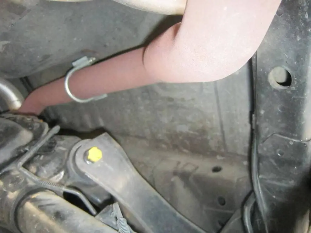

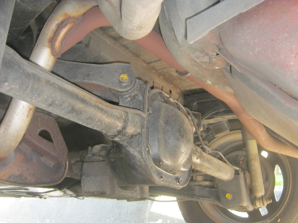

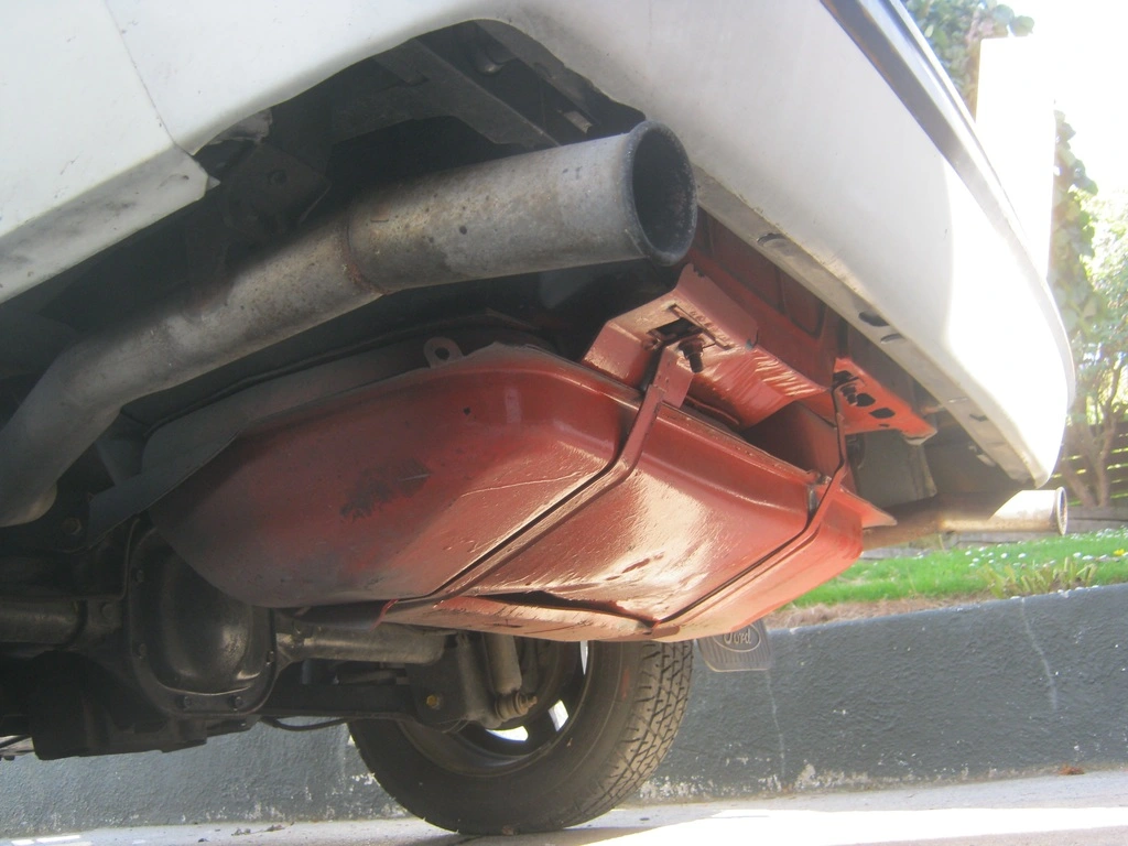

Dual Outing the exhaust will help. The best thing is splitting the pipe at the axle, and Y ing it to the stock V8 ensamble to take it out of E flat.
My 81 Mustang had the wolds most ordiable X hasut.
non standard y piece to clear the rear brake line without touching it).
My Cortina V6 had the same mid range baritone drone, but dual piped with glasspacks and stock headers and dual tail pipes, it was much quieter.
adding an IHI turbo made a drone prone 4.1 Cortina Exhaust silent.
The old live axle Montaineer Explorer 5.0 XLT / EB/ Limited exhaust Y piece makes a great way to turn two twin pipes into four cut price ANSA outlets.

Traction loc was rebuilt after I had the loose bolt incident last year. I also upgraded the stock damaged rear cover where a ring gear bolt shot through when it got flung at the cover) to a girdle style.
Drain, inspect, refill (assuming you find nothing wrong), you could get that done in a night or two after work? Youre starting to sound like me... Torque box reinforcements have taken me 6 weeks and counting.

Well what was once behind the axle is now in front of it.
That almost pointless muffler is now just a check point to try and control a minor amount of the racket coming out from behind the Monster now. The other muffler will go behind, and more than likely, I'll add some resonator kind of tail pipe behind that.
You can see where I cut the existing muffie from the tail pipe. I've hung it there so I'll be able to mock up, and tack where the new one will go when it comes in tomorrow. ( not that I'll work on it, I have to work till 7:30 on Tuesday).
But who knows, maybe I'll have a wild hair.
I also removed the rear cover to see if I have loose bolts....I haven't checked them yet.
As many times as I dragged my ass out from under the car today re-orienting the exhaust, I got nothing left. It's a good thing though, the rear end oil was sludgy in the bottom,...I'll clean that out, and put fresh oil in after I get around to checking if the bolts are tight.
