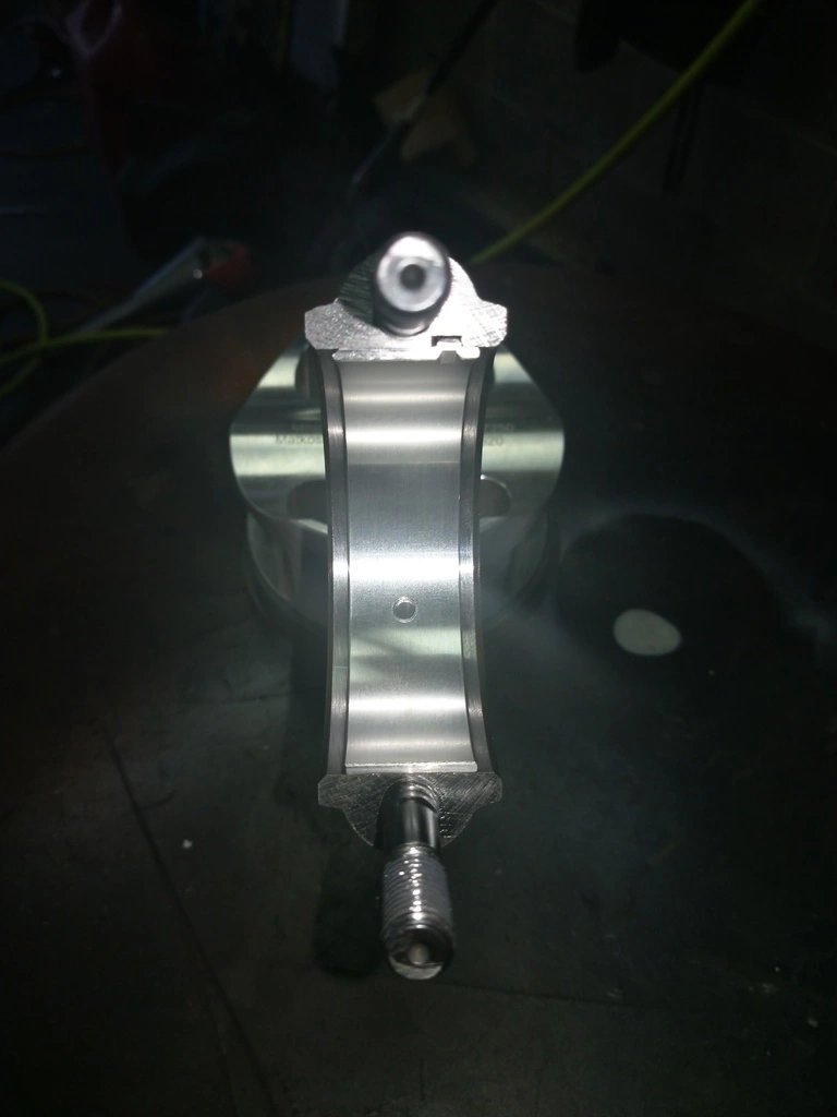

I pulled the block back out of the car so that I could clean it up, and assemble the shortblock. I had to do some errands this morning, so I really didn't get started on the thing till about noon,...but I got the pistons back in the engine regardless. I decided to use 302 rod bearings..they are markedly narrower than the 250 bearing.
Significantly narrower.
The old bearings were riding on the crank journal radius. Not supposed to be a good thing. These will never do that.

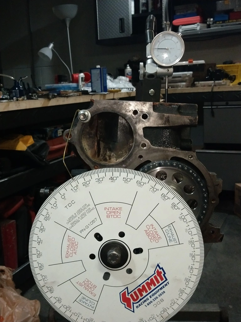

I installed the cam and lifters, then went about the task of trying to understand the degree-ing in process. I put the cam back in exactly where it was when the car was last running,...Back then I used some process from Comp cams, and determined that the cam is in at like 110.5...which makes it in at 3.5 degrees advanced..This time around I used Lunati's process......It's completely confused the snot out of me.
According to the Lunati instructions, I'm supposed to determine TDC and set a pointer wire so that the degree wheel reflects TDC.
Position my dial indicator so that it is vertical so as not to get a false reading, and zero it out. The rotate the engine in a clockwise rotation until the dial indicator reads .050. Then take a reading on the degree wheel. (This is where it all stopped). After I take that reading, I'm supposed to compare that number to what's on my cam card...
So,....The degree wheel says 13.5
The cam card says that at .050 checking height, it's supposed to read .39 13.5-.39 = 13.11
Does this mean that the cam is over 13 degrees advanced? :shrug: Does that in turn mean that the cam is in at 100.9 instead of 114?:shrug::shrug:
When I put it in the last time IIRC I was somehow considering centerline instead of advance...I've only done this process once in my whole lifetime before this, and that was done when the Monster's engine was installed the last time. Because we drilled the cam to allow a SBF timing gear to fit, I think it may be off a little. IIRC, I had to put the cam gear in one whole tooth backwards, and then advance the crank gear 8 degrees to get the thing to come into spec. But I marked the timing set before I took the engine apart to be sure to get it back to where it was, and that is where it is. And when I look at all of this,..It looks like the dots are all perfectly aligned....
So,...I guess I'll be dicking with this tomorow.

When you get the .050 lift on the intake lobe you compare that to the intake opens degrees on your cam card. Their example on their website is 8* BTDC. There's no way to be accurate enough to see .39*.
The way I've always understood it, is you find the exact TDC, then rotate the engine till the intake opens .050, compare that to the intake open degrees. If your intake opens at 13* BTDC and the degree wheel is pointing at 13 +- 1 degree you're pretty good. Otherwise you have to figure out if you're advanced or retarded (this is a hanging curveball I fear) and proceed to adjust from there.

Ok...It all came back to me after messing with the thing again today.

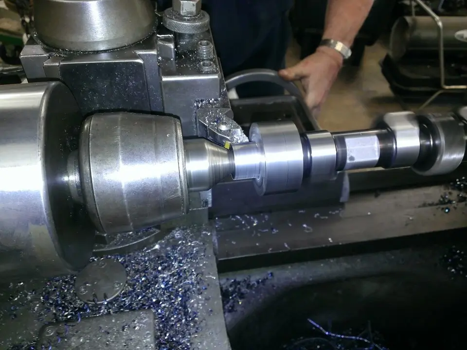

When I got the cam from Australia, it was fitted for the stock 250 timing chain. There are no aftermarket 250 timing chains. So that meant that I would have to either use a crap, non-adjustable, non-roller, single row timing chain, or modify the cam to accept a SBF piece. Had I known that I'd have no options when it came time to buy a timing chain, I would've had the cam guy in Australia modify the snout to let me use a SBF gear. But I didn't.
That meant that I'd have to modify the cam myself. The problem with doing that is that a billet cam is hardened after grinding, and that hardening process makes any future machining, or drilling next to impossible.
I took the cam to a machinist friend of mine, and a brand new 8 position timing gear set. He chucked up the cam in his lathe and we started.
turning down the nose of the cam so that the SBF gear would slide on was no problem. The hardening process hadn't gotten that close to the center.
But trying to drill the face for the the dowel pin,........no fckin way.
We had to drill two smaller dowel pins much closer to the center, and abandon the dowel pin hole that was in the cam gear. It was here where I got things a little wonky.
I found this out when I tried to degree the cam when I first put the engine together. I couldn't even get the thing close to the spec on the cam card. (Just like yesterday) When I did this the first time, I had to call the guy at one of the 6 cylinder US cam grinders to find out what my options were.
He told me to try backing the cam up one whole tooth on the cam gear, and advancing the crank gear as far as I could (8 degrees). Doing that netted a 110.5* C/L, It was all I could do. I cannot advance the cam anymore than it is, there is nothing left to adjust. I spent several hours trying different combo's, moving the cam gear this way or that would swing wildly. The thing is where it is,...my only option to get it closer to 108* would be to have a new cam ground using a SBF gear in the first place...I cannot change the gear set because it has to fit the two dowels drilled in the cam...
So,....All of the above to say that the cam is in and degreed. The specs match the cam card.
