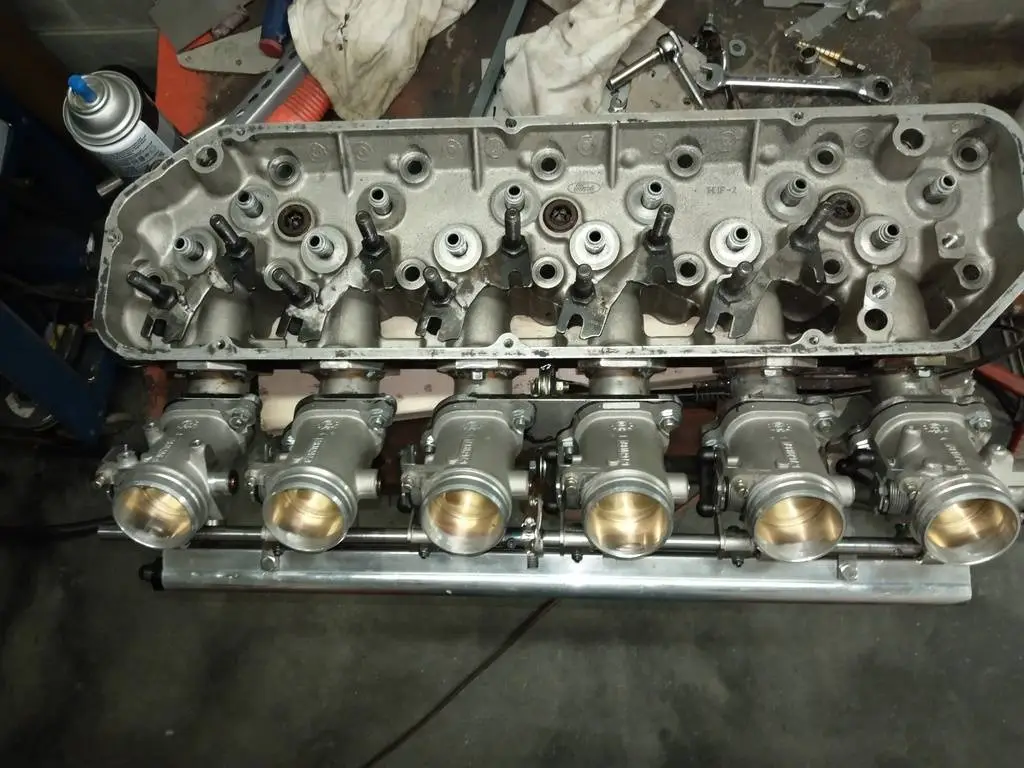

As a precursor I sent a few questions to Matt Cramer at DIY auto tune in anticipation of upgrading the ecu to Ms3x.
He took an extra day to respond, but when he did, he gave me what I needed.
That behind me I, snuck out of work and went on a shopping spree.:cautious:
First, as stated, I stopped by my local transmission parts supplier, and bought the necessary junk to try and fix my leaky assed trans.
Once done, I booked over to my other haunt ( an electronics parts supplier) and bought a new pencil style soldering iron, and a pair of those mega-dorky, mega-magnifier flip up eye goggles that you see jewelers and computer repair geeks wearing.
( I’m so excited! they work so freaking good...I can even see the fuzz on an ants balls when these things are on.):banana:

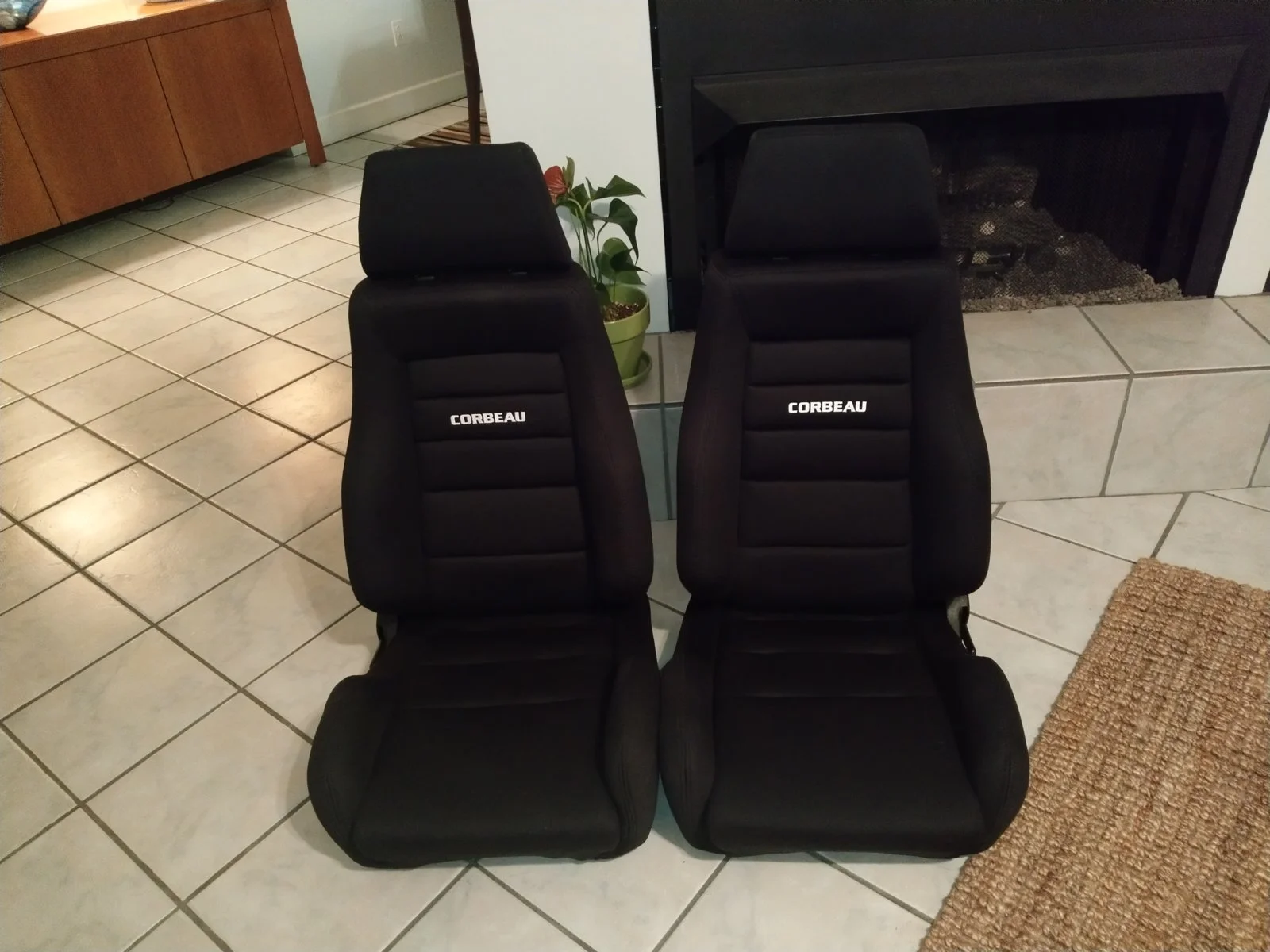

Is this a trick question? Are you giving them away?? Because ANYTHING is better than the busted ass SN seats I have now.
Well I just happen to have a set of Pro Car seats now that I'm not doing anything with....check your mail...maybe we can make a deal.

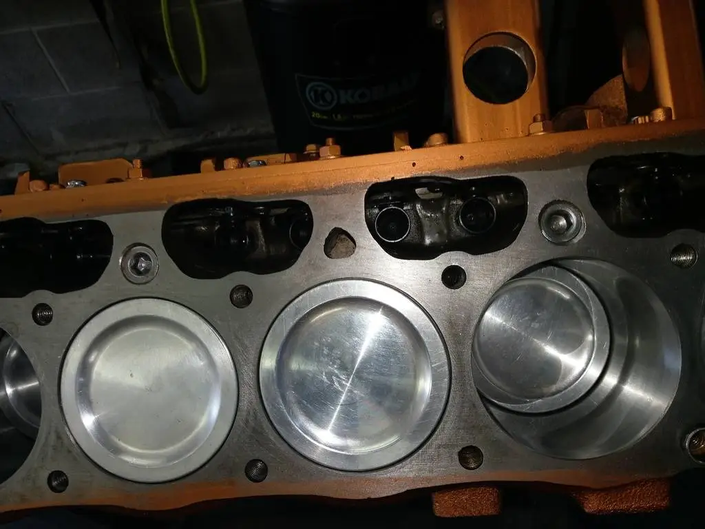

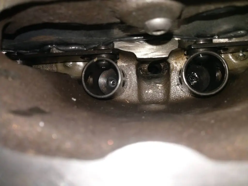

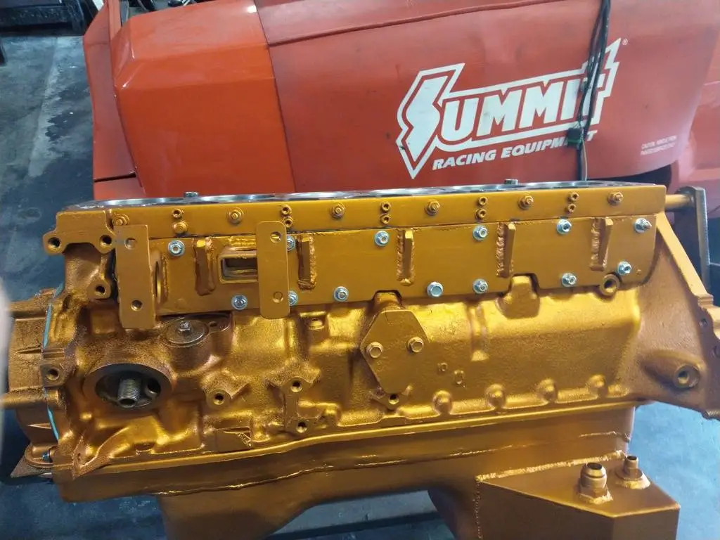

Ok...I'm spending too much time obsessing over the link hose theory this morning, so I'll enlist the help of the few that look in here. I realize that I post pics of this stuff all the time, but I also don't expect everybody here to be familiar with every detail on my engine..
This is the hole n my head that allows oil to return back into the pan.
Those giant openings surrounding the ports dump oil back into the lifter galley ..
Which when you look at it....
Is full of lifters....right behind that frank-n-plate.
With only a few tiny little holes to allow oil to drain back..
So then.....crankcase pressure has to come up through those holes just as the oil is trying to drain back into the pan...id have to imagine that there would be significant oil trying to find its way back into the pan that would be fighting the pressure trying to escape..at the very least, adding the hose will allow the oil to drain, and the pressure to escape in two seperate paths...I will in essence be adding a two lane highway in place of the bi-directional alley that is currently there.
So I'll make this mod.
There are 5 holes in the valve cover...three on top, and two in front right above the sealing flange, with one of them being right over the pushrod galley. ( I believe ill use that one)
I'll take the goofy ass hose system off of it, and reintegrate the breathers I used to have on it.
