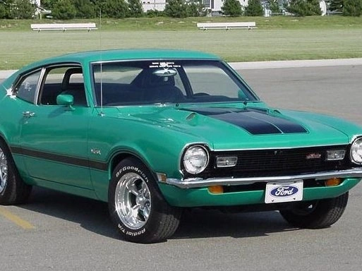

This is what Comet became when ford decided to eliminate the Torino/Comet midsize..
And I have that scoop.
This is Maverick..

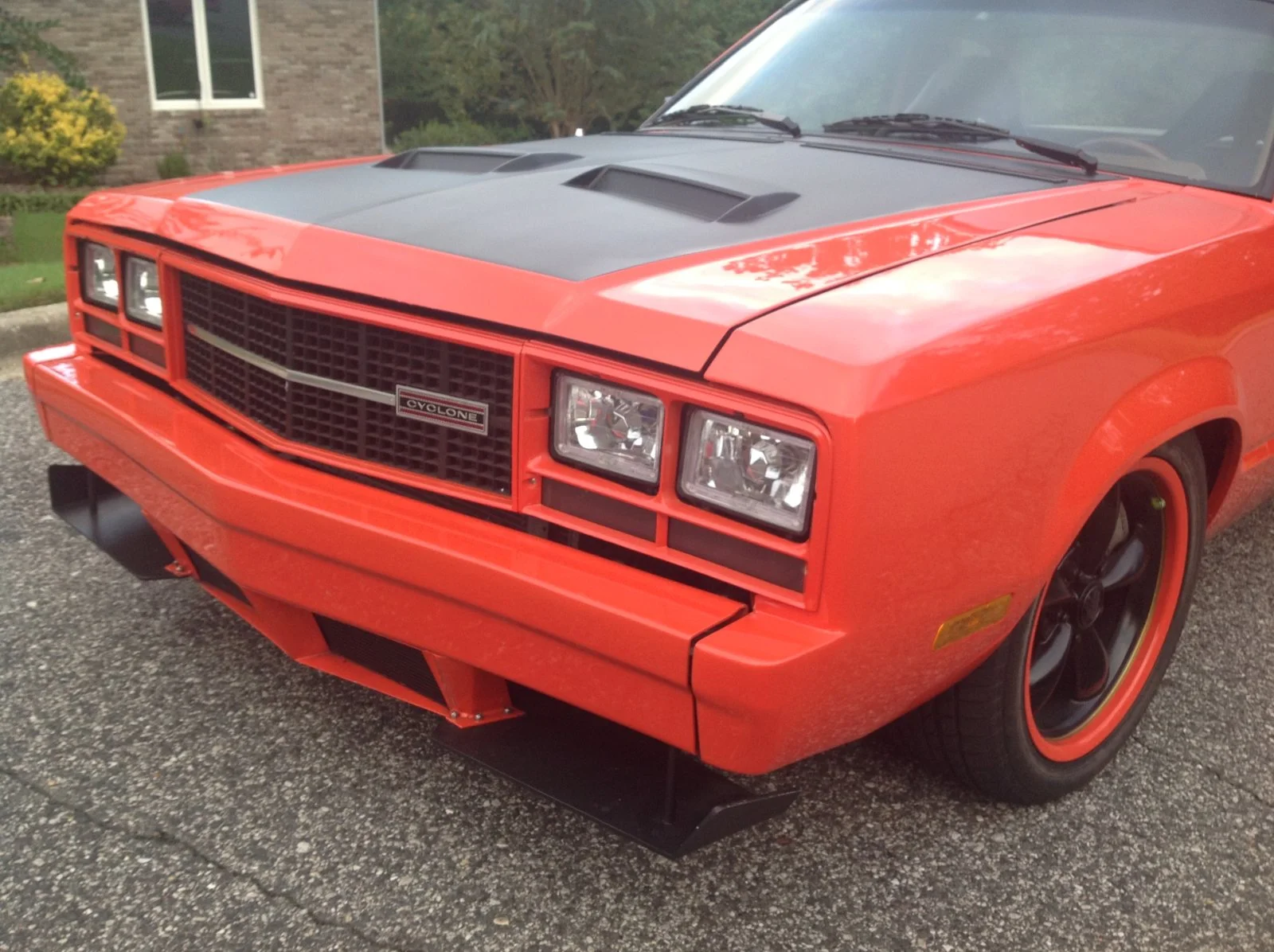

This of course is me...
In the grand scheme of things, this could work, until I get the car back up and running,.......kind of a blending of the Mav's nostrils into the G's Nostrils...it's not like anybody is gonna know what the hell the car is anyway.
But I'm not going after a Ford vibe, this car has always wanted to be a Mercury....

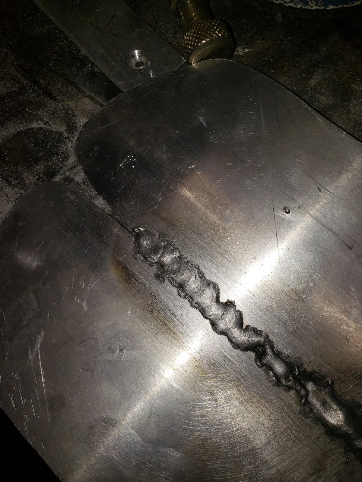

And that requires that I weld aluminum.
And that means I drag out the spool gun.
I've only used the thing once before, and practiced on a scrap piece this morning. I went home at lunch, and cut two extension pieces out of scrap aluminum plate ( by hand). Beveled the edges, clamped it face down on my Binford weld-o-magic welding table, and pointed that ray gun at the only one chance I had to do it right.
( this coming from a guy that's notorious for doing sht several times over)
The first side I gotta tell ya looks like ass... but the second side...With enough practice, I could actually make a weld like this look good...but not today.
So then, do you get to see what it looks like unfinished You might be thinking?.....
Well of course not...Dont be redicoulus.
Mike, I bought one of those spool guns last year and have only fooled with it once. The results were horrendous, but I was using co2 argon mix, and I know it calls for pure argon. What are you using for the spool gun, and do you think gas makes that much of a difference?
Joe
Joe
Yep, you gotta mess with it a lot. It doesn't weld like your expect. The wire speed has to be pretty fast, and the heat well above where youd use for steel. I wasnt kidding when I said it was like a ray gun.
This was from this morning's practice.
*keep in mind I hate showing stuff like this,but you can see where i started, and by the time i figured it out, ( towards the top), i was welding decently with it.
I used straight argon.
