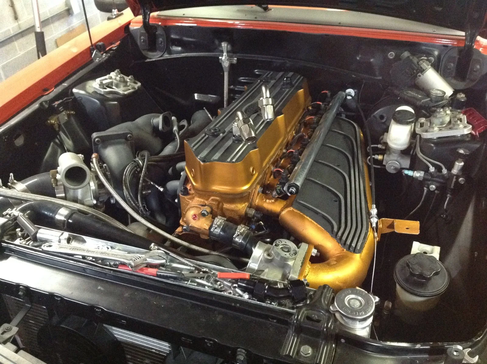

It feels like I got a fair amount of work done, cept I have little to show for it.
Now that the clutter is gone from having a fuel rail under the intake system, and 7 vacuum lines going to a seperate reservoir, I could actually get back to tidying up the wiring again.
Believe me when I tell you that this is significantly cleaner than it was just two weeks ago.
Two things here..Firstly you can plainly see what I did to extend the throttle cable. That litle aluminum smashie dude is now crimping the extension to the old cable. We'll see how long this lasts before I have to tear the thing out of the car and put a new one in its place,.. but for now it works.
Secondly,...the new/old manifold intake port is markedly smaller than the port on the head. I can't change that. I used a 1.75" tube to make the intake runner, and that makes the tube i.d. 1-5/8". I believe that the port entrance is at least 1.75. It's not that big a mismatch, and it's in the right way..at least there's not a "big going to small" mismatch.
Nonetheless,....I ain't got nothing to port on that intake..the tube wall won't allow me to open it up.
And,
Speaking of the old girl...
Main inductionTube now clocked 180*, and angled slightly upwards and now sporting the current engine combo color scheme.
Underneath is the new throttle cable attaching points. I gotta figure out what I'm gonna do to keep RD's fins from rusting though..those things are raw steel. Bout the only thing I can do is brush clear on them.
For those that lament the removal of the ITBs, I hear ya, I liked it too. I think this intake looks every bit as good when it's bolted to the side of the engine,..and it's night and day easy to deal with. The injector rail is on top, as are the connectors. there's no alignment issues to worry about,..and only one throttle blade to adjust for idle speed correction. And,....like the ITB monster induction system,...it's the only one on the planet.
So I'm not too broke up about it.
I'm presently working on the goofy assed breather/puke tank relocation,..I'm gonna get that thing located before I put the intake on for good. I gotta plan for that thing too though...

And you've partly fixed the injector placement. Its still not quite as good as the stock Fifty dollar head found in the 1983-1984 LE2 Bosch and 1985-1992 Xflow EECIV EFi in the Fairmont.
The injector had a machined out pocket relief hole in the port which you can incorporate. Your idle surge is injector postion related, not just dead time which Steve fixed. It should impinge on the back of the intake valve, and allow air flow and atomisation. Bosch designed Pulse Width Modulation injectors to work in a certain optimal position.
The BMW ITB system had good injector placement stock, but the extra 30 degree across the air flow bend to make it fit the Falcon alloy head gave it poor injector placement compared to your custom system.
You'll make that bad boy do the bussiness CMA.
Anyway....spray and walk away.
That's my motto...

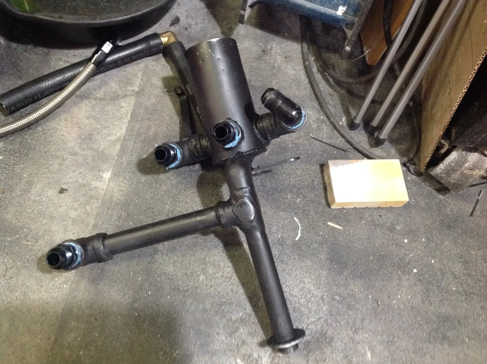

As you'd expect with me, I'm walkin two steps forward, and three steps back.
I made this hideous hookah looking thing over the last few days. Basically I modified the original puke tank to allow me to run 4 lines to it, and have a drain that would go to a remove able reservoir so I could dump off the puke, instead of allowing it to return to the engine.
It gets mounted to the drivers side inner apron, and that's that. I install the intake, and sht starts not fitting. The throttle linkage that I adapted is too short, now that the intake is mounted...No big deal, it was probably for the best that I replace that anyway. The bigger problem is that it runs under the intake...right in front of those three fittings on the bottom, which also conflict with the hose for the remote power steering reservoir.. And as hurky as the thing looks, getting it mounted past all of the hoses already on the car was a pain.......
That paled by comparison once the intake was mounted, and I needed to get it back off.
I'm not thinkin it's going back on.
Anywhere.
I'm sure the whole crankcase vent system I conjured up is now overkill.....(4 ) -12 hoses are probably way more "ventin" than I need, but it worked last time I tried this, so I'm going with what I know.
I know that trying to get the three hoses between the new fuel rail and the valve cover dont work,...I know I don't want the hoses on top of the intake either..I also know that I've already cut up 5-6 feet of the 15' of brand new -12 hose trying to make this work...and I'm not ever gonna be able to get that back.
So........business as usual,.....give me the wall to bang my head against, and point me into the wind so I can piss into it.
