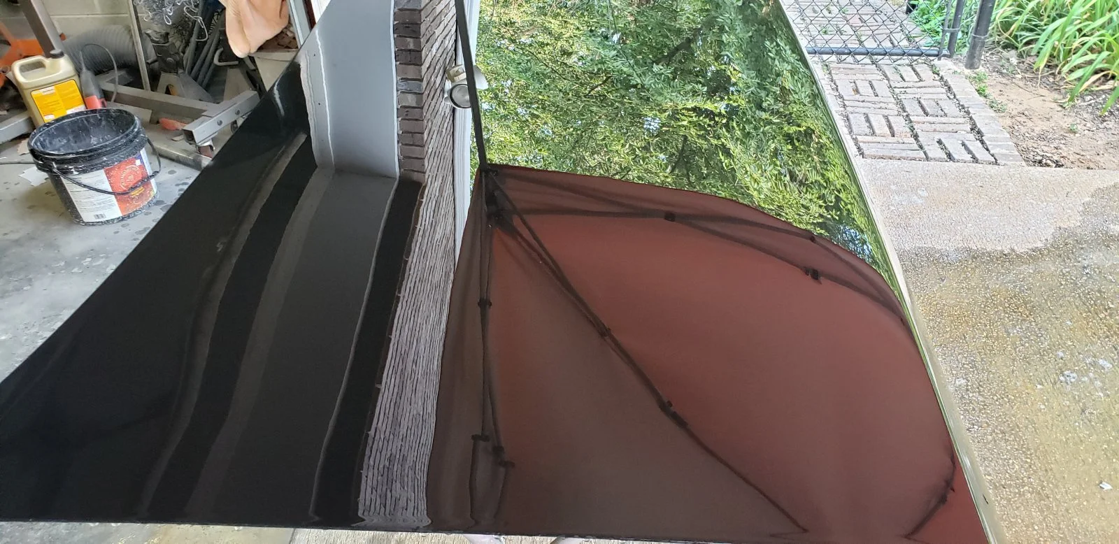

I get home this evening determined to finish wet sanding the trunk deck, now that the underside is done.
I think it's ready for paint.
What looks like paint is the water standing on the trunk immediately after rinsing it. The thing is about as perfectly flat and smooth as I can get it.
Now it's just a matter of figuring out how to paint it.
And I think I figured that out too.

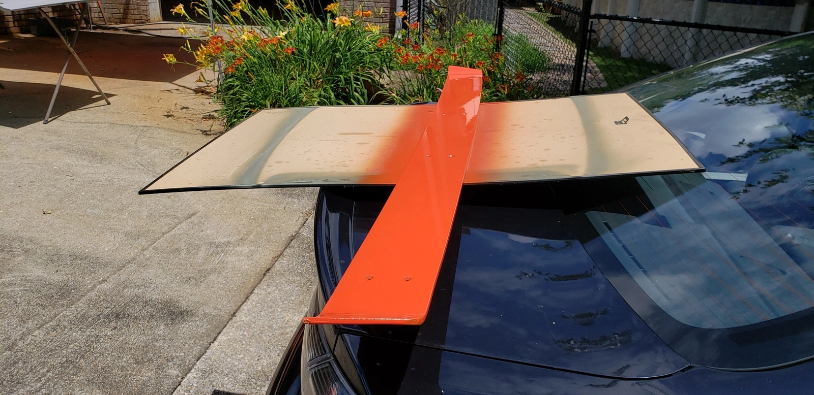

The orange paint that'll go across the front of the hood, and the ducktail spoiler is made by some no-name company. I bought that paint last month in anticipation of this upcoming day.. Today is one of those upcoming days.
I hung the ducktail after priming it and scuffing it. The paint called to be mixed at a 4/1/2 ratio...and it was already considerably thinner than the black stuff I've been having so much trouble with.
By the time it was mixed, it was only slightly thicker than water. Once in the gun,..I triggered the thing and set flowing pressure to 25 psi..The sht blew out of the gun like water. I fanned the spoiler with an attempt at a light coat...( now I have way too much fluid flowing) but I didn't run the paint. I let it tack up and fan a complete coat. I let that tack up, and fan another complete coat.
It's drying really slowly..
This is after 30 minutes...
Terrible pic I know, but it's freakin dark.
The bugs flocked to it. Michael Phelps bug landed, and then back stroked his way through the bug 100 meters in the orange ocean. He literally made it about an inch before he ground to a halt,.......and died.
Now that the whole thing is semi-dry, the orange peel has appeared. Nothing like I've been dealing with up till now,..but it's there.
Too much paint....it's always too freakin much paint for me.
The good thing is I've figured out that I'm gonna have to thin the black paint thin enough for the cheap assed gun I have to be able to atomize the paint properly. I spoke to Dave on Sunday, and he recommended that I keep the cheap gun, and thin the paint. Now that I know that the gun will move the paint if it's thin enough, it's just a matter of how much thinner.
The hood is ready for the orange band...the underside is ready for the black paint, as is the top. If I can just pull this off....

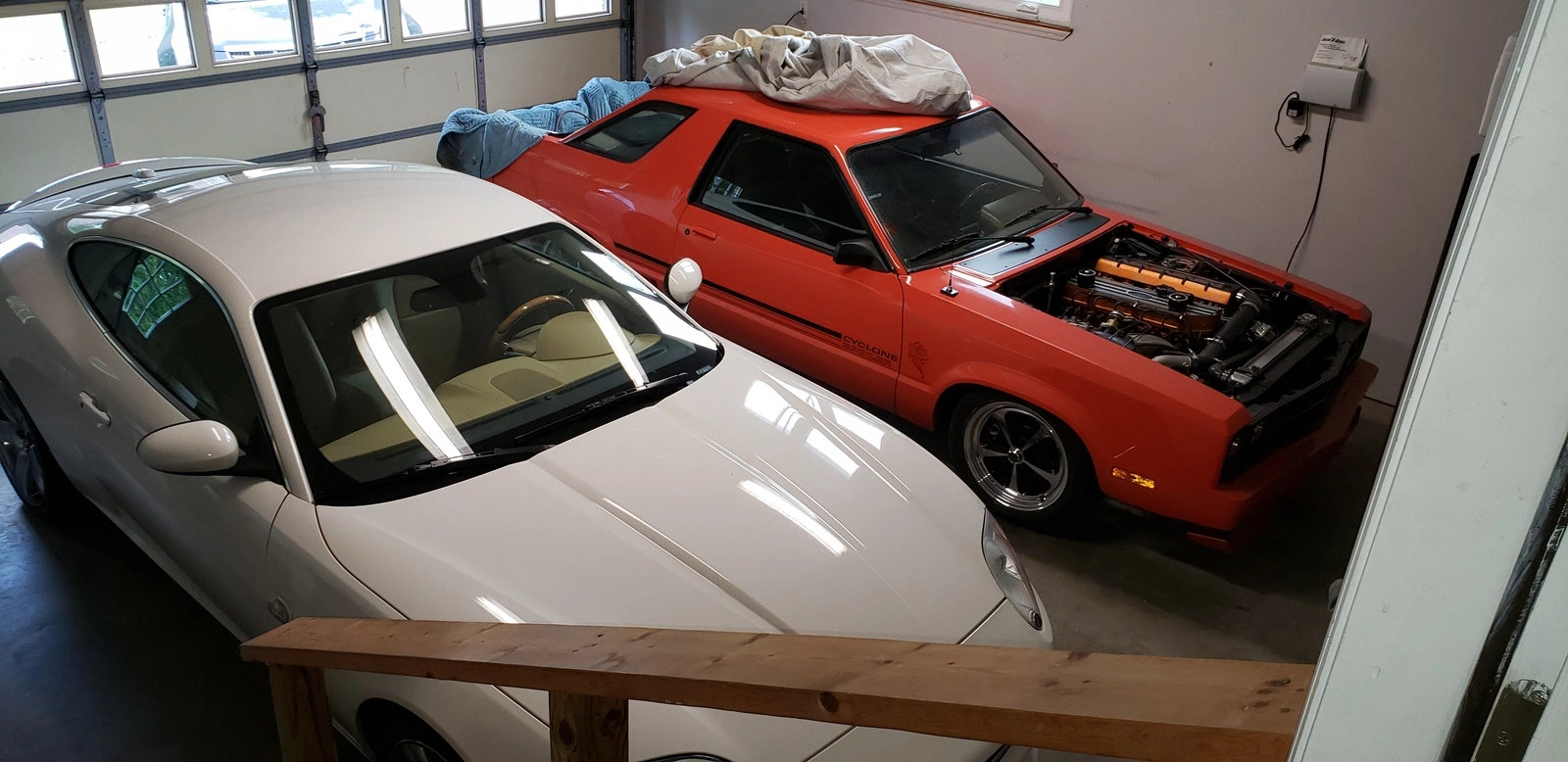

Couldn't ask for any better weather tomorrow and Sunday to paint.....................rain.:nonono:
I'm doing this sht this weekend. This forces me into plan B mode...........
* Plan B = Move the monster out of the garage. Move Kate's Cadillac out of the upper garage and put the monster there. Paint the parts in the garage on Saturday, put the monster back , put Kate's car back,.......she'll never know what happened.
Of course it helps that she will be out of town at a trade show for the next several days...I could never do this if she was here....
I mean I could still move the monster an all..........I'd have to put the Jag out in the rain instead:rolleyes:.
It dawns on me that I don't know if I've ever even tried to get it to move under its own power since switching the ecu over to ms3x...I've started it....gotta think...:thinking:did I pull this thing back in under power when I backed it out to take those pics last time?
Certainly, I didn't attempt to push the thing inside..there'd be evidence of the massive ballsack explosion that would've happened had I tried...I guess I drove it.
Oh well,......I digress.
The challenge this time will be getting it into the upper garage in the rain, w/o a hood and trunk on it. Then getting it next to the jag with out whacking either car into each other. The monster has a turning radius of a Russian MIG 17..( read....not good)
The tires rub on a hard lock...ill have to practice my 3 point turns.

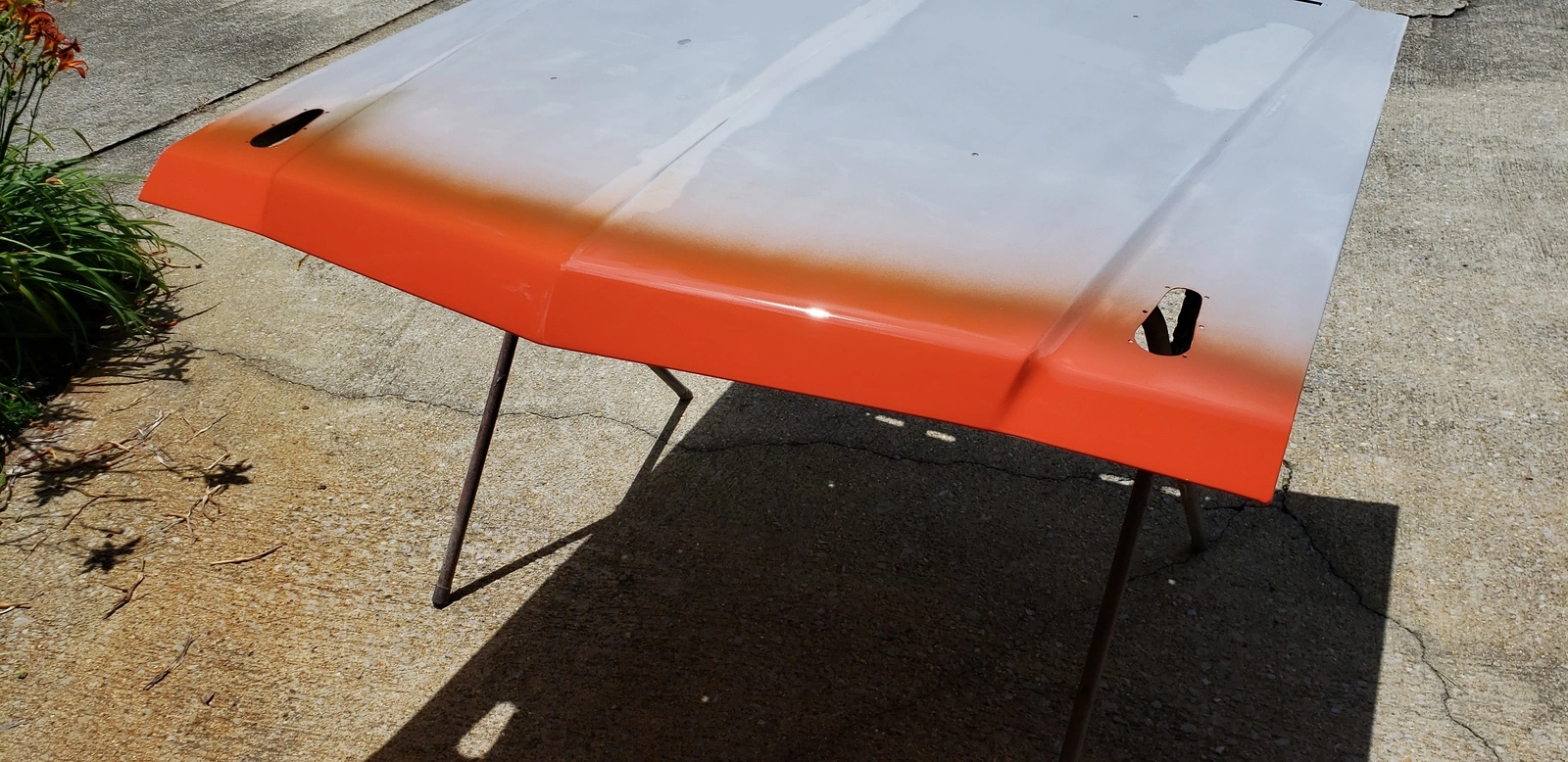

I put the trunk outside, I moved the hood onto the stand. I needed to paint the orange band so it will be dry enough to mask off sometime tomorrow. I wiped it down, tacked it off,...and sprayed.........fish eyes.
Fortunately for anybody within earshot I had the respirator on,..but that did stop me from yelling GOD DAMMITTT!!!! at the top of my lungs..
I'm out of paper towels,..all that's left are some dried out ones that I've used to dry off the trunk and hood after wiping it down with prepsol. I have to get the orange paint off before it dries, or I'll have to sand it off..I scrounge the few that aren't wet and start wiping the orange paint back off...
And wipe off the rattle can high build primer that I used as a finisher right along with it.
Effectively ruining the finish.
In hindsight, I think the wax and grease remover hadnt completely dried, and that has caused the fish eyes. ..it's humider than a mofo here today..even water won't evaporate.....it just sits there...you have to blow it dry.
Again......I'm wiped. Two weekends in a row trying to get this freakin thing painted. Only this time to add insult to injury to the whole thing, I've fcked up a 75.00 HF gun along with it.
Its sht like this that has been the death nail for many a car project....it's this way with me on everything I do...I can't believe that I still have the freakin thing.
Then all I have to do is give it some time...have a drink,...and I'll start this crap all over again the next day.
See,......The monsters like a big eyed dog to me...... All I have to do is look at him...
And all is forgiven.

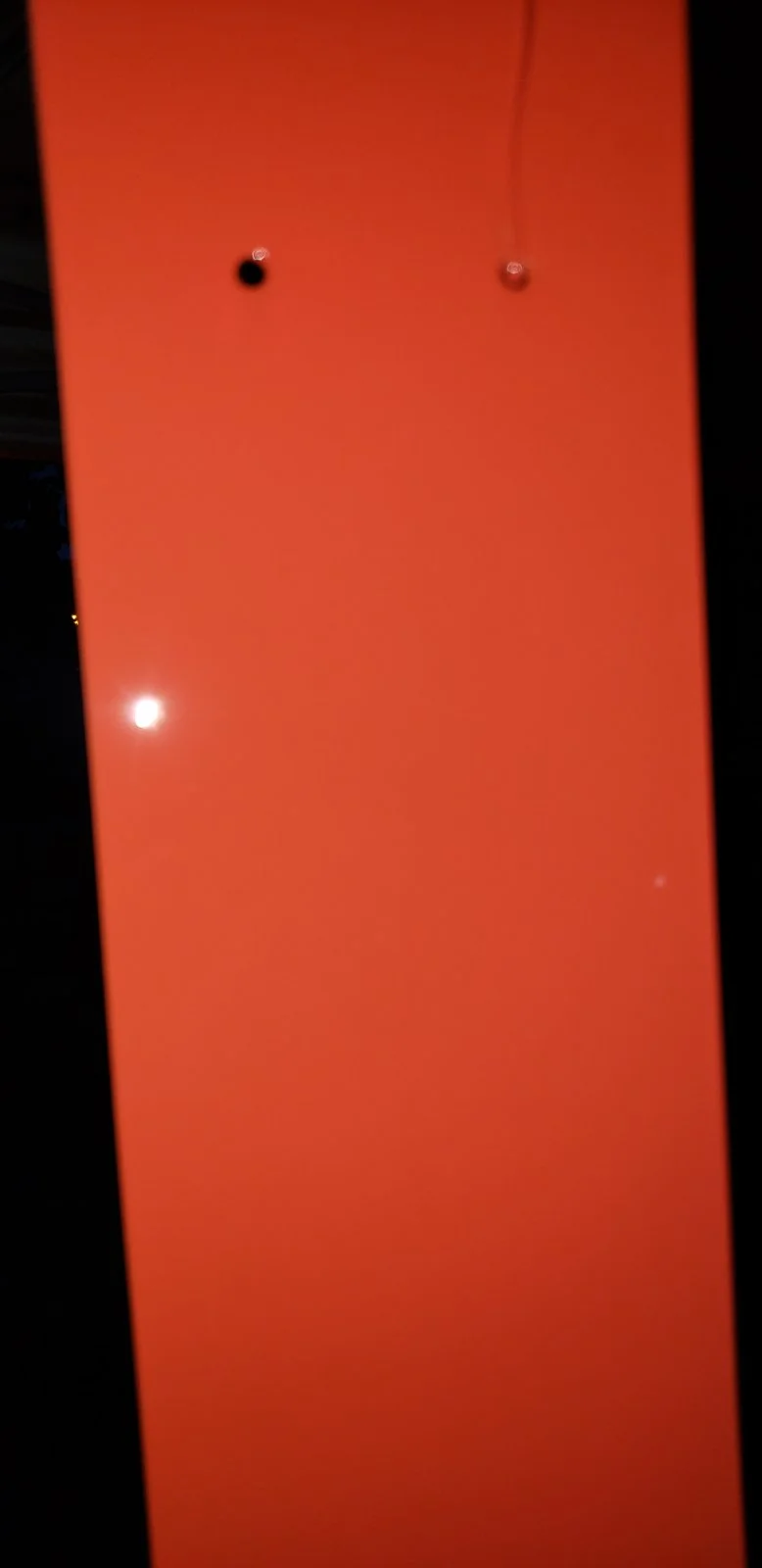

How's that saying go?
"3rd times a charm"?
Or is it the 4th, or maybe the 5th? :thinking: I've lost count...
But whichever time this was,....magic happened.
Single stage urethane, no clear. Flat as slate, and smooth as a babies bum. It went on so nice, I just had to sand down the ducktail and reshoot it too just to press my luck..
Turned out the same...
It's been a gun setting issue for me..that, and whatever caused the fish eyes. I suspect maybe the tack rag..( I've been using the same ol skanky ass one that I throw up in the cabinet when I'm done with it.) probably not the best practice.
I didn't use it this last time, and miraculously no fish eyes..whether or not it's to blame, I don't care. I'm done with orange.
And I'll buy a new tack rag before I move onto the black.
