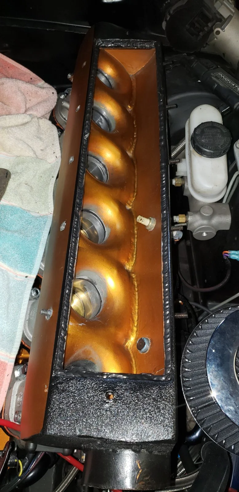

I made two separate attempts to get the glass top to work out......both times ending in a hissy fit...( both for me, and the air escaping past the gasket)
It's just a matter of fact.......
The ledge that the glass sits on isnt flat...there are dips and whoopties that cause the gasket to be ineffective. The only thing that's gonna seal this top is the same 3m tape that I've used before, or something black and gooey.
Either way..I'm not glueing the glass top down again.

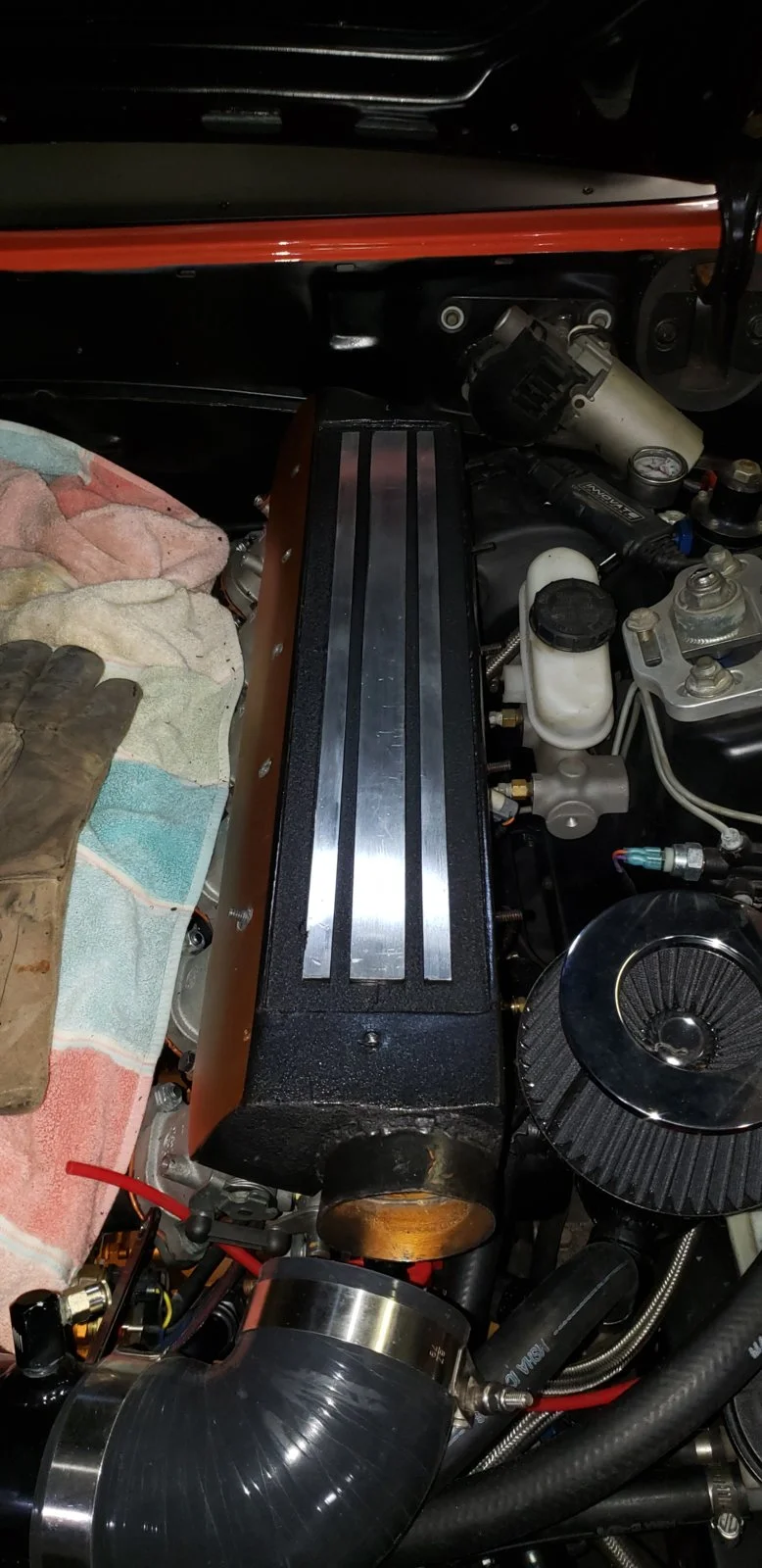

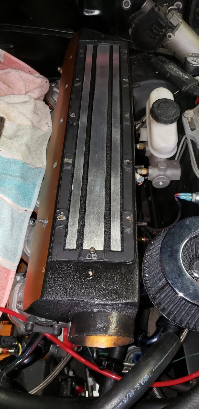

I made an aluminum ribbed top. I'm happy with it. I'm gonna bed it in rtv...and call this thing done.
Its presently going through its paint process, tomorrow I'll stick it.
As for when I'll ever get to drive it again..that'll be quite a few days from now. Firstly, I'm gonna make sure that goop is completely dry before I pressure test it, ( and at the rate this sht drys that'll be days.

It's the hardest thing for me.......waiting.
Lack of patience has ruined many an outcome with me before, but this time I got no choice but to wait...
For this sht to dry..
The goop has to set enough so that by the time I start cranking down on the retainer screws, it just doesn't blob out, and drip off into the throttle bodies..
So all I can do, it to set the new lid on top..
Set the frame on top of that...
And wait.....
