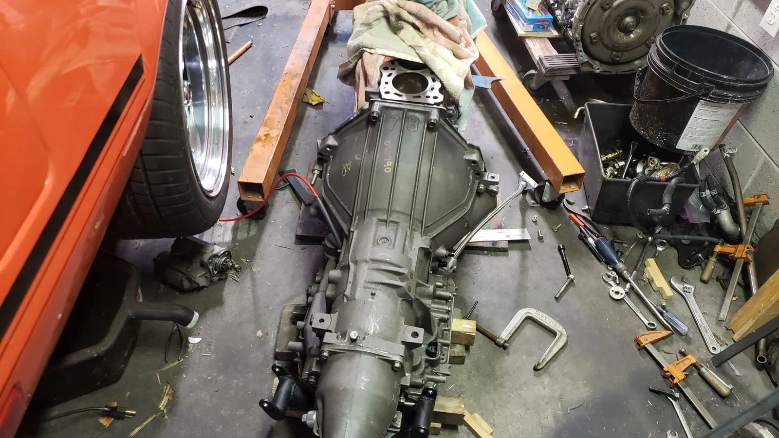

I did get the trans figured out. All good stuff.
For whatever reason I must've went brain dead thinking the converter was gonna be anywhere near the flex plate with a 3/4" spacer bolted onto the transmission side of the flex plate. Even if I bury the converter pilot all the way into that spacer, the feet are still an inch away. And I cannot bury the pilot all the way in. The reason it's called a flex plate instead of a flywheel, is that the converter moves in and out on the input shaft as it is accelerating, or decelerating. I need to allow for some movement, so I'm gonna back it out of the adapter 1/4" to keep it from bottoming out. That means these pedestals are 1.125" tall.
I do not have to cut off the converter feet, I do not have to weld on the converter...and...I'm able to tie each pedestal together so that they'll end up as one piece. How freakin perfect is that?
The garage was a disaster, I couldn't find nothing, so I spent the first few hours organizing stuff. Then, knowing I was gonna be messing around with the engine, I put the pan on for good. In order to do that, I had to finish the pickup screen, and bolt that stuff al back in. I put the pan on, and then decided to install the oil pump.
Wrong order. You cannot install the pump like a SBF timing cover it seems, there's a portion of the pump that hangs down, that will not allow that. So I had to drop the front half of the pan so I could install the pump.
Once that was done, everything got bolted tight.
Remember that I found alternative o rings to the Toyota ones?....they didn't fit. I ended up reusing the old ones, augmented by a judicious aplication of the right stuff. I hope to hell everything seals up.
So no pics...but I'm on the path forward.

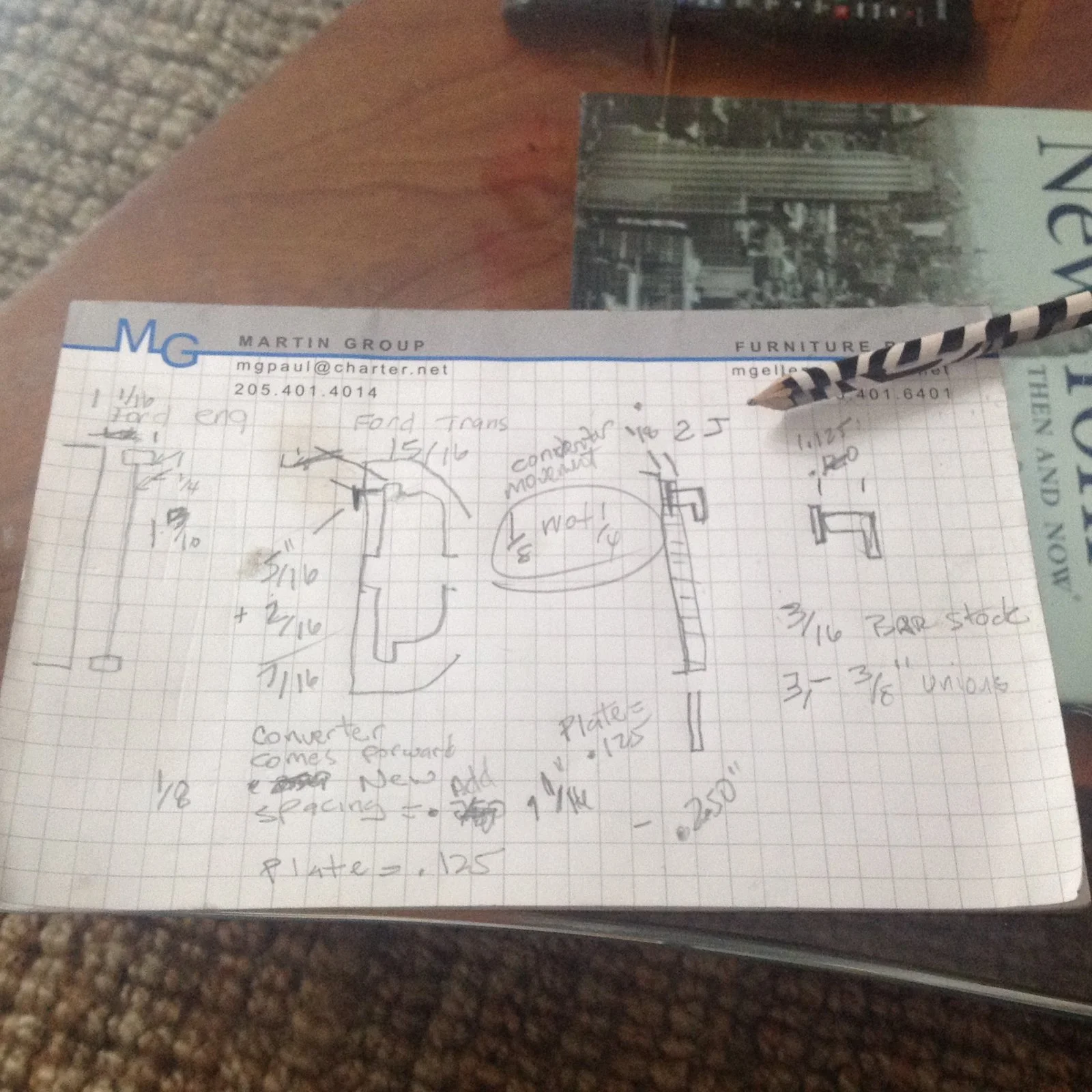

There will be exactly 7/16" between the back of the 2jz block, and the face of the 4r70w transmission. The pedestals stand 1.120" off the feet of the converter. Despite that, because a ford flex plate is actually recessed inside the bellhousing,almost an inch, that means the pedestals actually only stand proud of the bell housing 5/16". After double checking my measurements,
( check out my precision CAD file)
All its gonna take is some 3/16" thick bar between the 1/8" plate that's on both the engine, and the trans, with a bunch of holes drilled welding and gussets.
I checked the fit of my spacer.....fits freakin perfecto.

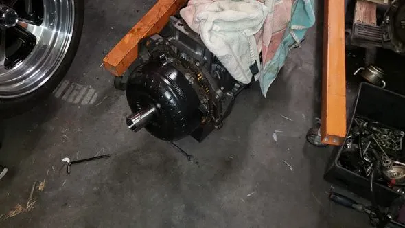

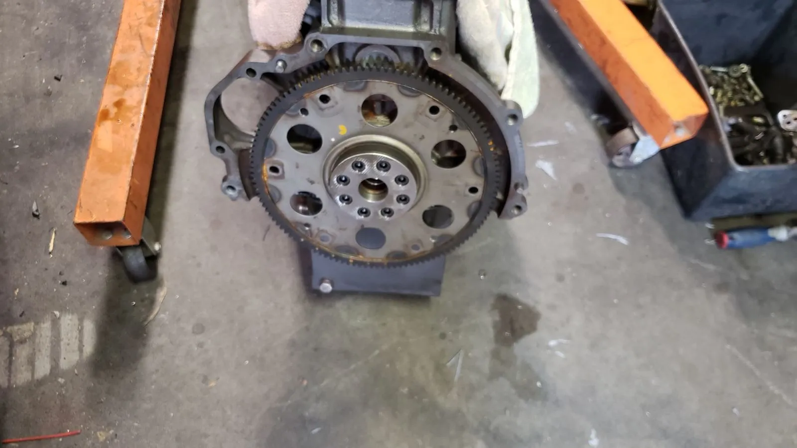

The pics I posted of the converter bolted to the flex plate a few days ago is old news. I was bothered by the "L" bracket with a 1.125" long leg that was being held on with a 3/8" fine thread bolt that made up the mount tabs. The logic being that 500-600 ft lbs of torque would just have a freakin hay-day with those brackets. Especially considering that the mount point for the converter was that far away from the flex plate.
Figured it'd just twist those bitches right off.
So,...I reconfigured the mounts,..I moved them outward towards the starter drive ring...MOF, the bolt hole is actually drilled through the drive ring..
I shortened the legs, thinking that it would end up moving the transmission and engine closer together. I welded those legs to the converter pedestals. I have officially phcked up the converter to where it is now just like all things monster, and exclusive to this engine/trans. It fits nothing...including the current combo.
It's all bolted together. There is only 1/4" between the engine and the trans. When you look into the bellhousing,...there are the newly modified mount legs...fully 3/8" away from the starter ring gear..
3 freakin eights of an inch. To make these legs the right length they'll end up being an inch long again.
I ain't doin that.
The right thing to do is to split the difference...weld pads onto the flex plate to reinforce the mount point while at the same time, shortening the distance between them.
So,...looking like I'm adding an additional 1/4" pad to the flex plate..that'll leave 1/8" for the converter to move forward.
