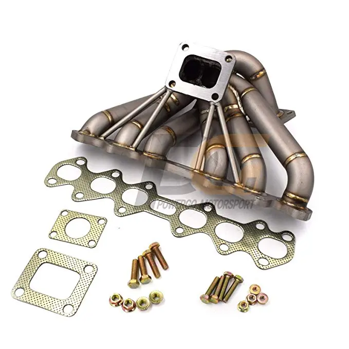

Nope,..not the plan.
Just bought this...seems too good to be true, and I like how it is reinforced...and that it is raw and will take high heat coating because of that.
A 304 ss turbo manifold for 300.00? Well see I guess..it’ll be here on the 9th.
Davedacarpainter
I think I've messed my pants
SN Certified Technician
Nov 28, 2015
11,451
10,557
193
57
Discordia
That’s freaking beautiful Mike!
