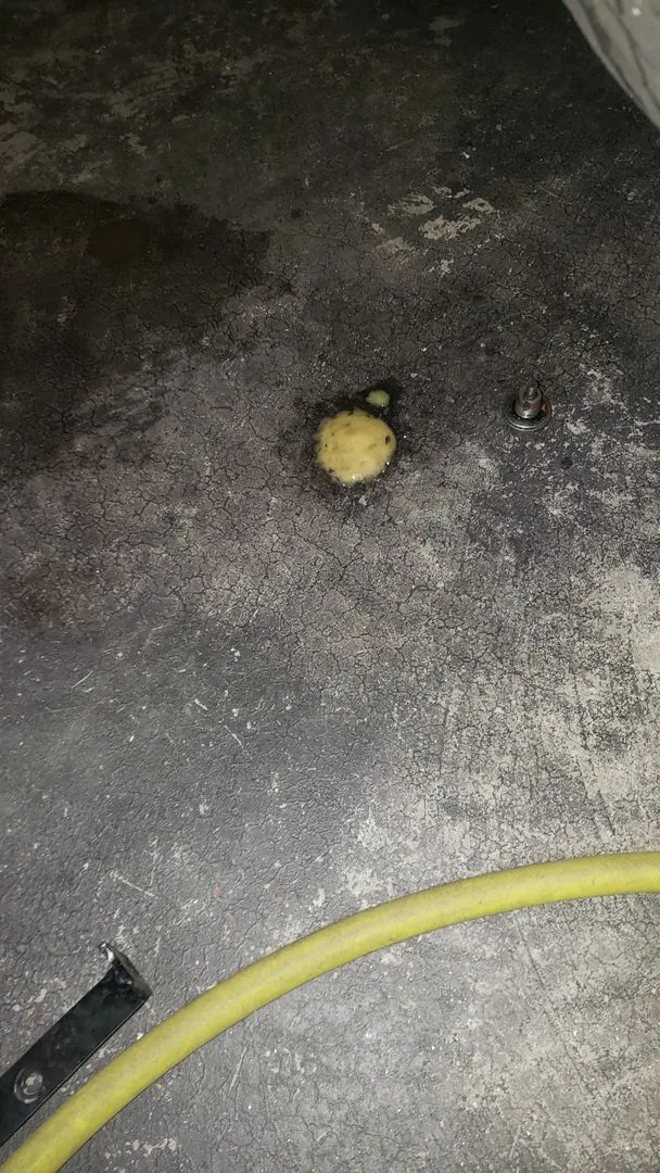

Ok, let's look at a couple things here.
the splouge on the floor looks to be coolant/oil froth mix, maybe some meth mixed in :shrug:
It's in the dohicky blowby thingy hose (I think that is what you unhooked)
Oil pressure is now funky (maybe unrelated :chin)
Possible issues: too much oil, crankshaft throw is whipping oil violently around the oil pan, mixing with blowby with the water/meth mixed in causing the frothy splooge :shrug:

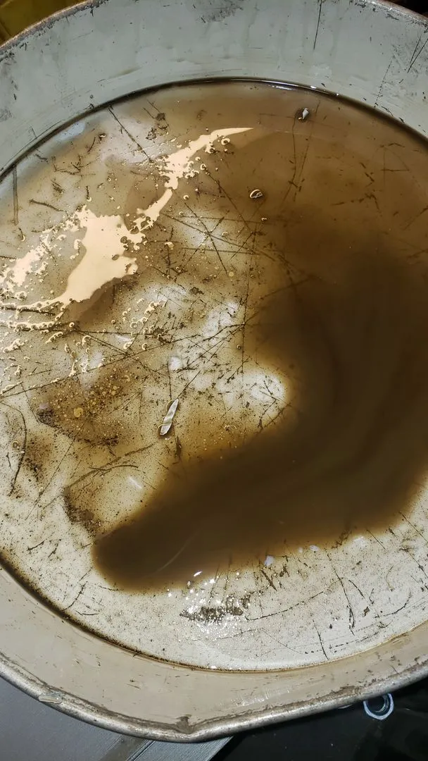

On your way home from work, and because you're concerned about the inconsistent oil pressure, you decide to cut the oil filter open, that requires a replacement oil filter and a qt of oil. You stop any buy one of each
Added fodder 3.0

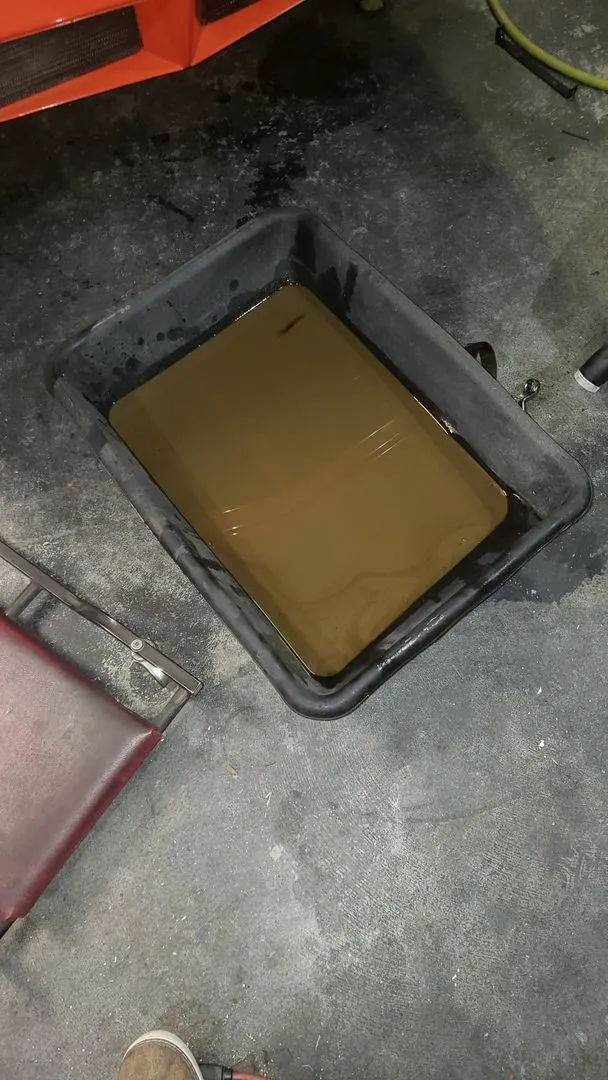

You remove the filter. Chocolate milk pours out. You decide to drain all of the oil. You have three drain plugs, because you have a three sectioned oil pan. You remove one plug on the driver side sump,...oil pours out. It ain't pretty, but it's oil. Still kinda choclaty lookin, but oil nonetheless.
Added fodder 4.0
Because you've had a Meth fueled race car before, and engine oil looked like ass after only one night at the track, you tell yourself that maybe the whole water meth injection thing is doing the same here..you clean up, go to Oreillys and buy 7 Qts of crude 10/30 ( because you may have to resign yourself to more frequent oil changes for the same reason, no sense wasting money on full syn oil) when you get home, you still have two drain plugs to remove. You crawl under the car and crack the passenger side plug. And watch....and count..1,2,3,4,5 as anti-freeze pours out.

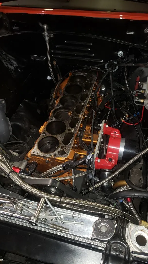

The Monster has a bad head gasket.
Anti freeze was diluting the oil.
Crankcase pressure is getting into the cooling system.
This is after a quart of antifreeze poured out of the engine.
Weirdly enough there is plastic debris everywhere...I have no clue what in this engine is made out of plastic that managed to get into the oil system, but it was pretty thick in the filter.
The engine is in a "What now" category..if I don't fix it, it's a giant piece of worthless sht. If I go through the hassle of replacing the head gasket while there is still this contamination floating around in the oil system,..it may be one hassle followed by another.
One things for sure, if I don't try and replace the gasket, I'm not going to the one damn show I've been waiting all year to go to, and,...if I do, and the other thing strands me 300 miles from home.....ooooooohhh.

I'm afraid so...we do know that #5 had a whole bunch of gooky green water in the cylinder...
For a fleeting moment I thought " Maybe I'll just buy another head gasket, and put it together for the rest of the year"...
Then I pulled the head.
A couple of the cylinders look like they are scored pretty bad..for an engine that has less than a thousand miles on it since it was last machined, the cylinders look like ass.
It's time to be done with the whole thing..
