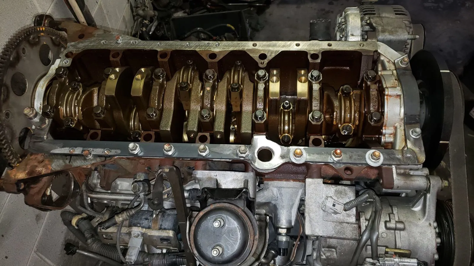

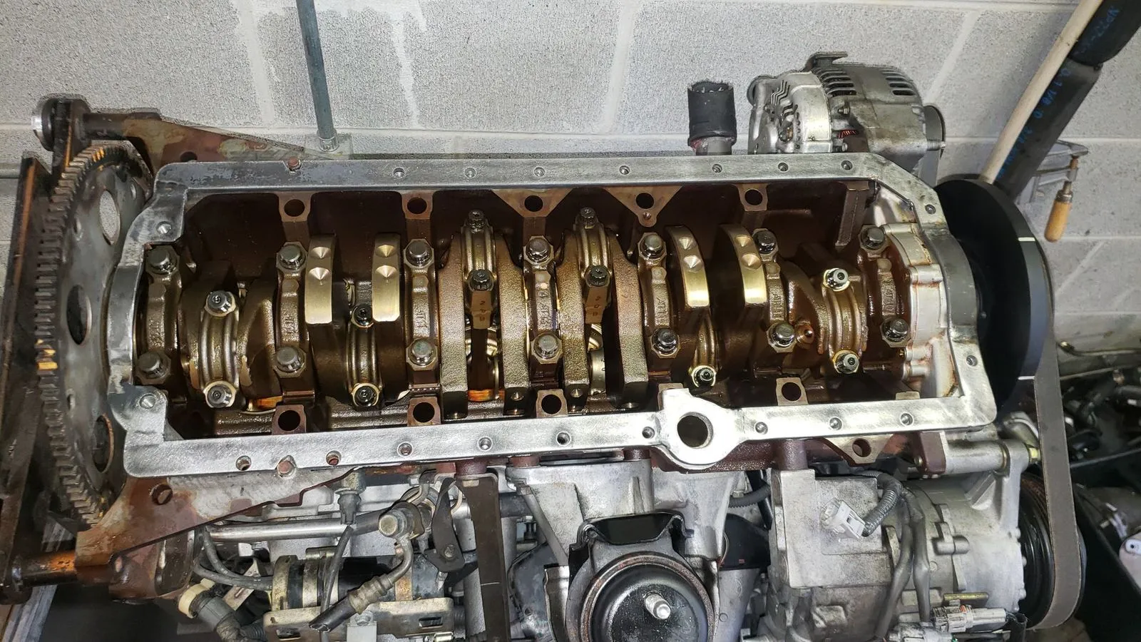

I have the startings of a oil pan..
I'm pretty proud of myself here..see the front " hump"? It's 3/16" thick and it fits like it was molded.. But it wasn't.
It was bent by me..in a vise. One little tweek at a time..
Needless to say, doing things this way takes for freakin ever...and I spent the whole day to get the engine separated, the stock pan off,..the engine mounted on a stand,..the pieces parts bought from lowes,..and get to this point.
The good thing is this engine looks perfect..no sludge of any kind. The oil screen was clean, save for a tiny bit of sucked up silicone from something in its past....
The bad thing is that I hate having to build a pan using an assembled engine. Despite my best efforts to try and keep weld spatter out of the engine,..I still worry that some little ball,of hot molten steel might get past me.
I'm confident that I'll be able to build a pan for this thing. It'll be epic.
Then transmission adapter is getting closer to being solved..after getting the factory stuff separated, and putting the engine on a stand I'm thinkin.........." Why couldn't I do the same thing I'm doing to adapt this engine stand to the 2j? If I buy like 1/2" bar stock, drill one end to fit the 2j block,.and wherever the 4r70w bell pattern ends up I cut, drill and tap that leg . So,..I make 5or 6 legs.. I bolt them to the back of the block..I bolt my 4r70 to the legs. Once I get everything adjusted,...I remove the 4 r 70, and make interconnects that tie each leg together. They get welded to each other. In essence, I build an erector set that looks like a spider web of sorts.
All I gotta do is measure some sht...I don't need no stinkin cnc...And I'll do this for less than a couple of hundred bucks.
I do need a machinist with a lathe though.
The spacer that hubs off of the 2j crank, and steps up to my converter hub OD is beyond me.. But putting a 4r70 behind a 2j isn't.

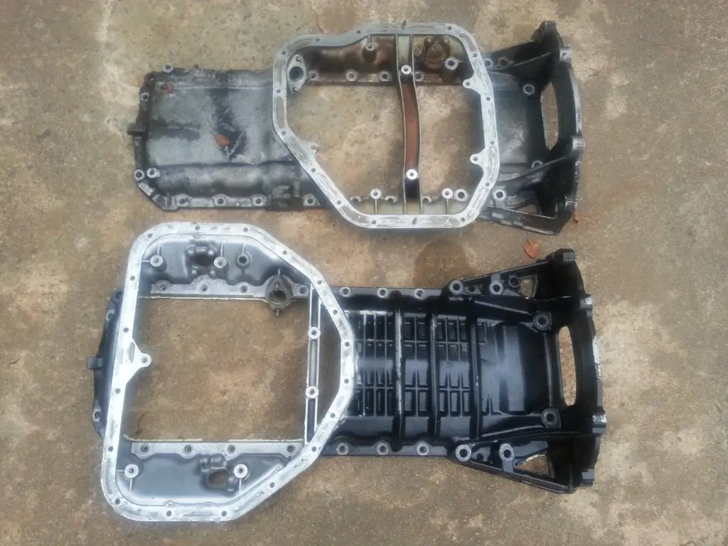

When you look at the above pan rail pic, you'll see my dilemma. 2jz's have a big assed oil supply inlet. Almost 1". Twice the size of a standard SBF. I needed to fabricate a rear sump pickup tube. There is no stock tube I could use. The factory rear sump pan is actually more " mid sump" and was just as short as the front sump one was.
The factory makes it possible to get to the converter bolts through a rubber grommet that fills up that rectangular hole.
My pan will block that hole.
Not so much a problem for me considering that I will have access to the converter bolts either through the factory starter hole, or the open side where the ford starter would go. ( I think I'll be able to use either one if my transmission adapter turns out like it is in my head)
So..you have to find a way to tie that hole to the rear..( which I've done..for 75 bucks)
Like I did with the monster engine, I'm gonna make a hole in the pan, and create a flange to bolt the existing stock pickup to that flange. On the outside of the pan, I'm welding a -16 bung. I'm also welding a -16 bung where that hole is in the pan rail. And then coupling those two bungs with a short piece of -16 hose.
