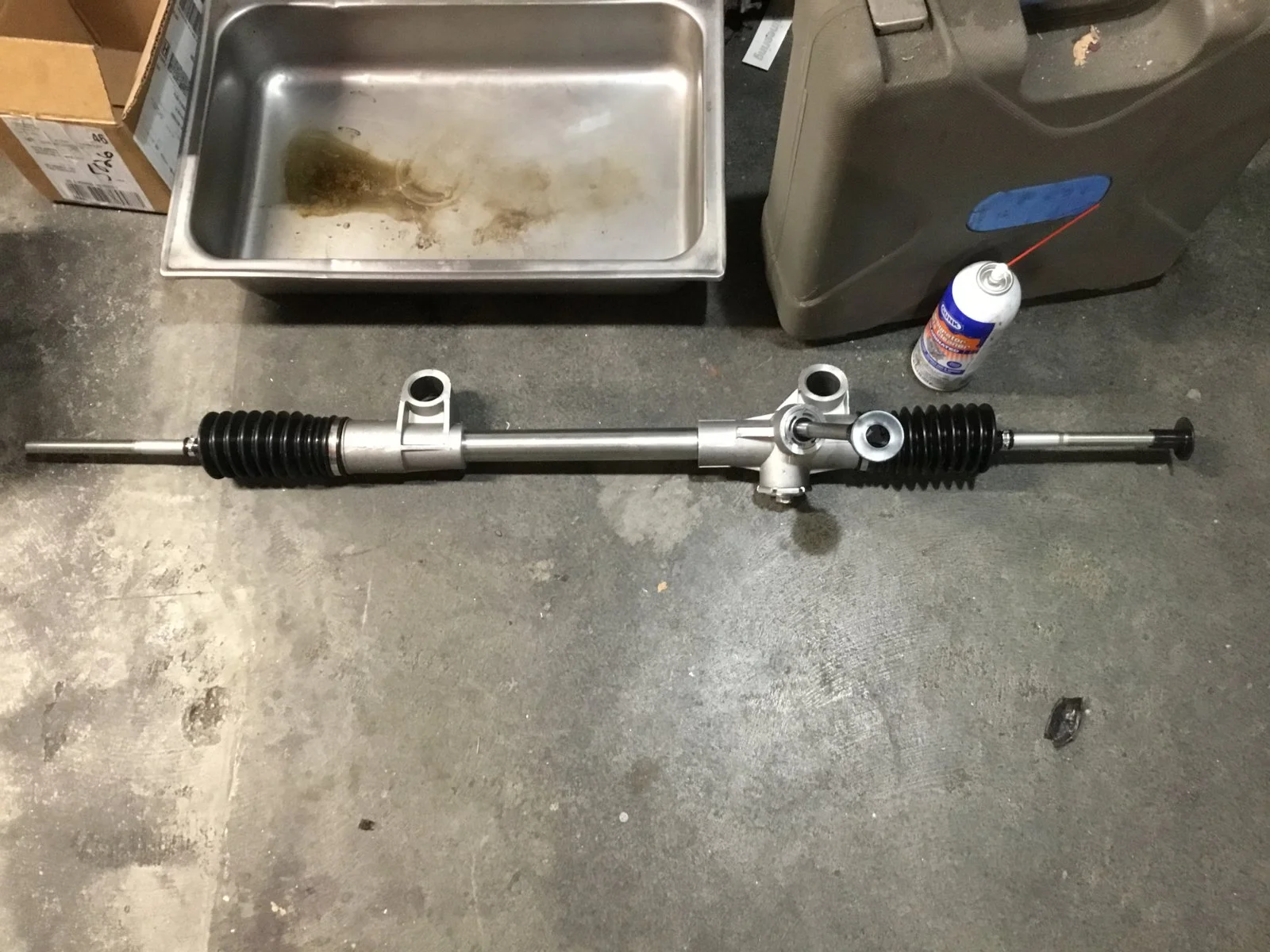

The 119.00 manual steering rack arrived last night. Initial first looks find it to be every bit as good as a Flaming River, or Uni-steer rack that’s out there selling for twice that much. I’ll check the turn count lock to lock to see what i actually have tomorrow.

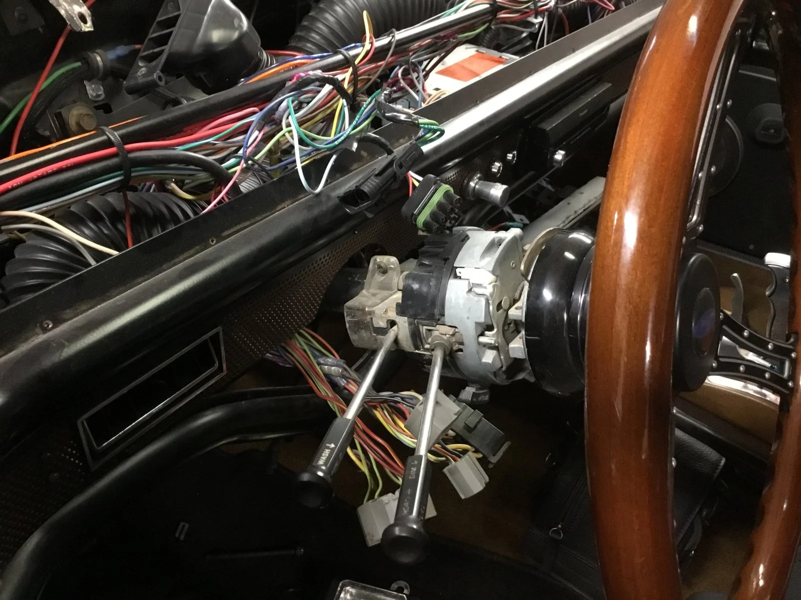

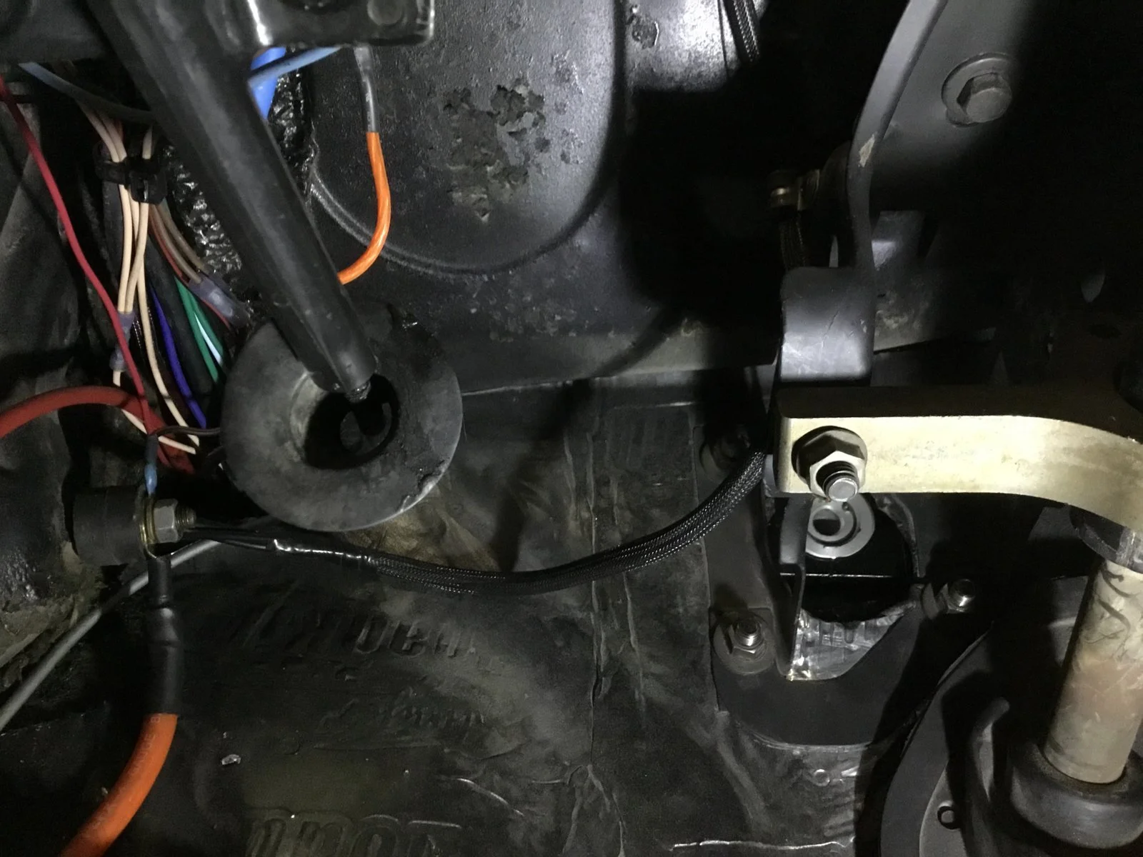

The 3amd and I were talking last night,.he thinks that I may have to remove the steering support bracket to make it easier to modify the steering for the upcoming EPS conversion. I told him that with all the wiring that is currently in place, I doubt that that would be possible, but agreed with him that it would make it way easier, especially if I have to cut that support in any way.
im hoping that I can get it out of there...Tell ya what,..why don’t I put some shoes on and go down there and look..
