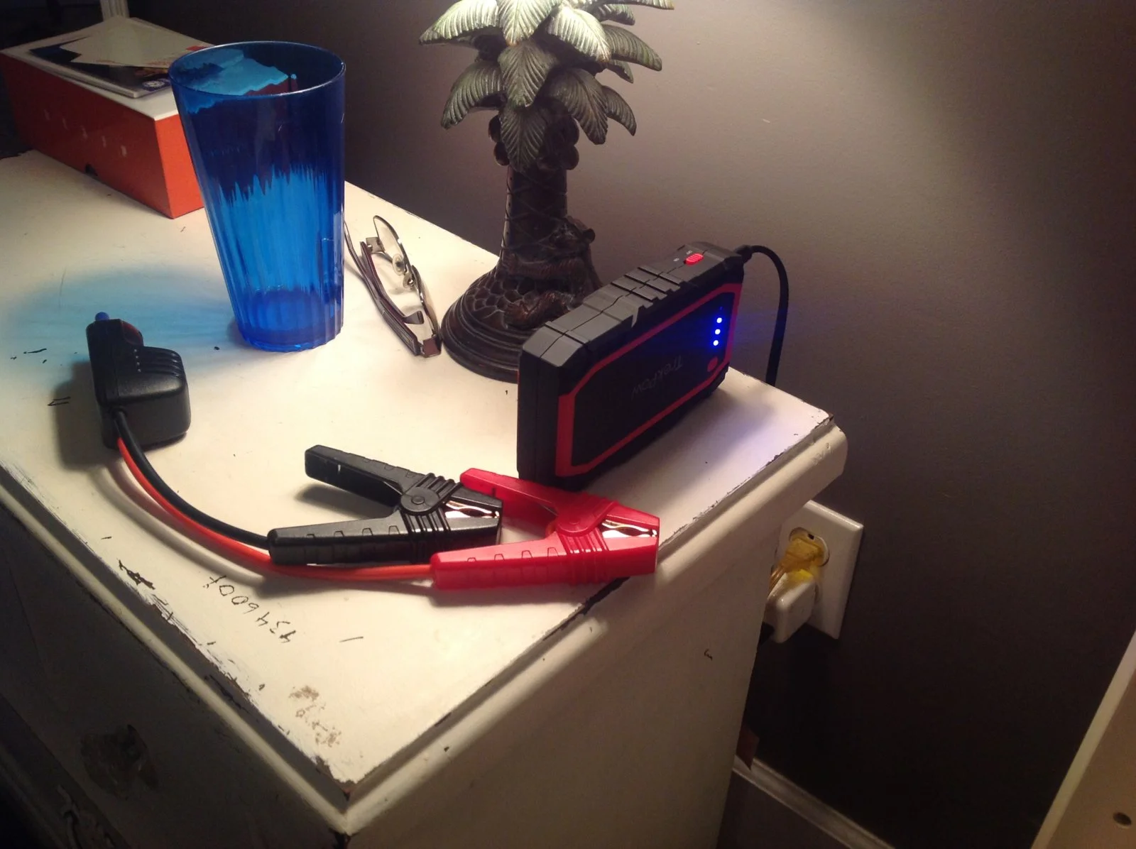

You guys were talking about the cheap jump boxes that were available now that the Chinese have found a way to use capacitive discharge circuitry to create big power out of a small box.
I had to see for myself..
I got on Amazon ( my mostest favorite place of all online resellers), and ordered the one that was being talked about as an alternative to the better unit. ( the 50.00 piece instead of the 100.00 unit.)
And since I'm such a big Amazon user,..I had amassed "bonus bucks"... The 50 dollar piece ends up costing me 30.00 bucks shipped.
It came today.....I open it....The instructions claim it'll out put 800 cranking amps..it's the size of a paperback book.
No Freakin Way.
You use a wall wart to charge this thing,...It has an internal flash lite, and is capable of charging a phone or tablet after its charged...
How can you not have one of these things in your car?
I'm almost tempted to go out and kill the Monsters Battery, just to see if the thing will work.
It should work fine but of course there are caveats. It's not just capacitive discharge but also LiPo batteries. I've built a few of these pack that are about the same size as the one you have there but with more capacity.
If you are interested at all, there are a ton of videos out there for making these packs. You can use anything from common 18650 LiPo put into packs to graphene cells that will power any decent size trolling motor for half a day.
As handy as you are, you could construct a pack similar in size with 5 times the capacity and more uses as a 'Swiss Army' power supply.
Once you get your power supplies sorted out, you can move on to solar charge and cell balance controllers! :D (this is the portion I'm playing with now)

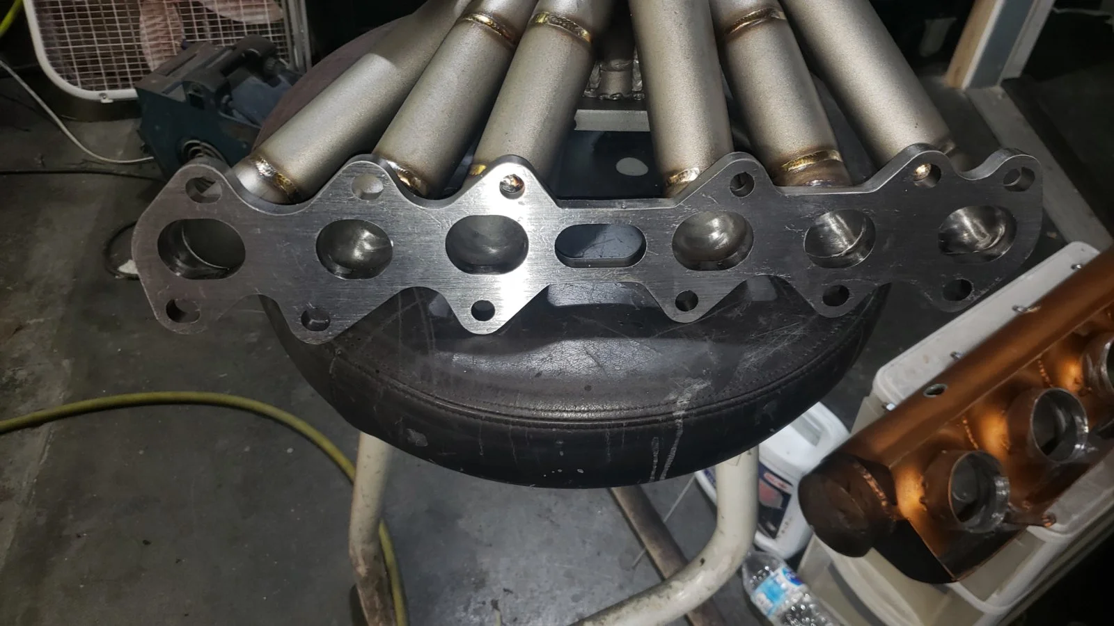

Well the exhaust header/turbo manifold came in for the 2j...
Pretty impressive...
And fully 5" shorter than the monster's long assed turbo header.. this is gonna be an amazing build.
Especially unbelieveable is the 300.00 price tag...where on earth can you get a SS, beautifully tigged exhaust header that has actually been ground smooth inside with 1/2" thick flanges for any engine that comes with gaskets and hardware for 300 dollars?
Jina... that's where.

And on the above note...
Into all lives....a little rain must fall.

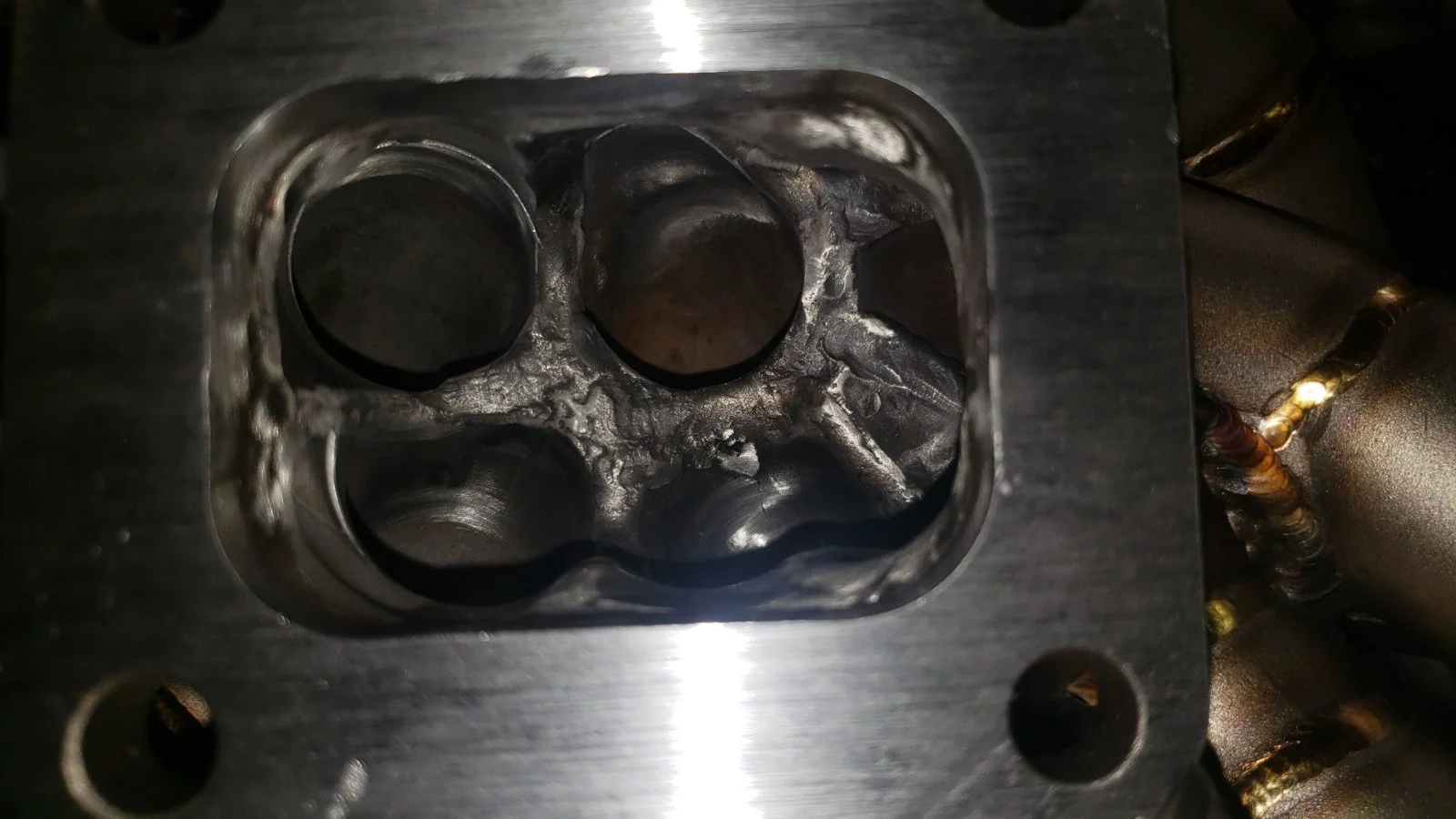

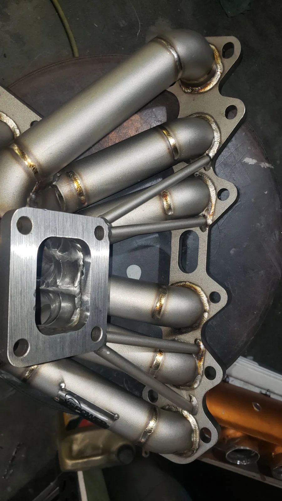

The turn radius on the two middle tubes is so tight I don’t see how I’ll ever get the bolts in to attach the thing to the head. The red flag should be waving like mad right now, cause even with the header OFF the engine, I can’t get those two bolts to go in the two holes underneath...I’m sure that once in the car, it’ll be impossible.
But....as I’ve said before...I must just love to torcher myself..I’ll wait till the engine gets here, and see if it can be done. ( another WTF,...the header shipped directly from CHINA and it’s here before the engine is that was in CA.) The ONLY WAY a fastener of any kind will work in those two holes is if I use a stud and nut..and even then, I’ll have to do some stupid sht to get them started.
The other weird thing as has been noted is the round hole, oval hole in the flange,...and the smallish ports compared to the gasket..one things for sure,..I’m not gonna even TRY porting 1/2” thick stainless steel, if the ports on the head are significantly bigger than the flange.
Fortunately...Amazon Prime...I can send this thing back if I can’t.

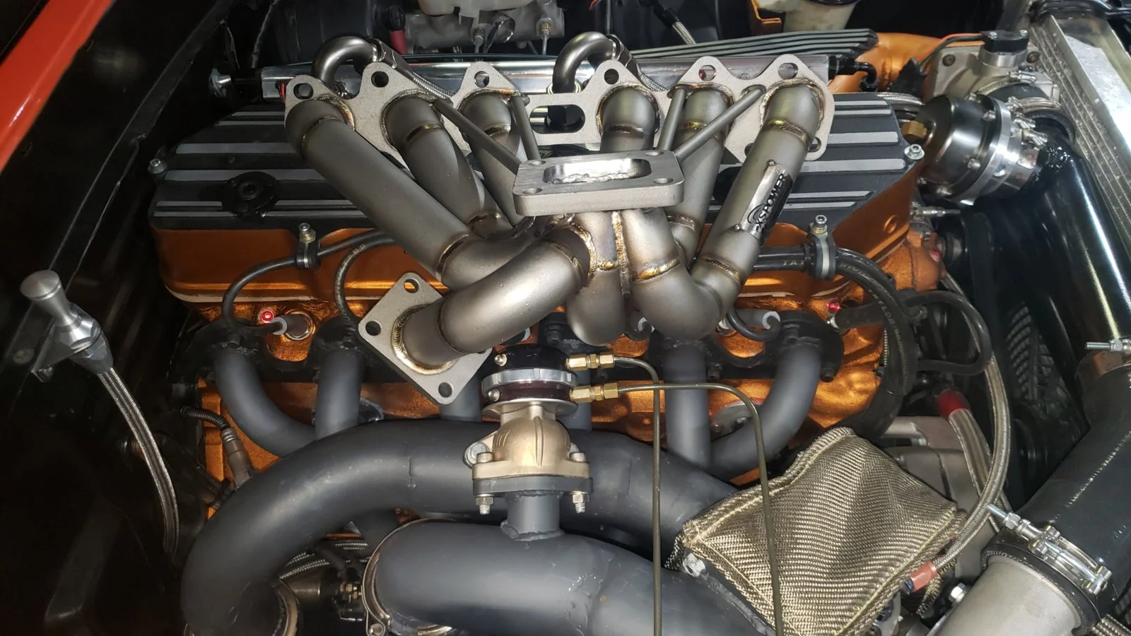

I’ve been purposely postponing this update, waiting on something to say. But as time marches on, turns out I have plenty to say.
Firstly,..the 2juliettezulu...its not gonna be as easy as it first looked to be.
All of those engines you can buy are sho-nuff 2jz's, but they are Japanese Spec, NOT US spec. And while in the long run it doesn't matter that much...there are differences....most notably the cams.
I may not be able to use the fairly affordable Supra-Spec 2jz cams, and may be forced into just having mine reground.
Secondly, this is a VVT-I engine...hydraulics move the intake cam timing with engine load. THAT is another obstacle to being able to upgrade the cams even if I can replace them w/US spec stuff. Doing away with the VVT-I Potentially trades away 60-80 ft-lbs of torque in the low,and midrange power band if I'm reading this correctly.
