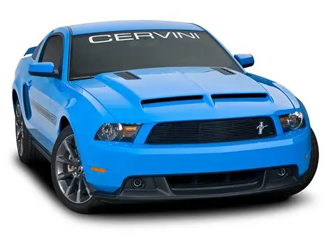

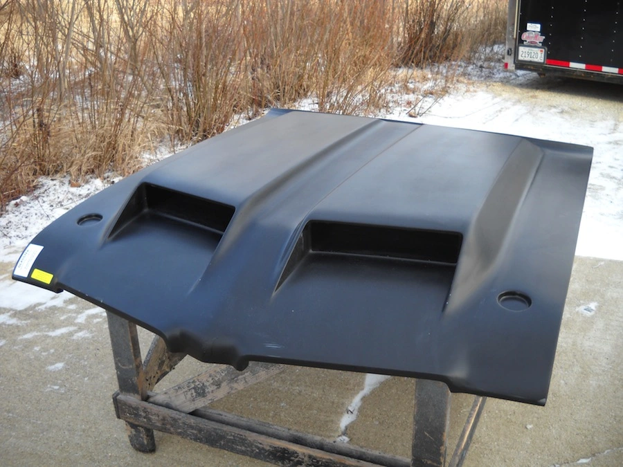

Classic auto reproductions has this 'Torino' style
and cowl
but i do want to see something you made all custom cool! The 68 shelby would be neat
but I've always imagined a cobra jet shaker fitting the Mutt2's style really nice.
2040 parts has flip nose
This!

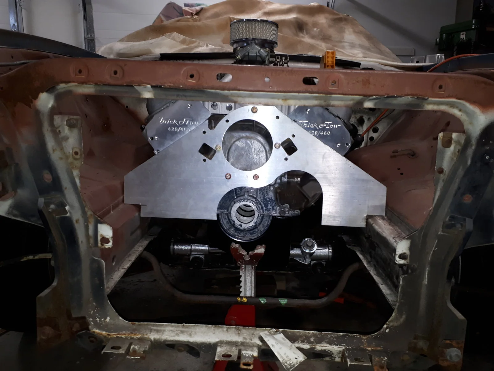

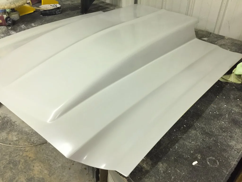

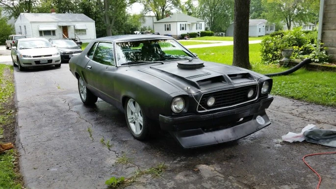

I really like the classic auto one and I would buy that but i need about 2 to 3' clearance (height) for air cleaner at the very rear of the hood. I would not use a traditional cowl induction because I don't really like the look and they are really overdone in the automotive world.. I actually would prefer no scoop but that is impossible with the logistics of engine placement in a M II. The last pic is pretty well what I was envisioning yes.

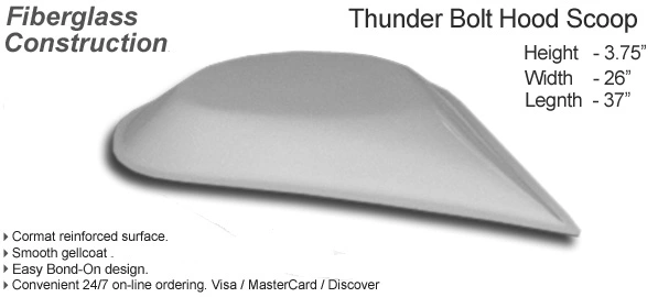

Of course we didn't mention the T bolt
but the air cleaner is so far back against the cowl , IDK

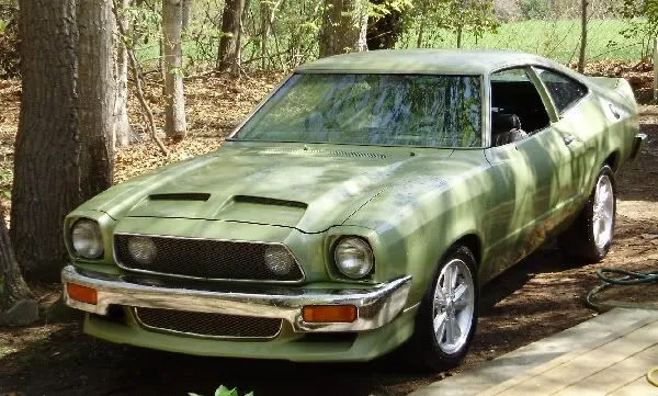

Sorry more scoop stuff, I guess I'm excited.
This front end is neat overall with relocated turn sigs, fogs, and scoopy spoiler
I like how the lines carries in to the grill header.

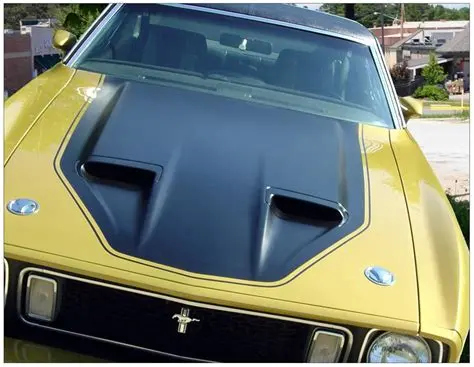

I'd guess that with the big block under the hood a shaker probably wouldn't work so well and may end up looking like that primer black coupe - I think it would probably be too much. I do like the 68 GT500 scoop idea. With the 68 scoops being farther forward on the hood it should work really well having the center "flat" section of the hood raised to accommodate the height of the big block. And, if you needed to, you could leave it open like a cowl hood, I think it would more serve as an extractor than an induction and give all of the extra incoming air a place to escape.

Yes, thats what I was thinking with the GT 500.
The problem when selecting a scoop/hood is that the engine sits so far back, the rear bowl on the Holley is about 1/2 inch from the cowl edge. This means the height of what ever you put on has to be highest at the back or high the whole length.
This is further complicated by how high the engine sits with the carb top flange about level with the hood. I have 1/4" clearance from pan to crossmember and steering rack so I have the engine as low as it will go I think.
The no brainer easy hood fix is a cowl, but I just don't care for the look.
Another thing is air flow. I can't be closer than 1" from top of carb to scoop, AND I technically need about a 3.5 to 4 " x 12 minimum air cleaner to flow the volume of air the engine needs at WOT. (the air cleaner I have on in the pics was just one I had laying around)
If I really start working on the height I guess I could modify the pan to gain another 1/4 inch, use offset rack bushings for another 1/4" and machine the carb mounting flange on the manifold for 1/8 inch but those extreme measures only drop the engine a max of 5/8 lower and doesn't move where the carb sits in relation to the cowl.

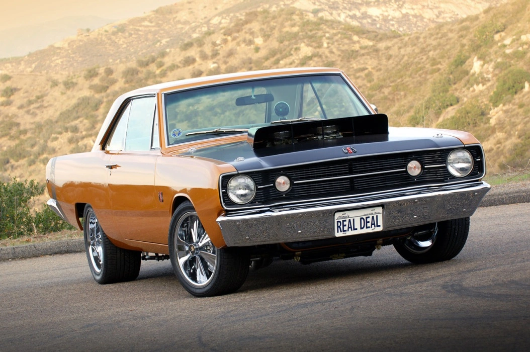

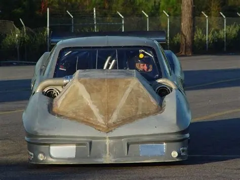

Pro mod windshield scoop
Of course ya got to do what ya got to do
Just kidding, if it was easy we would all be doing it.

It looks like raw fiberglass to me.

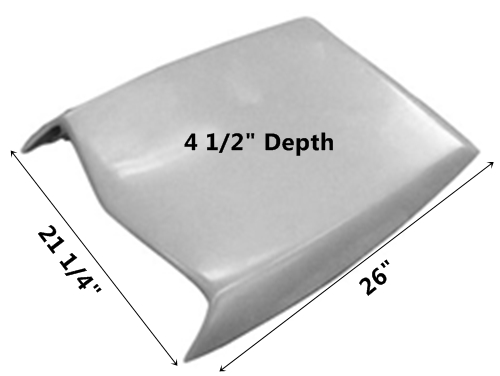

How about the Boss 429 scoop?
And as for where the fuel bowl sits in relation to the hood, do you have to clearance the hood bracing to accommodate?

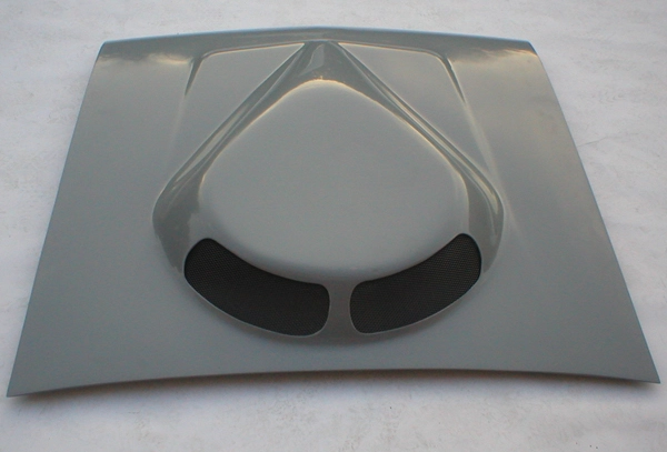

Since tall at the back is a priority and a cowl scoop aint doing it.
Its time for the Elephant in a box Hemi Hood scoop (tall at back, lots o room, slides to back edge of hood.)
Its only draw back is it is Fugly.
Ok so you already cut the fire wall out, just cut the cowl off and weld it onto hood then use the
teardrop scoop on your new longer hood, just saying...:rolleyes::D

i don't mind the boss scoop but it would have to downsized quite a bit to fit the scale of the MII I think.

As far as the Boss scoop goes, I totally agree with you under "normal" circumstances, but a 429 in the bay of a II is not exactly "normal." :O_o:
Dimension wise, it looks to give you everything that you're looking for. And, having that 429 underneath it goes a lot into the explanation for a need for it. If it was a run of the mill 302, like mine, it's definitely overkill. But I also think I understand what you're after. You're looking for something a little more subtle, something that looks like it may have been a factory option or maybe a dealer installed package, kinda like a Yenko Camaro, Nova, Chevelle, etc. At least that's what I'm taking from it. :D

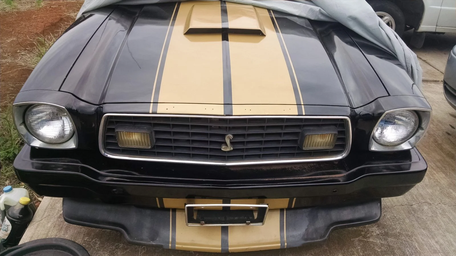

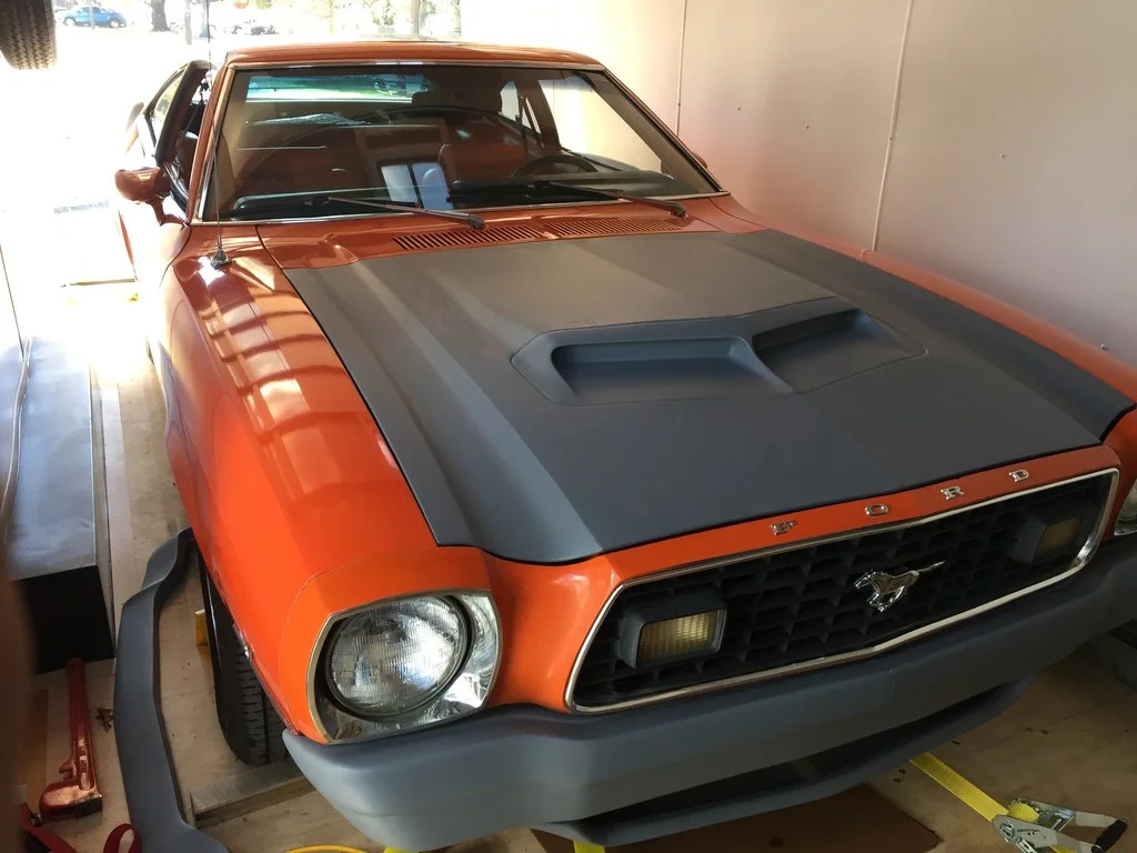

Your assessment of what i want is bang on.
This is what I am trying to achieve more or less. Ok.. the engine plate kind of detracts.. but I'm going to paint it to sort of make it not stand out as much. Also the room required for exhaust and steering made the plate necessary.
Theres lots of body mods I could do to help the mustang II aesthetics but I keep leaning towards making it appear as somewhat of a factory car, which is why I left the wheel wells etc and didn't tub it, as that would have been easier overall. Other than mildly tucked bumpers and a scoop I really keep leaning towards leaving everything stock. This is why I probably need to modify the cobra scoop to be a bit larger, use the cut down cobra jet scoop or something subtle as opposed to a giant 4" cowl or a pro stock scoop.
